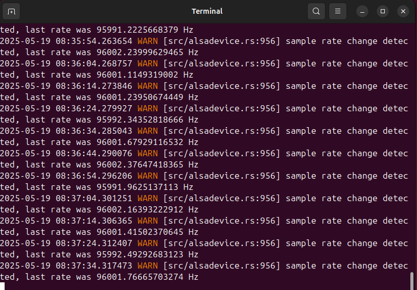

"In this case", you mean it is likely to change when you play different songs/albums? This needs to be totally clear from the start. Can the streamer be configured to output a fixed rate?In this case source file is 96kHz and streamer is running 96kHz as well. When running 44.1 i have 22 but camillaDSP is showing 44.1kHz
The Digiface can lock it's clock to an input, but if I read the manual correctly, the sample rate of that input must match what the Digiface is set to. It won't automatically switch to another rate if the streamer decides to feed it at a new rate.

I am not using any plugin. I just installed kernel 6.12 because the RME is only supportet in this kernel (as far as i know)
Because i don't have access to the driver, i only can try out, to find out what is reacting how.Then I would suggest to draw your chain and think about what part runs at what samplerate and what is the source of the clock for that samplerate. This analysis will have direct impact on your CDSP config which needs to reflect the clocking arrangement of your chain.
The chain itself is very easy:
Streamer -> Toslink Output -> RME Toslink input -> CamillaDSP -> 4 times Toslink Output.
I have tried different settings in the Streamer: fixed rate and switching rates. Both have different problems.
Fixed rate: it runs severeal hours without a problem.
Switching rate: some samplerates are working some start to make problems.
Using the samplerate, wich makes no trouble in the switching scenario, starts to make problems after some hours.
Biggest Problem: i am a total Linux newbie... so i just can try to use ChtGPT... or the help of the community... what i realy appreciate!
I have tried both... fixes rate and switching rates... both with different behavior."In this case", you mean it is likely to change when you play different songs/albums? This needs to be totally clear from the start. Can the streamer be configured to output a fixed rate?

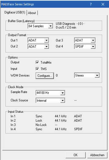

Problem is: i can not (or don't found how) change the samplerate what the rme should use internaly. Maybe it is set to 44.1kHz, because this is the only samplerete so far, without a problem.The Digiface can lock it's clock to an input, but if I read the manual correctly, the sample rate of that input must match what the Digiface is set to. It won't automatically switch to another rate if the streamer decides to feed it at a new rate.
Will try again, to connect the RME to a windows system, to check wht will happen, if i change the samplerate in the driver!

Clock Mode
Sample Rate Sets the currently used sample rate. Offers a central and comfortable way of configuring the sample rate of all WDM devices to the same value, as since Vista the audio software is no longer allowed to set the sample rate. However, an ASIO program can still set the sample rate by itself.
During record/playback the selection is greyed out, so no change is possible.
Clock Source
The unit can be configured to use its own clock (Internal = Master) or the digital input signal (Input 1-4 = Slave). If the external source isn't available (Input Status No Lock), the unit will change to the internal clock. The current clock source is displayed as Current.
Input Status
Indicates presence of a valid signal at the optical input 1-4 (Lock, No Lock) and whether the signal is synchronous (Sync). The third column shows the sample frequency detected by the hardware (coarse recognition, 32 kHz, 44.1 kHz, 48 kHz etc.). In Clock Mode the clock reference is shown. See also chapter 26.1.
To me this sounds, that the RME will lock and set the SR to the input source. In alsamixer i get the sync status on input 1, what is the input i am using.
Strange is, that the SR what is shown in alsamixer is different to the one i am getting in CamillaDSP. Maybe something whaut is related to the muxing behavior in ADAT.
