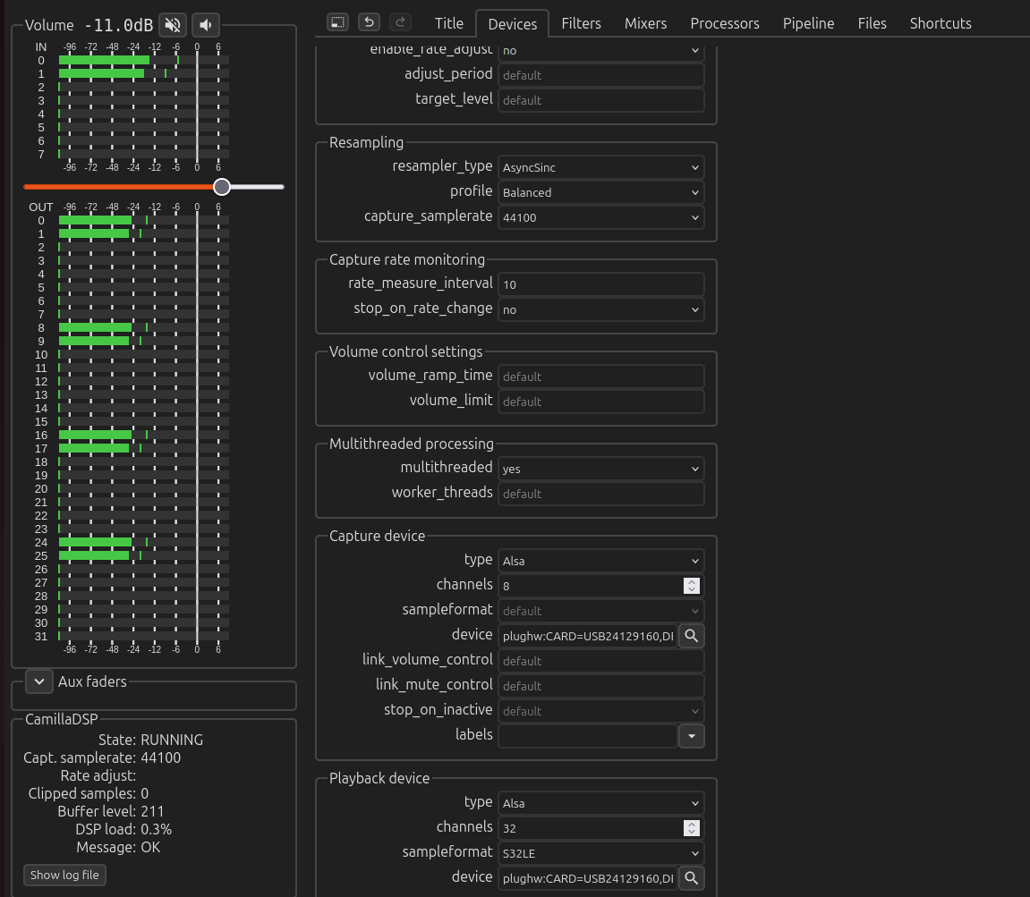

Hi
since RME Digiface USB is supported in kernal 6.12 i try to use it in camliiaDSP.
I have not tested, if i get sound, but get error messages:
- camillaDSP sample rate change detected, last rate was 60682.462252098274 Hz
And using more than 256 as buffer chunksize will also end in many error messages.
It seems, that the locking on the inputs stops working properly, because, the green LED for the input on the RME starts flashing.
I am not using loopback, i am using the SPDIF Inputs.
If i run Reaper seems to run smoothly.
I am using Ubuntu if this helps.
Thx and greetings
Christian

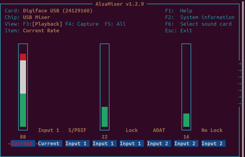

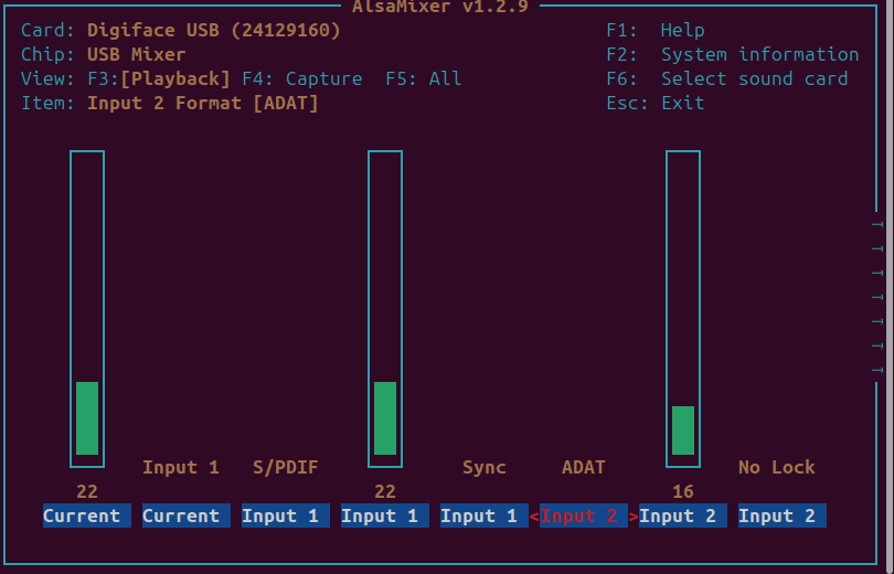

In Alsamixer i can configure the inputs as ADAT or SPDIF. Ist it maybe, that camillaDSP is using ADAT instead of SPDIF?
On ADAT there are 8 chanels muxed, what could explain the behavior.
If so: is there a chance to change that in the camillaDSP config?

You can coose between lots of Devices... it seems it was the wrong Digi... now it works
Does it work without "plughw:", with just "hw:" instead? The plug enables automatic conversions of sample format, sample rate and channels. You are maybe not be running the device at the sample rate you have selected, it accepts anything and applies whatever conversions needed to make the device happy. With plain "hw" there are no conversions.
Hi Henrik,
switching to "hw" is resulting in this:
2025-05-18 13:58:26.950185 INFO [src/bin.rs:781] CamillaDSP version 3.0.1
2025-05-18 13:58:26.950207 INFO [src/bin.rs:782] Running on linux, x86_64
2025-05-18 13:58:26.951025 WARN [src/audiodevice.rs:536] Needless 1:1 sample rate conversion active. Not needed since enable_rate_adjust=False
2025-05-18 13:58:26.953355 ERROR [src/bin.rs:293] Playback error: ALSA function 'snd_pcm_hw_params_set_channels' failed with error 'Invalid argument (22)'
2025-05-18 13:58:26.966946 ERROR [src/processing.rs:132] Message channel error: receiving on a closed channel
2025-05-18 13:58:26.967008 INFO [src/processing.rs:135] Playback thread has already stopped.
Going back to "plughw" and its playing immidiatly.
Is there any disadvantage to use "plughw" as lomg as input sr is same as output sr?
