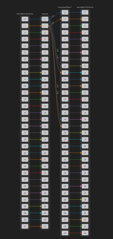

Question: the device can handle lots of in's and out's but to see al of the unused channels in the plot, dis not very comfortable.
Is there a way to show only channels used in the mixer?

There is no way at the moment but I agree that doesn't look very good. I'll think about if something could be done.Is there a way to show only channels used in the mixer?
