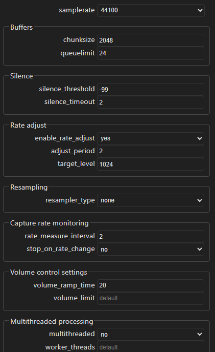

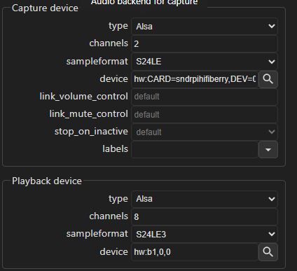

I experience the same drift of lipsync after some minutes. I also use Kodi. In V2 it was stable. In V3 it drifts away the more the longer it runs. Restarting the cdsp service on raspi brings synchronisation back until it again drifts away.
I've got a fixed sample rate in Kodi. My Hat is hifiberry digi IO. No filtering involved.
CDs setting like here:
@taotao: Then please post the whole config as you are reporting some important issue.
I do not know your actual config, but from the two incomplete image fragments : no resampler when very likely two async soundcards? Target level at half of chunksize? E.g. it's possible the latency increase is somehow due to undetected xruns.

I'll send the trace in some minutes (different PC neccessary for uploading log)
@taotao that config can not give stable latency in any version. The capture and playback devices have independent clocks that are not adjustable, and you don't use the asynchronous resampler. Try enabling the resampler, that really should help. You can also set queue_limit to null, the default of 4 should be fine.
