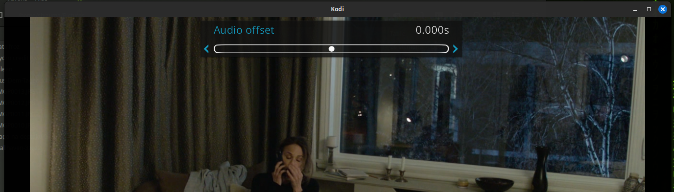

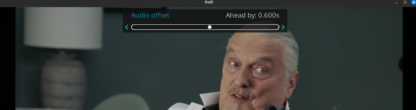

I used to set a 250 ms delay to the video with KODI in 3b2 to keep the audio and video in sync. Youtube videos in chromium based browsers were not perfectly in sync, but it was tolerable; movies and tv series watched in chromium based browsers were in sync.
Now with v 3.0, I need to set the video delay in Kodi to 800 ms. Youtube videos are all out of sync, badly. Same with movies and tv series. Sometimes, they might start to play in sync, but latency builds up fast and videos are unwatchable. It's perfectly repeatable with all linux kernel versions I tested. Killing CDSP 3.0 and starting 3b2 restores sync.
Strangely, I have a CDSP config where there is, or should be no processing and it's affected as well, to a lesser degree. It should be transparent, shouldn't it? There it is

Looks like you've spotted the problem immediately. I blindly copied the setting from a sample config file or several. It worked util v 3.0.Since your adjust_period is 30 seconds, one minute of capture contains only 2 rate-adjust action. Any reason why this long adjustment time? If you need low latency, small chunksize and frequent rate adjustments (like a few secs) are better.
Setting the adjust period to 5 eliminated the problem. I tested for 15 minutes and I'm getting identical latency as 3b2 or 2.3.
No idea. No latency when CDSP is not running though.Nevertheless - you have pipewire in the chain. Do you know what causes the large latency, CDSP or PW?
250 would be more what I've been experimenting in Kodi. IIRC it's not noticeable in youtube videos.I would guess CDSP does not cause more than some 200ms of latency (2048 frames of capture chunksize + some processing time + 6143 frames of the target level for 48kHz samplerate)
Started withThe debug-level log does not show any issue, trace level (-vv) would tell more. I would suggest to lower the adjust_period to e.g. 5 seconds and log at trace level so that every write/delay/avail operation is listed. The moment of the very first write defines the overall latency of CDSP, because then the playback stream is clocked by the output device (pipewire -> output soundcard). The trace log will show how precisely the timing works in your case. But it will definitely not be a difference of hundreds of ms as you are complaining, absolutely not.

Not measuring it per se, adjusting it in Kodi with the audio/video sync slider until they are in sync.How did you measure the overall latency?
Once it's proven strable, I fix it in the config file so it's applied automatically:

UPDATE
Talked too soon. After 30 minutes testing, latency has increased and keeps increasing while the video is still playing. Currently at 600ms. Out of sync again.
Stopped the video and started another one and still out of sync. It builds slowly up to a maximum and stays there around 800 ms.
