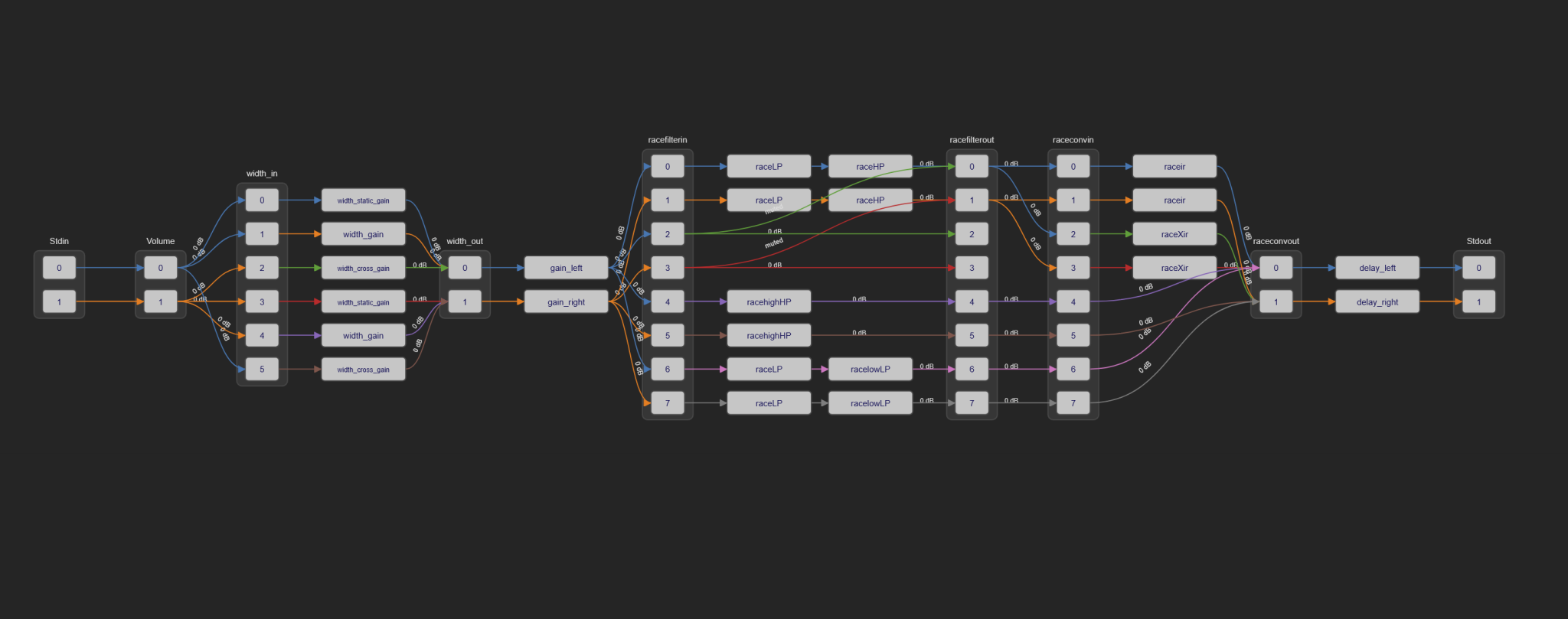

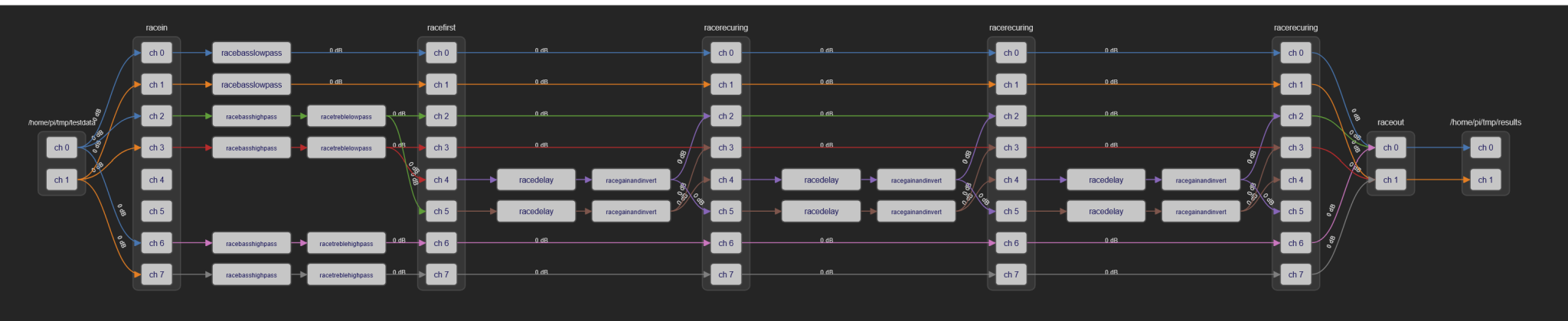

A post on Audio Science Review regarding speaker cross talk cancellation piqued my interest on this subject. After a bit of research I decided to try it out on my main 2 speaker stereo system which uses camilladsp. The implementation I did uses camilladsp for the processing and is based on Recursive Ambiophonic Crosstalk Elimination (RACE) as per the AES paper 360° Localization via 4.x RACE Processing by Ralph Glasgal.
When setup properly, I find the processing to significantly improve sound stage width and depth as well as improved clarity. There are however serious limitations the main one being that it will only work for a single listening position. Also, how well the processing works is dependent on the recording techniques used. Not necessarily a limitation but the speaker placement should be at a narrow angle of 20 to 30 deg instead of the conventional 60 deg. Left and right speakers must be positioned very carefully with equal distance to the listener within of about 1 cm for best results.
In my case, for serious listening I am always alone and in the same listening position so the processing is always effective. For the odd times when listening with family and friend or when I am not in my listening chair, I simply turn off the processing. For some recordings the sound stage width is too large, in these cases I pan the L and R to the center position to reduce the width, this seems to work OK.
The processing is recursive, here is a pipeline with 3 stages of cancellation.
For the processing to be effective about 20 stages are needed. Also in order to have enough resolution in the time delay, a sample rate of 96k or higher should be used.
Time delay and attenuation can be adjusted on the fly using custom shortcuts. If the left and right speakers are not at the same distance to the listener, this must be corrected with speaker delays values which are also available via custom shortcuts. There are shortcuts to mute the left or right inputs. This can be used when adjusting the delay and gain values so that when the right input signal is muted the left will appears as far left as possible and vice versa for the right. There is the option of changing the passband frequencies for the processing via sliders as well as bypassing the passband filters so that the processing is done full bandwidth.
If you are interested in trying this out see the attached files with the elements that will need to be imported or pasted in your config:
Camilladsp configuration file which has the required filters, mixers and pipeline elements for RACE, not sure how to attach a yml file so this is saved as a text file.
Camillagui config custom shortcuts for the above (V3 is required)
Please do initial testing with amp turn down just in case. The processing may add up to about 3 to 5 dB to the level at times so ensure to allow for this by setting camilladsp volume accordingly.
Once the optimum delay and attenuation values are found, the above cumbersome pipeline can be replaced via convolution. I will do a separate post for the implementation via convolution.

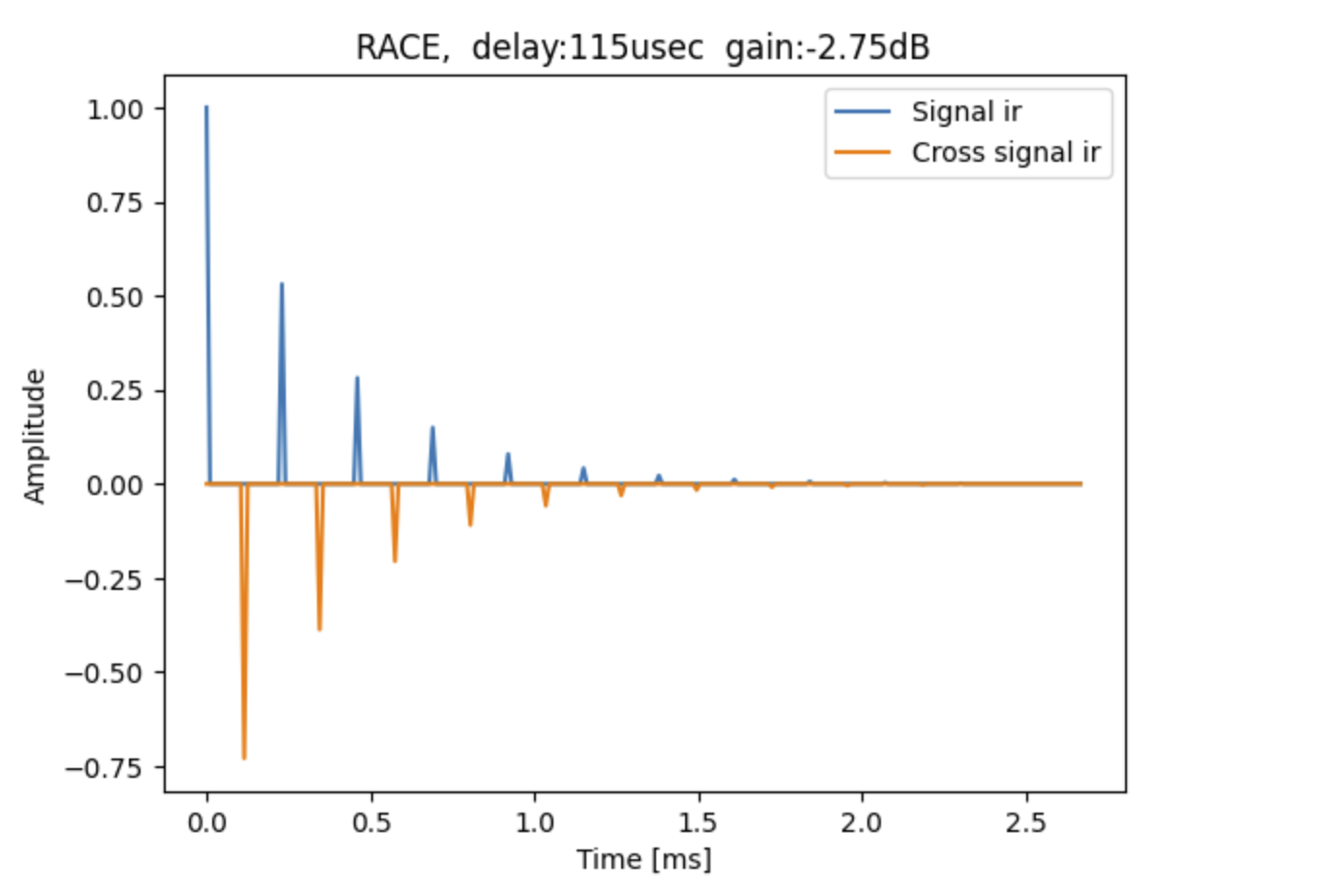

This is how I implemented RACE using FIR filters in camilladsp.
This is a plot of the two filters used for a delay of 115 usec and gain of -2.75 dB, both are applied to each channel input signal. The blue filter output is sent to that channel output while the orange filter is sent to the cross channel output. For example if we are processing the left input channel, the signal of the left input channel is convolved with the blue impulse response and sent to the left speaker while the signal of the left input channel is convolved with the orange impulse response and sent to the right speaker.
These filters generate the recursive cancellation signals that alternate between left and right speakers for the specified time interval and decrease in amplitude.
This is an image of the pipeline
The attached python program is what I use to generate the filters which will need to be saved to your camilladsp coefficient directory. My programming skills are limited, this works for me in linux but not sure for other platforms. Not sure how to attach a .py file so it is saved as a text file.
The attached yml (saved as a text file) file contains the filters, mixers and pipeline to be pasted into your config file. You should be able to change it back to a yml file and import the relevant sections via the camilla gui.
You will need to modify the raceir and raceXir filters in the config to point to the correct coefficients files that you generated with the above python program. Channel 0 of the wave file race_delayxxxattenuationxxfxxxxx.wav is for raceir and channel 1 is for raceXir.
I use the same gui shortcuts that I use for the parametric version but note that the gain and delay will be grayed out as these parameters are not adjustable when using the FIR filters. The section to be added in the Camilla gui config is attached.
