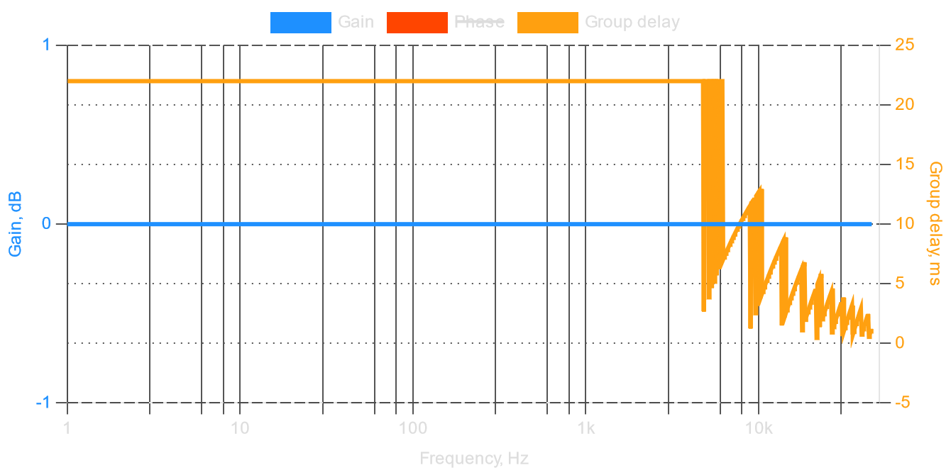

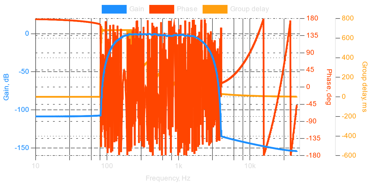

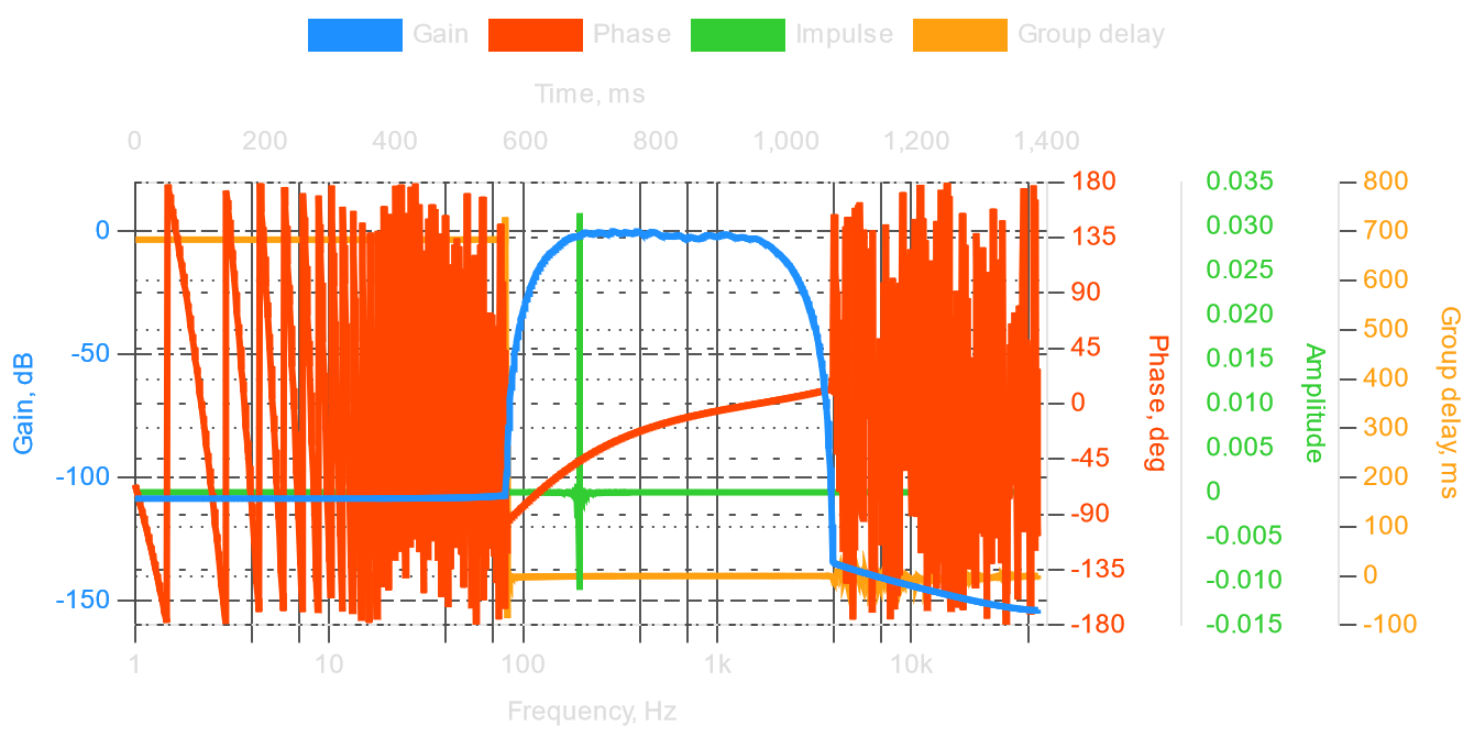

Using the plotting function for a 22ms delay filter looks strange to me above 3k.
graphing of FIR filter in the filter tab looks good
but the same filter graphed from the pipeline tab gives a strange phase, maybe phase adjustment based on FIR peak location is not applied ?
The FIR filter is type raw float64bit.

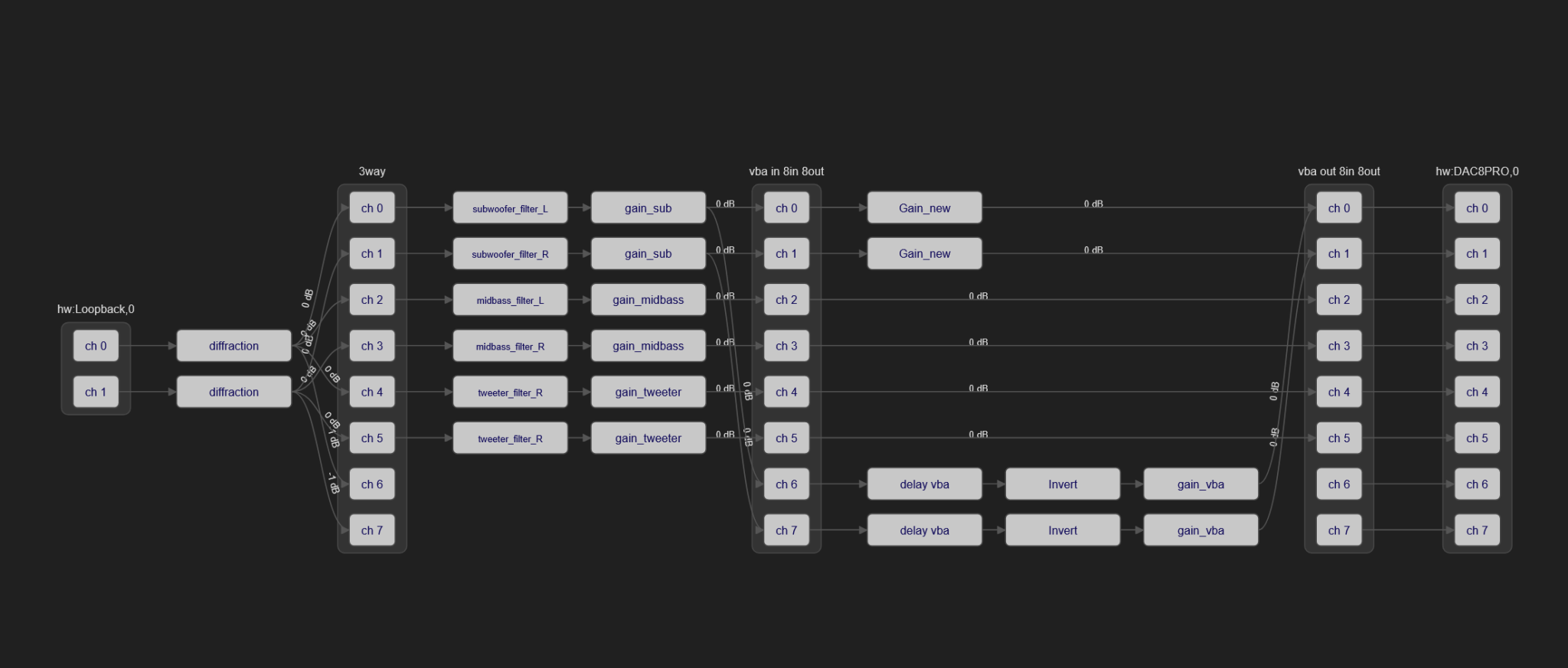

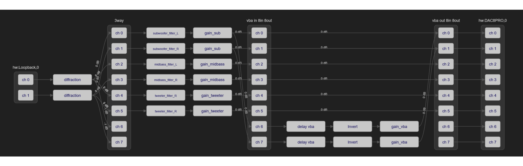

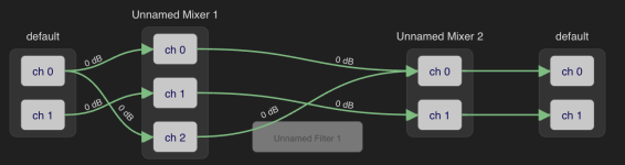

I am having problems with this config
changes to gain_vba dont seem to have any effects. I have muted ch 0to5 of vba in 8in8out and set vba_gain to -80 but still getting audio at the DAC ch 0 and 1.
I have attached the config file. Not sure how to attach yml file so used a txt extension instead.
Latest alpha versions are installed.
The group delay is calculated from the phase curve, and this makes trouble with large delays since then the phase wraps around very quickly at high frequencies. When it wraps around too quickly the phase unwrap algorithm starts missing some cycles. There is no perfect solution, the only thing to do is to increase the number of points used to calculate the curve. That pushes the problem to higher frequencies/larger delays. But it also makes the plotting slower.Using the plotting function for a 22ms delay filter looks strange to me above 3k.
Yes that is exactly what happens. The pipeline plot uses the "true" phase for every filter when calculating the combined result. That makes the phase and group delay curves for a pipeline step that contains a FIR filter quite useless unfortunately. The individual plot can be a bit smarter since it's only one filter type involved. I'll revisit the pipeline step plot at some point, but not sure how much better it can get (with reasonable effort).but the same filter graphed from the pipeline tab gives a strange phase, maybe phase adjustment based on FIR peak location is not applied ?

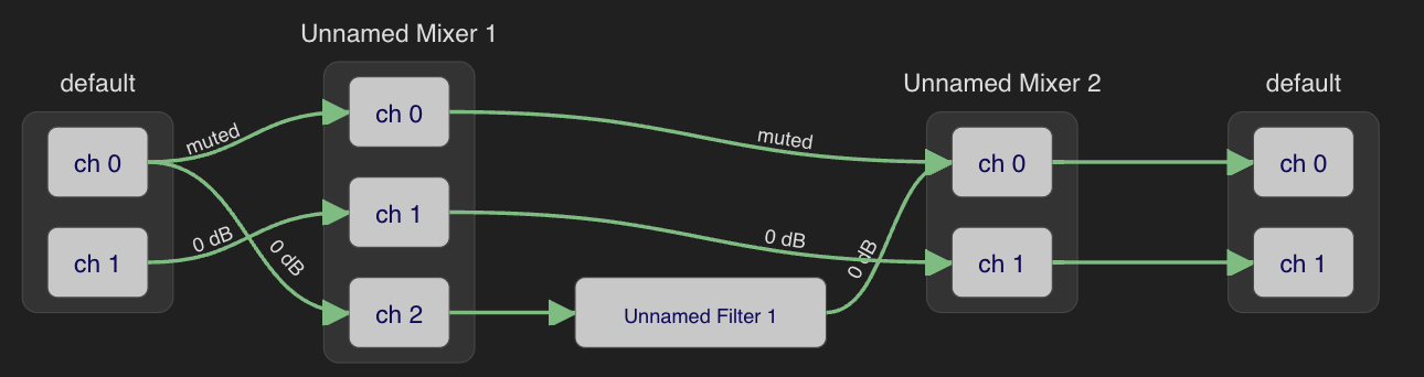

That could be a problem with some mute setting not being respected. Can you try inserting gain filters on channels 0&1 in between the vba mixers? Do you still get sound on channels 0 and 1 if both the new gain filters and vba_gain are set to something very low?I am having problems with this config
Thanks for the response on the graphs, I understand now.
Is this what what you wanted me to try ? I set the gain_new at -99 db.
I also set the inverting filter for gain of -80, still sound going to the DAC.
I muted ch 2 to ch7 with the last config ( with gain_new added), with this config I get no sound to the DAC. I get sound if I then change the new_gain setting to 0dB.
Ok ch 0 to 5 muted of vba in mixer, gain_new set to -99dB, gain_vba set to -80, invert filter with -80 dB gain, sound to DAC and ch 0,1 level meters responding
Ok! I'll look into adding some way for the pipeline overview graph to show when things are bypassed. That would likely have made this much easier to figure out.
That will be part of the config import feature that will come in a new gui version after 2.0. There is a fair bit of work left on that, I think it would delay the release too much to include it now.Please also the filter 1.0 -> 2.0 conversion...
