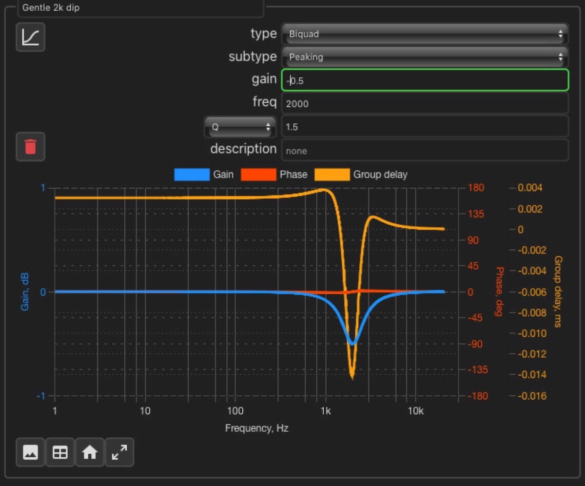

Re: auto scaled...
My observations...
Re: auto scaled...
My observations...
- the FR scale starts at 1Hz - seldom one need to bother about this - makes the less focus what matters (20-20k?), 1-20Hz takes 33% of view...
- GD is way to zoomed in - I think the least we hear is about 0,1ms? But it is good that 0 is offset to level as otherwise it gets cluttered.
- Perhaps a "rule" would be try to fill, for all three types, the space vertically with say about 33% and let scale follow that graphical utilisation of space - in this case below it would mean that DG shrinks and phase expands considerable but level expands just some.
- Perhaps the standard horizontal range could be 15-25k in order to look a bit beyond the standard 20-20k?

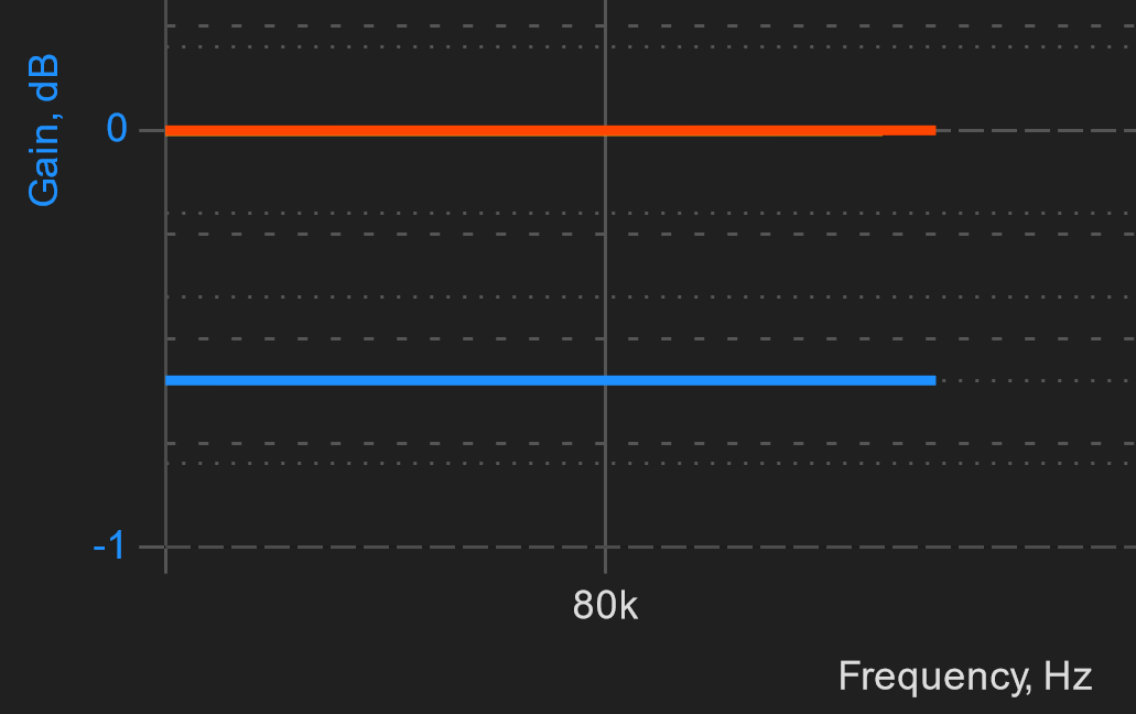

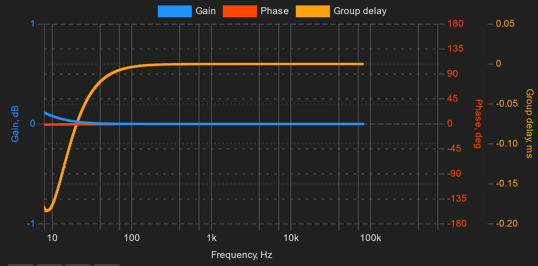

If you drag the frequency bar at the bottom it seem to go to approx 50kHz in V1. Not sure if the actual calculation does? But yeah, nice if one could see full bandwitch for 48kHz capture by default.Perhaps the standard horizontal range could be 15-25k in order to look a bit beyond the standard 20-20k?
EDIT: Actually one can pinch the freq bar and zoom in to above 80kHz

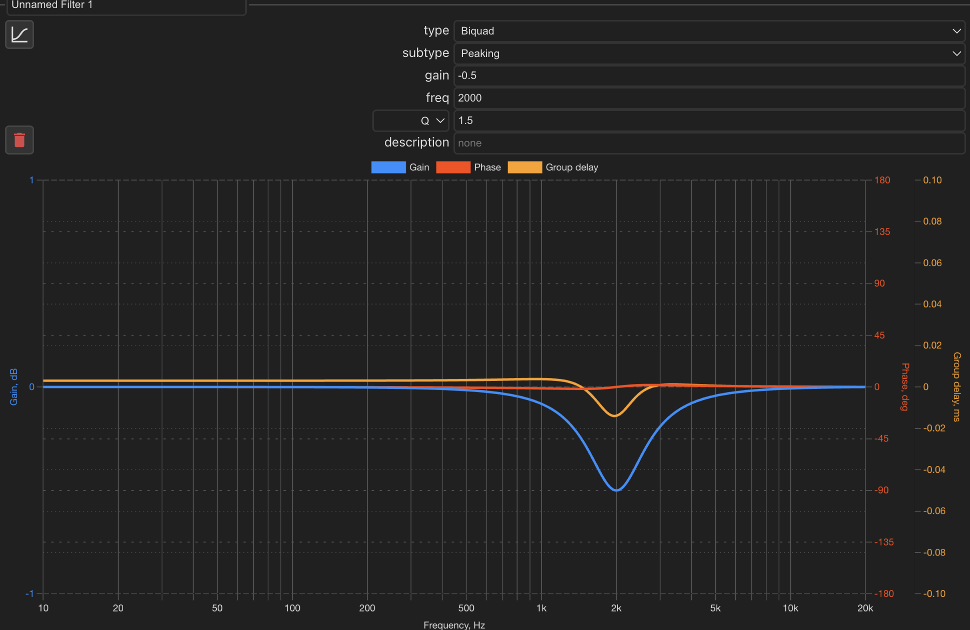

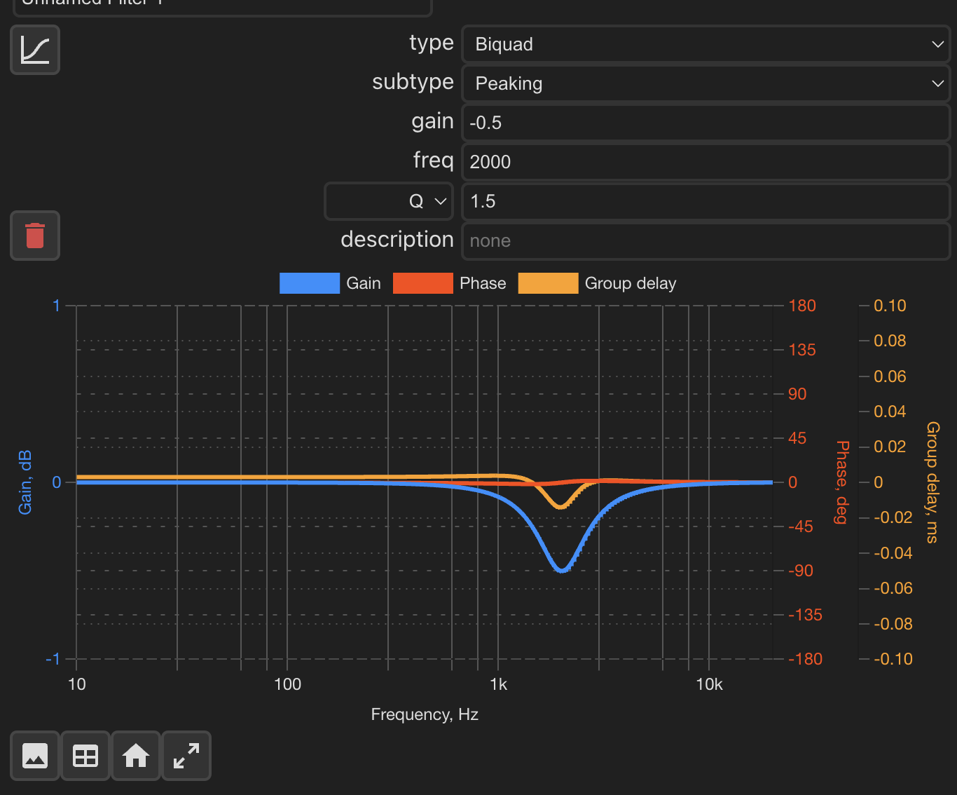

I tweaked the scale settings a bit so the group delay doesn't zoom to less than +- 0.1 ms, and set the default frequency scale to 10-20k. Letting it start at 20 Hz makes the tick marks uglier (and 15 is worse) and it's similar at the upper limit. 25 or 30 kHz doesn't turn out great. It's easy to get any given range look good for a static plot, but here things are dynamic. The logic must create a scale with ticks that work well at every possible zoom level.
Same filter as @TNT posted above, with the new defaults, normal size:
expanded:
expanded:
