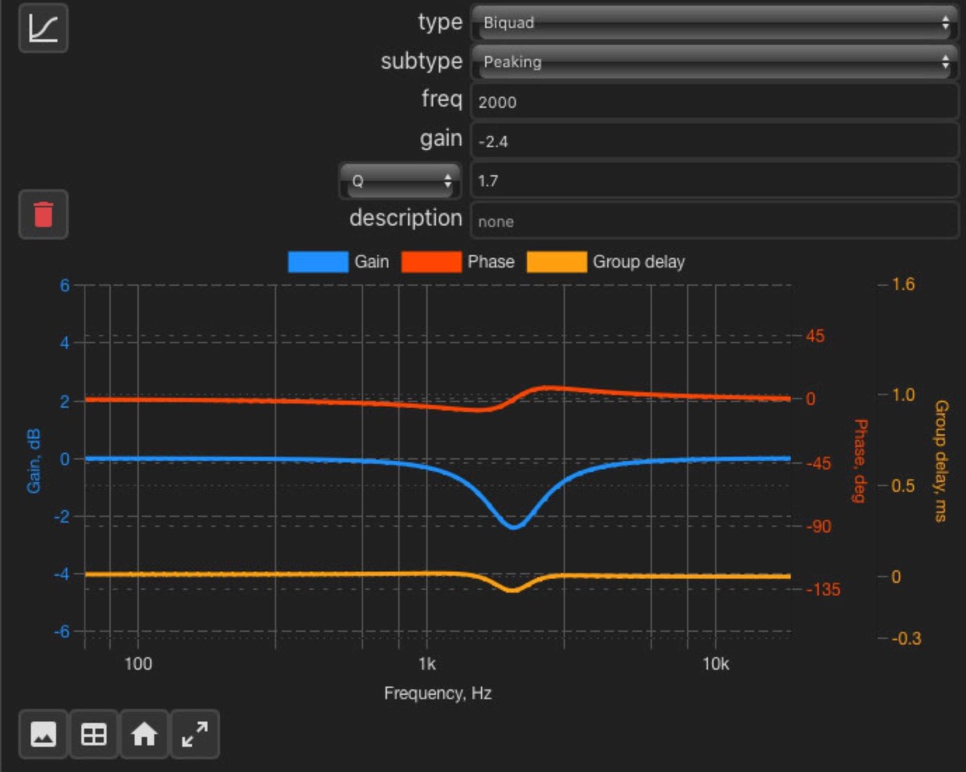

It's pretty tricky to do autoscaling that works for everything. Can you show an example of something that didn't turn out well?Would it be possible to have a bit more "hearing" oriented setting of the scales / levels / positions / zoom in the Biquad graph?
