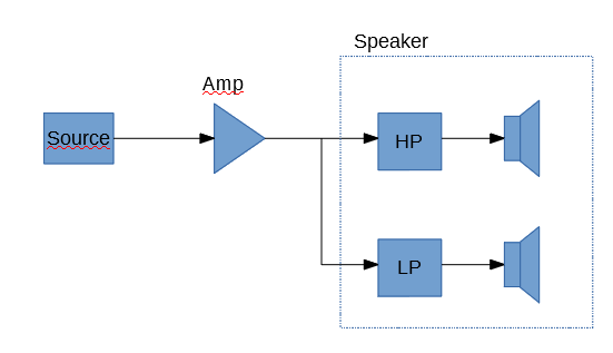

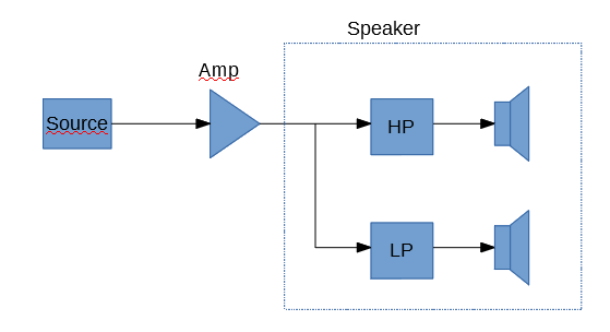

Normal speakers have passive crossovers (highpass and lowpass for tweeter and woofer), and a single terminal to hook them up to an amplifier. Something like this:
The source can be anything, but let's say it's a computer running some music player app.
What Neigh showed is just a variation of the first one. Still a speaker with passive crossovers, but with terminals for bi-wiring. Like this:
There is still a passive crossover inside that you can't bypass (without opening and modifying).

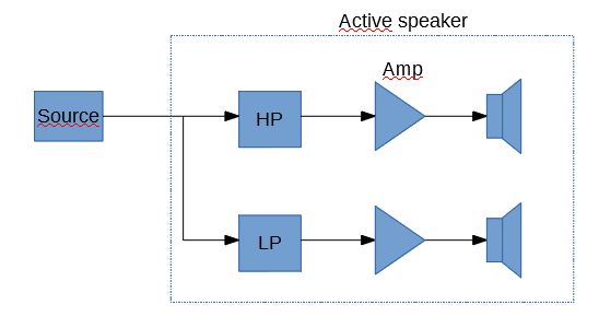

Then there are speakers with active crossovers. They contain an analog or digital crossover, followed by one amplifier per driver. Like this:
Each speaker still needs just a single signal as input.

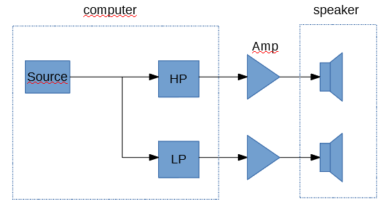

And finally we have a system where the crossover is done in the source (computer):
It's the same as the previous one, I just moved the frames. Now the "source" is the music player app, and the highpass and lowpass crossover filters are done in software in the computer. This creates two signals per speaker, so if we want stereo, we need a soundcard/dac with at least four output channels.
The speaker has no filters at all, and is most likely DIY. It could also be a modified passive speaker, and then the models with bi-wiring terminals are quite handy.

Yes, everything will sound digitized, like a cubist painting. All the waveforms will be like staircases instead of as nature intended. This kind of setup sounds best when playing techno and synthesized music, and who can stand to listen to that crap? Computers are expensive and bulky, so another brilliant point there.Does all the signal sampling sound digital? I mean, is such a setup designed for music with vocals and actual musical instruments?
It seems like a poor use of a whole PC to just act as a xover.

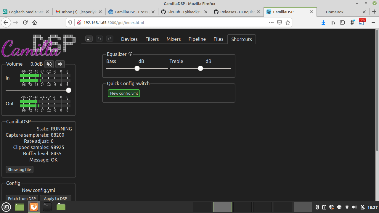

Hello.
I'am testing the newest camillagui-backend v1.0.0-rc6
Using pycamilladsp-plot-1.0.1, camilladsp-1.0.1
I can't mouse-move the Bass/Treble sliders, the volume slider is working.
What can cause this guy's ?

Sry... i got the config wrong, therefore it would not work with Bass/Treble control.
Working fine!

It's not a whole PC. The crossover tasks typically consume a small fraction of the processing power of any machine made in the last 10 years. It can easily run on the PC that anyway runs the music player app.It seems like a poor use of a whole PC to just act as a xover.
