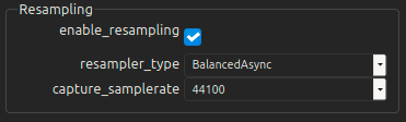

Well i would like the following :
squeezelite (different samplerates) ---->
Cdsp (stdin) resample all to 48000 --->
Cdsp working with only 48000 fir's etc. --->
Soundcard/usbdac receiving 48000 only.
So i don't want samplerate switching on this configuration (only on incoming signal and done by Cdsp)
This is to avoid that squeezelite would have to convert all samplerates to 48000, as i believe that you're resampler is better.
Reason is that i would like all fir's at 48000 only duo to my umik1 mic. is native 48000
Hope it's clear now?
Maybe it's allready possible?
Jesper.

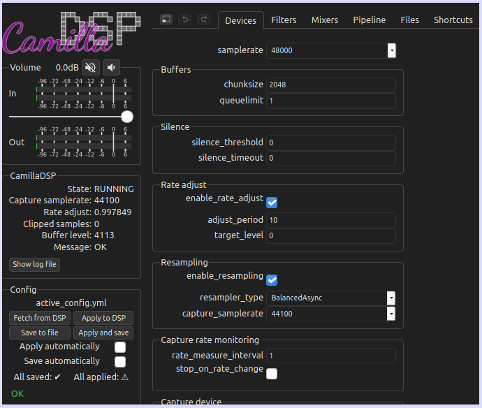

squeezelite (different samplerates) ----> Cdsp (stdin) resample all to 48000 --->
Cdsp working with only 48000 fir's etc. ---> soundcard/usbdac receiving 48000 only.
[stdin] in my setup is the CamillaDSP Capture samplerate right ?
Samplerate (top of picture/cdsp gui) is the samplerate the capture samplerate is converted to right ?
And the Resampling box, is where you choose what the fixed-capture samplerate is, right ?

@lykkedk Capture samplerate is the rate that the capture device runs at. For stdin that is the rate of the incoming data stream. The normal samplerate is the rate that the pipeline with all filters, and the playback device run at.
  • If you have a config with resampling disabled, then the two must be equal. If you override the samplerate (with the CDSP plugin for example) they will still be equal, so the override changes them both.
  • If you have a config with resampling enable, then they are allowed to be different. Overriding then only changes the capture samplerate. The filters, and the playback device stay at the samplerate from the config file.
Did this help?
