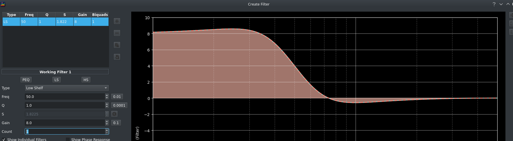

Filter 1: ON LSC Fc 50 Hz Gain 8 dB Q 1.0
S=1.8225 for that filter
(conversion done using Releases * 3ll3d00d/beqdesigner * GitHub)
Thank you 3ll3d00d for the tip, I did not know the software. I will try to learn it 🙂.

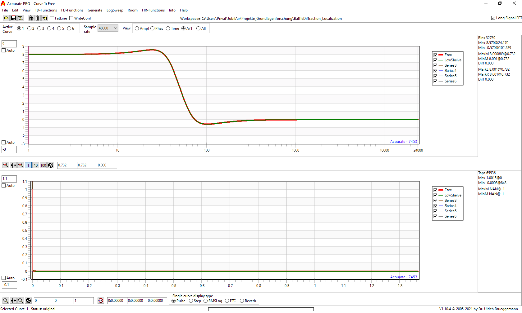

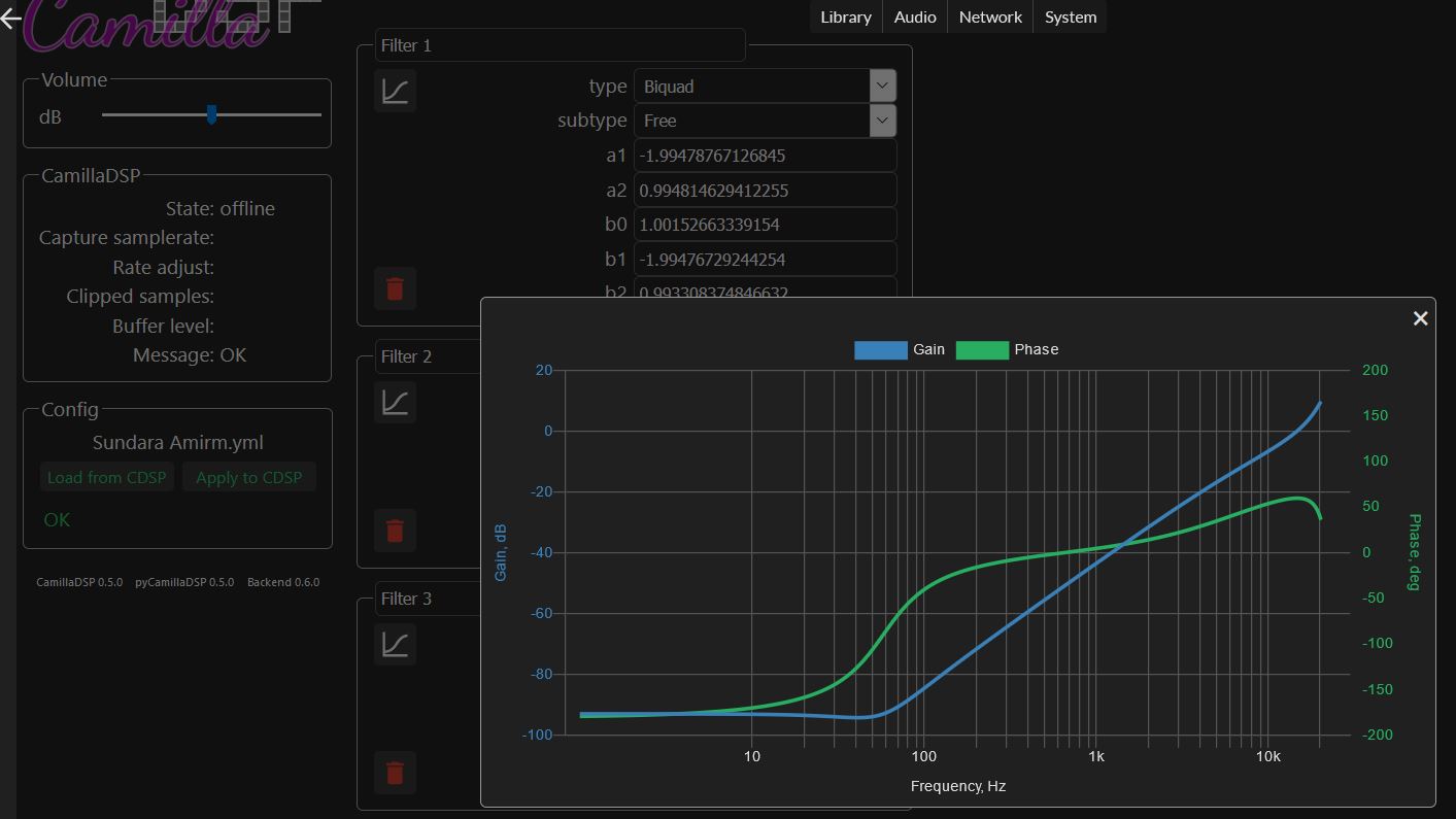

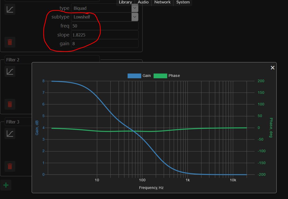

I am using CamillaDSP on moodeaudio player. a0 is equal to 1 also for my filter. However I have the wrong result when I use free (picture "free") and also when I use slope (picture "slope"). The filter should be as the one showed by 3ll3d00d in the previous post.

The filter is correct! The strange plot result is because of an bug in the plotter. There was a typo in the function plots the Free filters, that made it produce rubbish plots.
This has been fixed, but apparently the moOde version you are running still has it. Is it the latest release?

I tried with LS with slope 1.8225, but it is does not looks correct in CamillaDSP plot (picutre attached). However if I use Peace, 1.8 does not looks correct neither. In peace it is looks like something around 21. However in CamillaDSP the max value is 12 but in "BEQ DEsigner" the max value is 10.1481 with a gain of 8 but it can be even more than 12 with a lower gain.
Any idea. Is there a bug in LS plot as well?
Thank you so much
shelf filters overshoot as Q goes up so I set the limit in beqd to Q=20 (though even that is way too high to be useful). Q depends on s and filter gain hence why you see lower gain filters can retain a reasonable shape at higher S values. It means that if that specific slope is what you really need to achieve then using multiple shelf filters, each with a lower gain, can work.

In CamillaDSP the High&Lowshelves are defined by a slope, in dB/octave. This is only an approximation, and over 12 dB/octave it doesn't work well. That's why there is a limit of 12 db/octave. There have been numerous requests for defining shelves with Q instead (and Peaking filters with bandwidth instead of Q) so I will add it at some point. Maybe in the next version.
BTW, the slope of CamillaDSP is not the same as S. If I remember correctly, S=1.0 means slope=12dB/octave.
