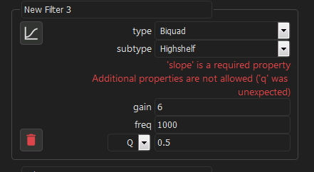

Did you perhaps miss to update pycamilladsp-plot?H Hendrik,
according title of this post; see attachement.
I'm running:
CamillaDSP 0.5.2
pyCamillaDSP 0.5.0
Backend 0.7.1
Thanks, working now.
I updated pycamilladsp-plot to 0.5.3 under user Root, should have been user pi.

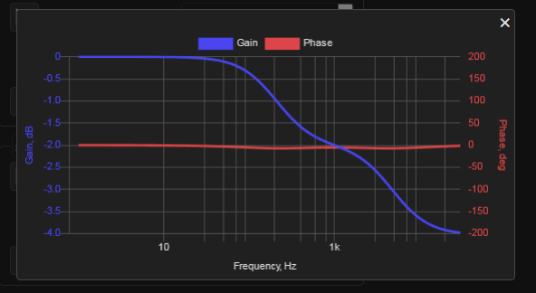

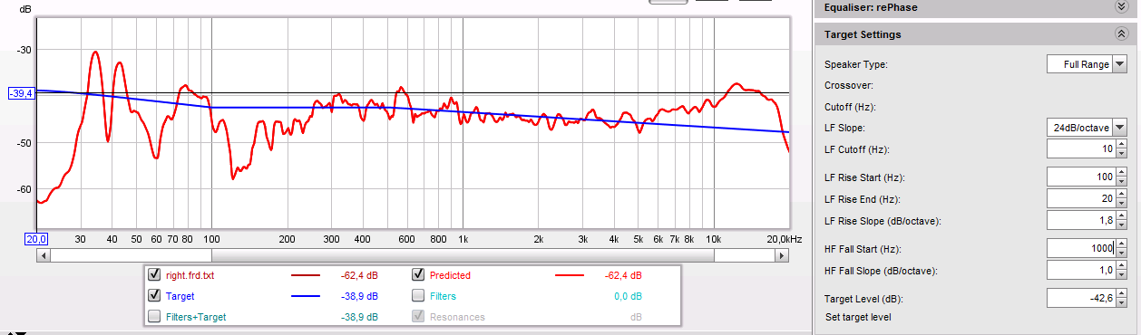

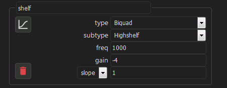

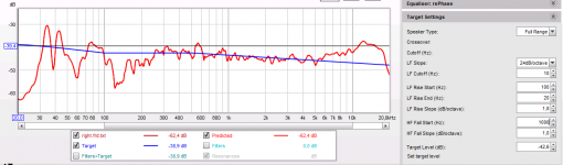

Henrik,
Is it possibble, to build a shelving filter in camilladsp according attached REW screenshot (the falling part starting at 1kHz)?
The plot looks rather strange (I didn't measure yet); the slope starts quite early, but not at 1 kHz.
Henrik,
The frequency setting of a shelving filter means the middle of the slope, not where it starts or stops. To make something similar to that curve, try for example frequency = 4000, slope = 1.0, gain = -4.0. You will have to play around a bit until you find a good match. Also note that at such low slopes, the sloping part gets a bit wiggly.Is it possibble, to build a shelving filter in camilladsp according attached REW screenshot (the falling part starting at 1kHz)?
