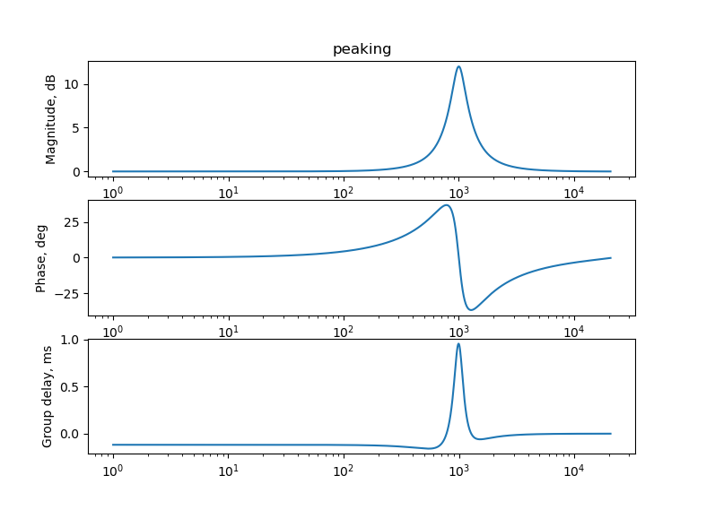

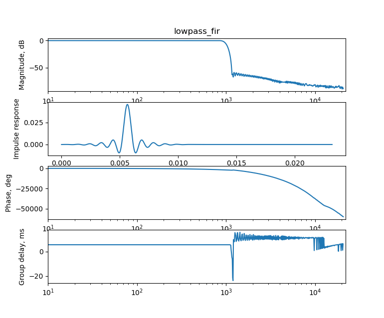

And look, Henrik, group delay graphs are important;-)
Like this?
Also works for fir filters, but the phase unwrapping is really tricky and will probably never be perfect:
This won't make it into the next gui release. That one is nearly done and I don't want to delay it. But the next one will have it.
The command line plotting tool has it if you use this branch: GitHub - HEnquist/pycamilladsp-plot at groupdelay
