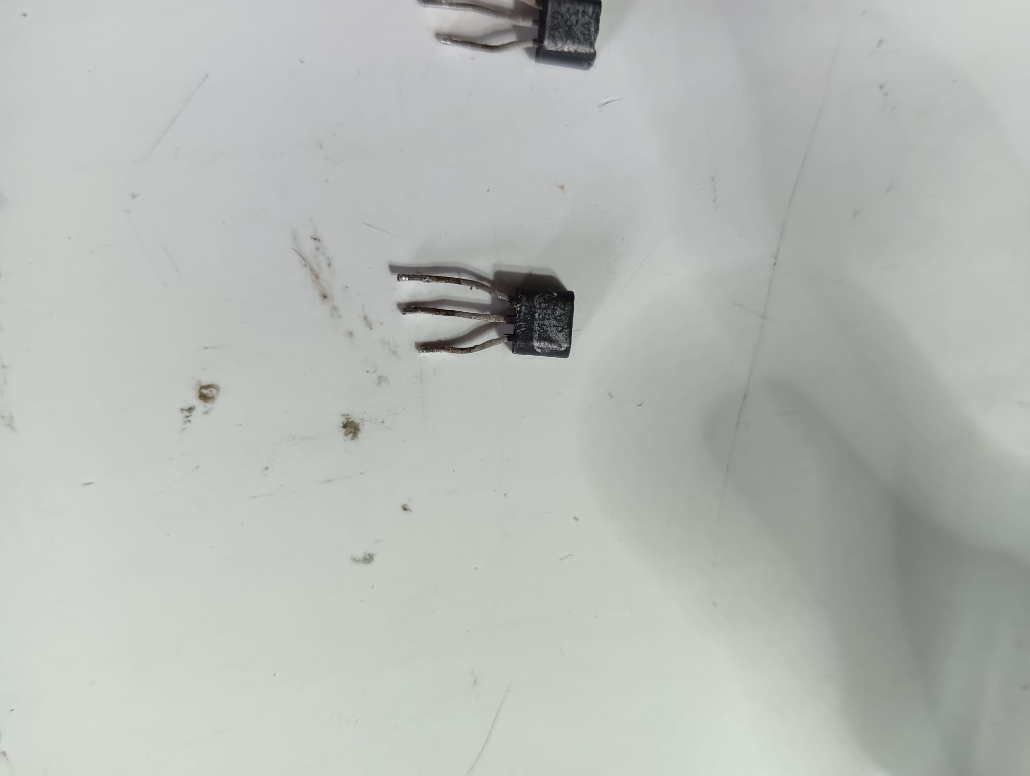

Hello everyone. I have an A3i on the table and the two ZVP3306 are burned. Does anyone know of an equivalent for them? Thank you.
In the photo it looks like it's fake. It seems that they have been deleted and they have been rewritten.
Hi cucu70,
I can't tell from the pictures as the markings are too messed up.
So, look at the original specifications for those transistors, then look at currently available parts that have the same or better voltage (c-e) ratings, same or better current and dissipation ratings and around the same gain or a little higher.
You have to watch the pinouts between transistors, sometimes the leads are in a different order or they may be completely reversed.
Hi cucu70,
I'm sorry, but I am a working technician at work now. I do not have the time to look this up for you.
If you are repairing an amplifier (or anything) you really need to understand part ratings and specifications. I did tell you what ratings at the most important on the spec sheet. fT and a couple others may be important depending on application.
I am working on one, but I can't remember the part numbers off-hand right now (or I would gladly tell you). When I get back into it I'll know what I used. But I can't do that right now. So, please look at the data sheets for each part. Do not use a cross-reference guide without checking each rating yourself. There are plenty of mistakes both in printed and on-line versions. We used to call them "the book of lies" if that gives you any clue.
-Chris

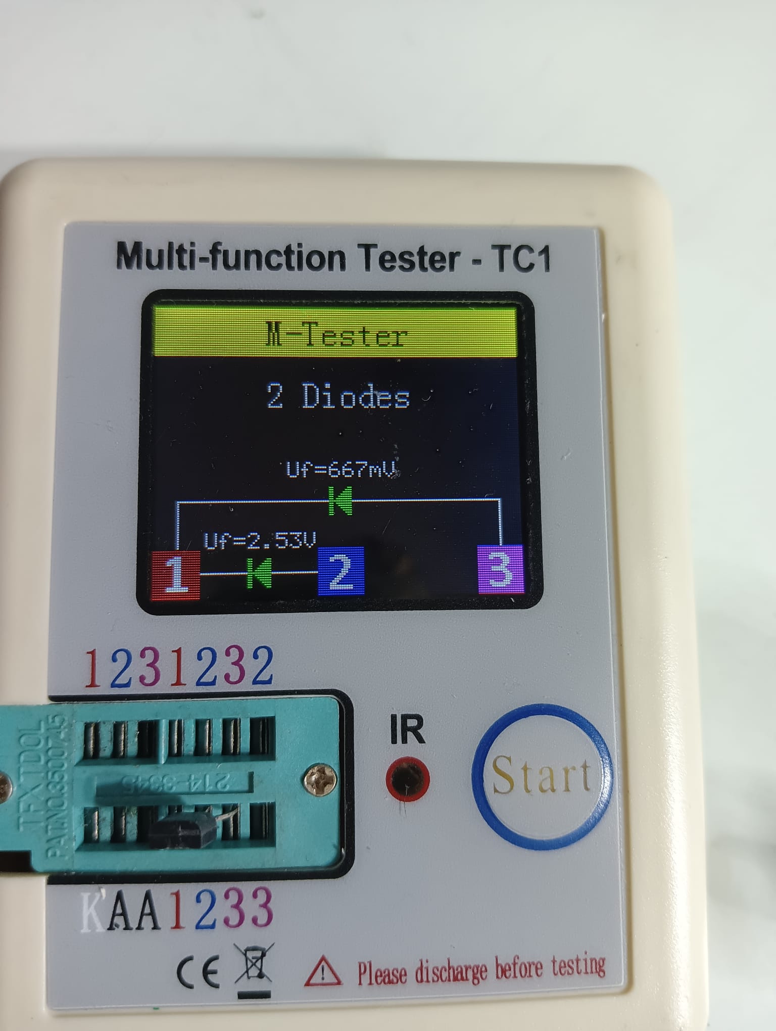

Post 433 :
Careful, the simple tester does not know everything. If a device like this is not in its parameter
list it will not be recognised. What makes you think that these are defective - in both channels ?
My tester of similar make does not know germanium transistors and the readout is similar to that
in your picture. I think I wrote about a transistor replacement years ago here.
