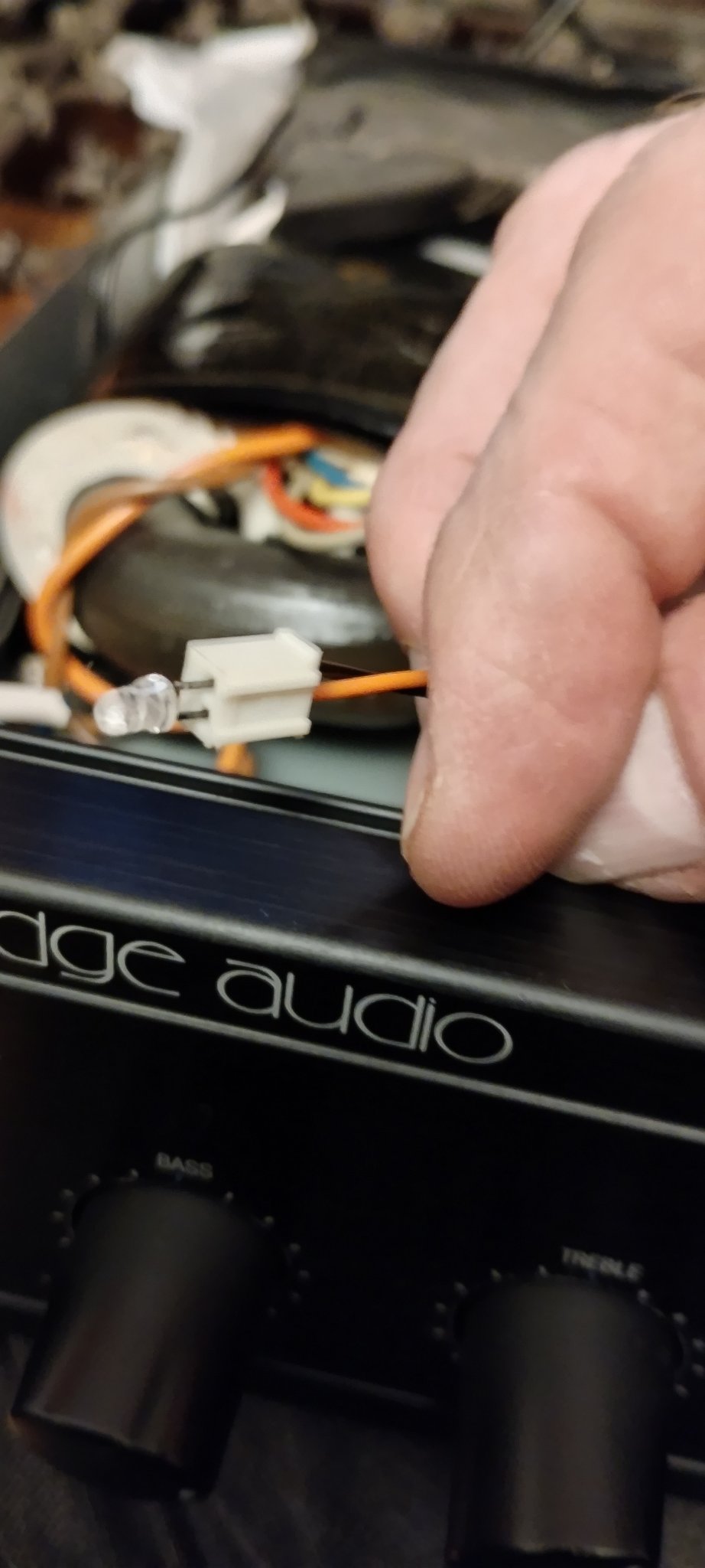

Yes, it's too easy to install whatever you like in there. Now to adjust the current and drop the dissipation to sane levels. The existing LED has dropped significantly in efficiency since it was new anyway.
Nice one, I've got parts on order. I'll try to get the current nice and low 👍Well the world is your lobster with that one... you can fit what you want 🙂

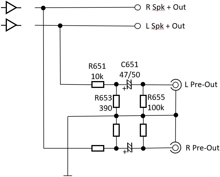

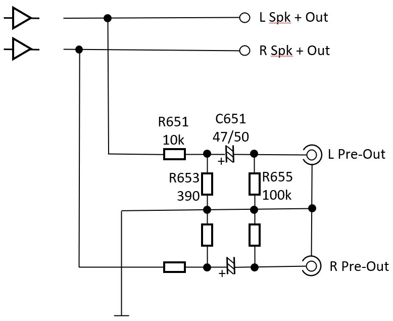

Ok, to look at other solutions, I was looking at the pre-out circuit in a Denon PMA-700AE that I have here and would like to hear what you guys think of it:
If I'm reading the circuit correctly, it seems to me not a real pre-amp output (yet marked as "Pre-Out" on the schematic), but could this pad be added to other amplifier outputs (such as A3i) to create a decent low level output? 🤔

The levels are pre-amp like. If the amp is delivering 1 watt into 8 ohms (which is8 volts peak to peak) you will see around 300mv peak to peak at the pre output or approx 100mv rms.
That kind of thing can be added to any amp.
..'ave it ! 😆 This is at 3mA, I'll take it down to 1 I think.

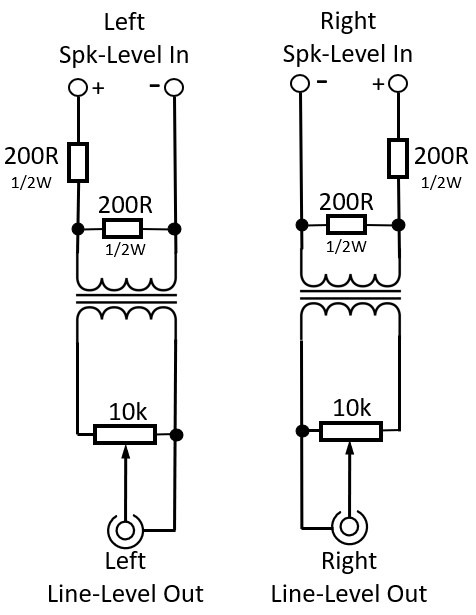

Anyway, to save me buying parts and building a similar attenuator, I forked out £6.50 and bought a device made by Pyle (PLVHL60) , which I think is primarily aimed at the in-car audio market. It works a treat but thought I'd show the circuit on here for opinions, in case you guys can see anything concerning. My thoughts are with the power rating of the 200 ohm resistors (1/2W) across the speaker outputs of the amp, should I consider uprating them? (BTW, I don't know the details of the transformers)
Cheers
Let's put some numbers in and play it safe. If the amp puts out 50 watt rms/8 ohm then that means it delivers 20 volts rms. We don't know the split across the resistors (because of the transformer and its secondary loading) so let us say the first 200 ohm might see most of that voltage.
The power rating would need to be 2 watt.
In practice and for normal program material you could well find the 0.25 watt parts fitted are absolutely fine. For full sustained sine testing they need to be closer to 2 watt. Also the first 200 ohm will not see the full voltage (if it did that means zero across the transformer) and so that fact also significantly reduces the requirements.

Denon products sound different than the Cambridge for sure, but it shouldn't be a bad sounding unit. Now that I look at the schematic, I see something odd for a Denon. No driver stage for the outputs. That won't perform well.
Thanks, I'll keep an eye on it, and uprate the resistors necessaryIn practice and for normal program material you could well find the 0.25 watt parts fitted are absolutely fine. For full sustained sine testing they need to be closer to 2 watt.
Ah, that's good to hear, so it copes ok with the output of the Monitor. I can say it's the best I've heard the sub sound out of all the configurations I've tried driving it; punchy and tight.I use the same device exactly (Amazon) to connect my monitor to the stereo system in my bedroom. Perfect!

No, in the last part of my post I discovered what is unusual for Denon in that unit. It doesn't sound good. There are no driver transistors between the outputs and Vas. It isn't your imagination, that unit will not sound good. I've never seen Denon do that before.
I would sell it off. Another Denon (check the schematic first - or send it to me and I'll look) would make you very happy. That one - no! I wouldn't touch it with a 10 foot pole. Normally Denon products are well designed and sound better than average.
