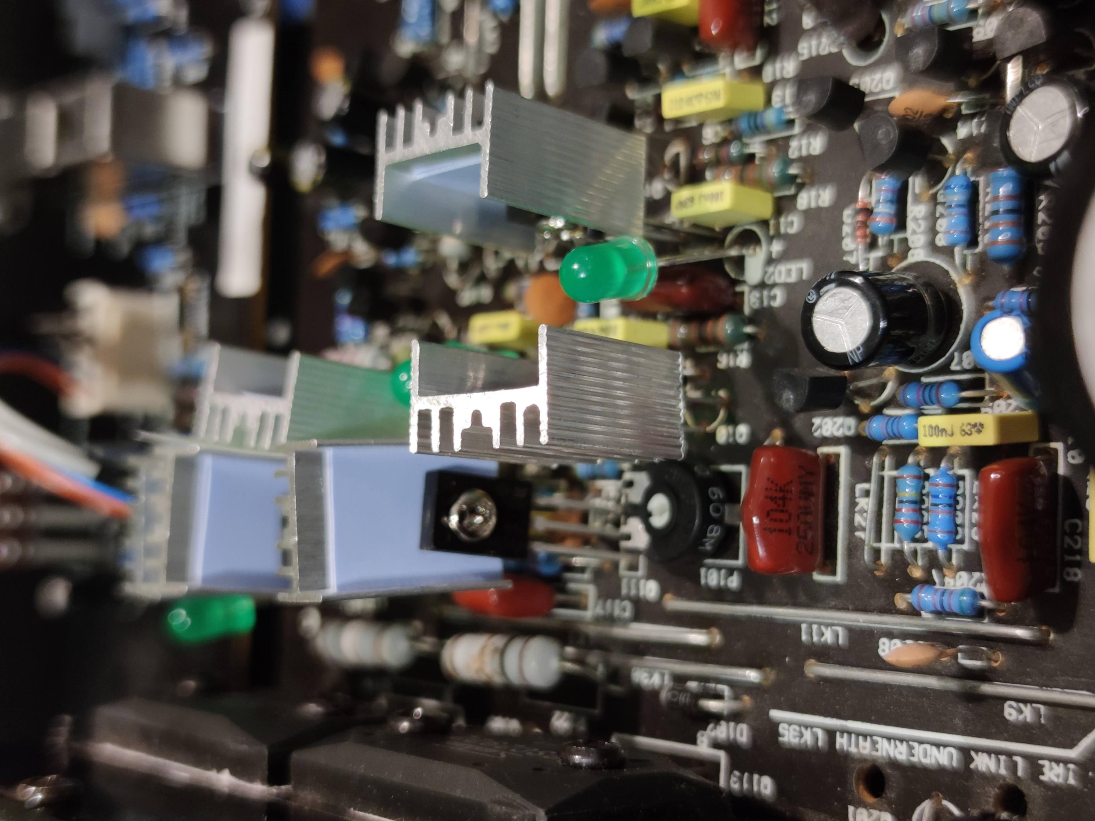

I have attached small heatsinks in upside-down way on each of heating transistor.
And I don't like how idling current behaves.
Issue is with Q11 and Q12, that they still heating up, but now slowly, and it makes idle current rising very slowly, and in total it takes 30 minutes till idle current reaches point when it stabilize.
So to place Q11,12 on small heatsinks, is not a right solution, in my opinion.
It was even better without heatsinks (Q11,12) as idle current stabilized within couple of minutes as soon as them heated to max temperature.
I will try to extend with 3way flat wire legs and attach them on output transistor backs. As Alex N. suggested at a very beginning.
Only FET is left without heatsink, not sure if there any "clip" type heatsink available in the market that could fit to help FET deal with heat.

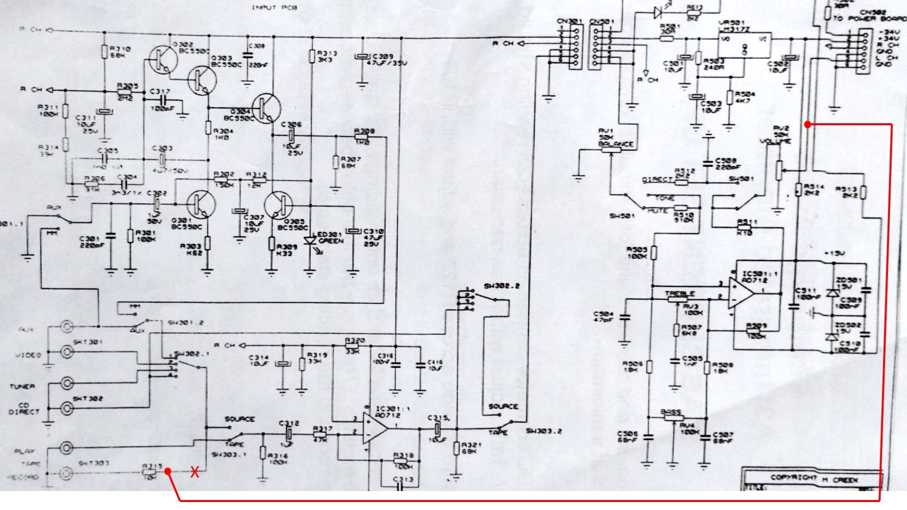

Hello all,
I've been following this thread for years and have used it to help repair my A3i many moons ago, and I thank the contributors for their priceless info, especially Alex, of course. I have never contributed as I am not clever enough, but I would like to make a modification to the amp and wondered if anyone has already done this before and also some feedback on whether it's a good idea or not. I have never used (and unlikely to ever use) the tape outputs, but would like pre-amp outputs to feed a sub which has stereo line inputs. Cutting to the chase here's what I want to do:
Basically, isolate the tape outputs from the inputs (where the red cross is in the image) and the feed the Volume pot output to the tape output via the 10K resistor. Any thoughts? Cheers guys
It will work as you imagine but be aware that the input impedance of the sub inputs will appear in parallel with the wiper of the volume control (plus that series 10k). If the impedance is low, it will have the effect of altering the law of the control meaning the subjective level vs rotation of the control will be altered. The pot is shown as 50k which is moderately high and so will accentuate that effect.
All you can do is try it.

Wow, that was quick, thank you Mooly. Yes, I understand what you're saying, and yes, I'll give it a go. Maybe I can try increasing the value of the resistor before the tape output if the sound level feels massively wrong relative to the rotation of the volume knob. Below is the input side of the sub, showing 100pF caps down to ground and 10K resistor in line with the Left and Right signal before they are shorted together to make a single input for the sub's pre-amp. Like you say, I'll try it. Cheers 👍
