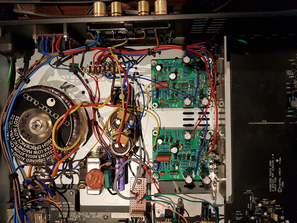

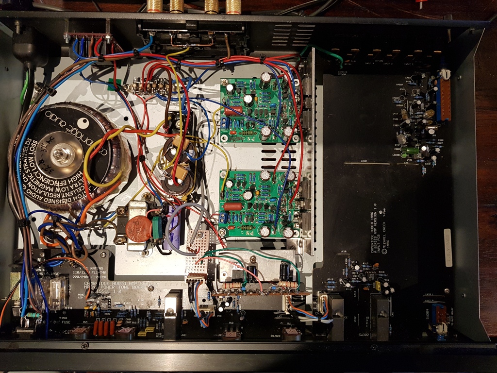

Hi guys, I new on here as I just got a A3i Amplifier.
I've got back into Audio/electronics after a really long time and it is good to be back!
I got myself an A3i last week to play some old vinyls as it has a phono stage built in. It worked good until yesterday when I smelled some 'hot' electronics. After turning it off and opening the case, I saw that everything looked fine except that there was no heatsink where there was supposed to be one and from where the heat was coming from.
I googled up information on the A3i, found some schematics and pics online and from what I saw, was that my A3i had been modded and looked quite different on the inside from what I saw in the schematics and pics.
The amp is quite ok and sounds good but starts to get hot once the volume setting is turned up past the 12 0'clock position and gets the speakers jarring ( Celestion Ditton 130, 8 ohms 70 watts) when the volume control gets to the 9 0'clock position.
I would appreciate it if someone could help me out with letting me know as to what exactly do I have, here?
Cheers!
