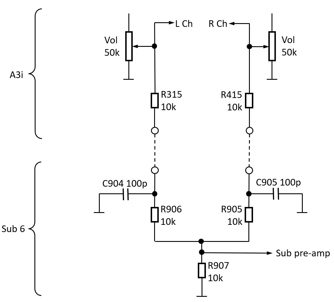

Here's the circuit:
Whilst listening to some music I connected the phono leads to the JBL Sub6 (with it powered down so no audio from it) and I heard a slight reduction in audio level from the A3i through the Tannoys. To get back up to the same level I had to turn the vol control through only a few (maybe 10) degrees.
So all pretty good on the A3i side, but a couple of things:
I powered up the sub and the sound level coming from it is a little too low. Even with the Sub6 volume control turned up to max, the LF level is somewhere close, but not quite there.
Another problem is the Sub6 gets a bit noisy when its volume control is at max (background hum/buzz) which is annoying during quiet passages. Knock it back a little and the noise reduces significantly.
So I'm considering making another modification; increase the value of R907 in the Sub6 in an attempt to bring the input to its pre-amp higher up in the resistor chain. Does this seem a reasonable thing to do (am I understanding this circuit correctly or barking up the wrong tree)?

Right... 🙂
It's much easier to visualise when drawn out like that. Hmm. I can see one possible 'issue'. The resistive mixing is going to reduce channel separation as it will slightly mix the audio at the wiper/s of the volume control.
Altering R907 will alter the overall level of the sub. You can go all the way from zero to open circuit with that one to get the level you want.
I'm glad the circuit was useful, a picture paints a thousand words and all that. It's amazing what you can knock-up in PowerPoint.
Thanks for the feedback on the sub issue; much appreciated. I apologize it's off this threads subject ("A3i repairs and mods", not Sub6 mods) so I'll play with the resistor value (maybe introduce a variable resistor if possible) and see how it goes.
Thanks, also, for highlighting the issue with channel separation; I take on board what you're saying and must admit I wasn't overstruck on the way the sub's input circuit links the 2 channels together. With this in mind, I've now listened to some familiar tracks with quite noticeable stereo mixing and I can honestly say they seem unchanged and acceptable, certainly to my 60 year old ears 😢 . I'm guessing (read hoping) that the channel separation issue gives a problem only to the stereo imaging for the listener and nothing detrimental to the A3i itself, am I assuming correctly? 🤞

Channel separation isn't as critical as you might think... back in the day tuners and cassette decks (and vinyl) had very mediocre separation, around 30db I think. We are used now to digital sources and amps with almost no channel interaction.
Strange to say that a little mixing and blending between channels can sometimes be subjectively better sonically according to some listeners.
Ideally the two channels would be mixed via an opamp which would ensure no channel interaction.

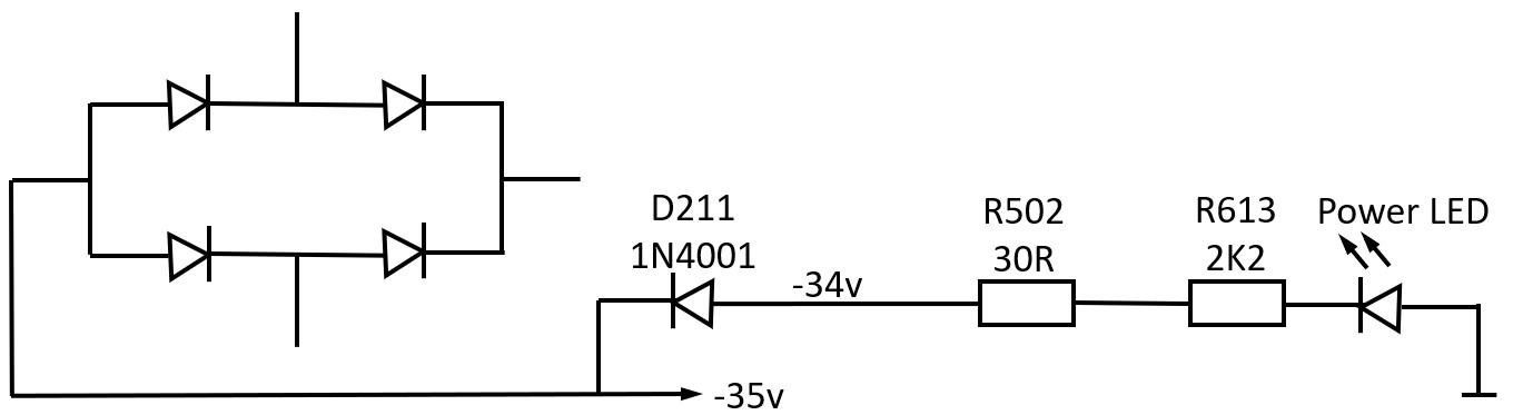

Here's the circuit from the bridge to the Power LED via R613:
The LED is a nice blue so would like to keep it if possible, so I'll try replacing R613 with a resistor of higher power rating than the original, then keep an eye on it for a while 🔥 ....
Edit: I've just played Nancy Sinatra's Bang Bang from the Kill Bill Vol1 CD, where her voice starts fully panned to the right channel in the master mix. I disconnected the right speaker and she's not in the left speaker at all, so well chuffed 🙂
Well, the current is approximately 14 mA with a drop around 32 VDC, that means a dissipation of approximately 460 mW. Running the LED at 14 mA is pretty high and a modern LED can probably be run at a lower current. We're talking blue. Since it is a power indicator you could likely run it around 8 mA and it should be bright enough, maybe too bright with a current production LED. The dissipation would then be around 260 mW, still pretty high. I assumed a 35 V supply by the way.
R502 does nothing. You would be way further ahead to split the dissipation between them by making them equal values. Otherwise R502 is merely a jumper. Using a 34 V assumption, your value would be around 2K0 each resulting in less than 8 mA. The dissipation then falls to around 120 mW each. Much more reasonable!
Hope that helps!
Hope that helps!
Hi Karl,
Yes, but you know I just can't leave a good opportunity to fix an iffy design alone.
A blue LED running around 14 mA? That should be pretty darned bright!
🙂I just can't leave a good opportunity to fix an iffy design alone.
Thinking about it and a modern LED would be super super bright at that current. Even 1ma can be more than enough for subtle panel lighting.

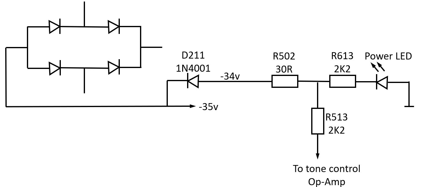

Erm , does this change things any? Sorry I didn't show the full circuit after the 30 Ohm as I thought it wouldn't matter, my bad...
Perhaps I should try a 4k7 instead of the 2k2 and see if that's better. I'm not bothered if it's dimmer than before, so long I can see it's on then it fulfils its purpose in life.

Yes, you're right. I haven't tested a blue LED at 1 mA, and it depends on how bright Redtrev wants it. However at 1 mA your dissipation drops down to 31 mW, so any resistor can handle that with ease. The drop on a blue LED should be around 3 VDC - very approximately. At 2 mA (handy LED tester) it is plenty bright with a clear lens, a diffused might be less bright but more even. I just tested a couple blue 5 mm LEDs.
Hi Redtrev,
Yeah, that kinda changes things. R502 is still basically just a jumper but you can't increase that value without affecting the tone circuits. Mind you, the rest of that circuit must have a filter cap and (hopefully) at least a zener diode to control the supply voltage. Without a filter you are feeding the tone op amp with pulsating DC.
I would definitely replace the power indicator and increase the resistance to allow around 1 ~ 2 mA to flow. That makes the demands on that dropping resistor sane.

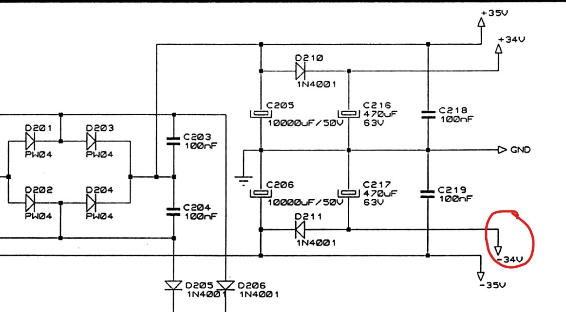

I've looked at the full circuit and the -34v rail is a raw but fully smoothed supply.
These amps are pretty old looking at the circuits. VN10KM FET's kind of date it. Were blue LED's standard fitment in things back then I wonder or has someone tried to fit one as a replacement in the past.
