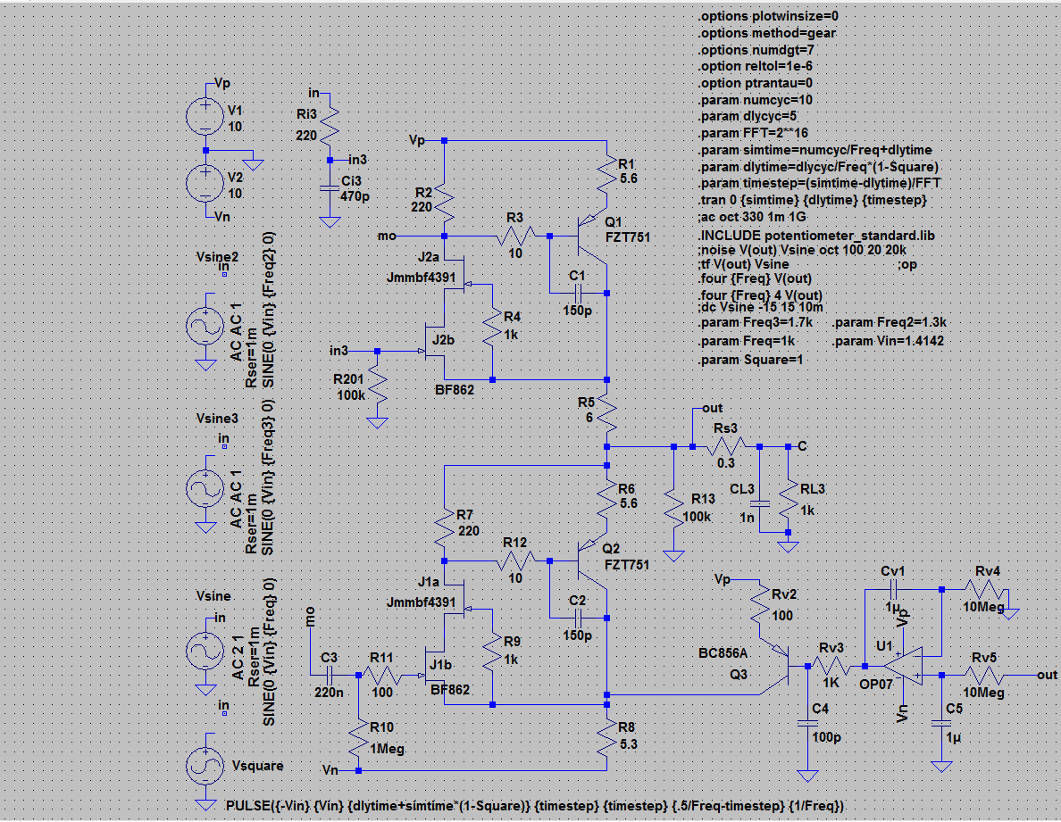

In my search for buffer stage I am currently at Calvin buffer. Lt spice shows nice simulation results with his buffer.
I made a spice file for his servo buffer. Basicaly edited Calvin's original file but of course I ended up in trouble.
I am posting it here,someone smart hopefully can find it out easily.
The problems are
#Not able to get THD output
#Unsure about the servo component values Rv1-Rv5, Q3.
Any help appreciated.
here is an image.I checked, the file will open without issue in Lt spice.Ignore the pot alert!!

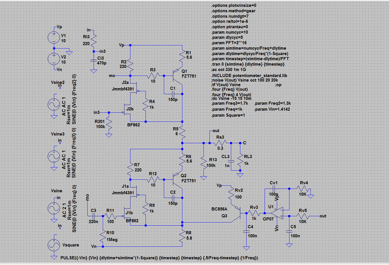

the components C5/Rv5 and Cv1/Rv4 are the lowpass filters of the dc servo, defining the lower bandwidth limit.
Two times, because the servo OPAmp is working in noninverting mode here, opposed to the simpler inverting servo one finds more often.
The transistor Q3 inverts the signal though and functions as a ccs that' current is defined by its emitter resistor and the servo's output voltage.
Rv1 is used to take sone heat power losses off of Q3 ... its rather optional here.
jauu
Calvin
the node where ´out´ is connected to is also the node ´dc´, hence labelled twice.
LTSpice ignores the out´´.
So either delete the label ´out´, or delete the label dc and rename the ´dc´ label at the servo input ´out´ also.
Rv3 is part of a RC-post-filter for the OPAmp.
The associated C is missing (compare to the circuit on my website, R19/C7).
The RC filter adds a 6dB/oct drop, so that the influence of the servo on the audible range is reduced.
A standard 6dB dc-servo can show considerable output within the audible range.
If You don´t want to use the post filter just omit with the Cap and reduce Rv3 to ~1kOhm.
jauu
Calvin

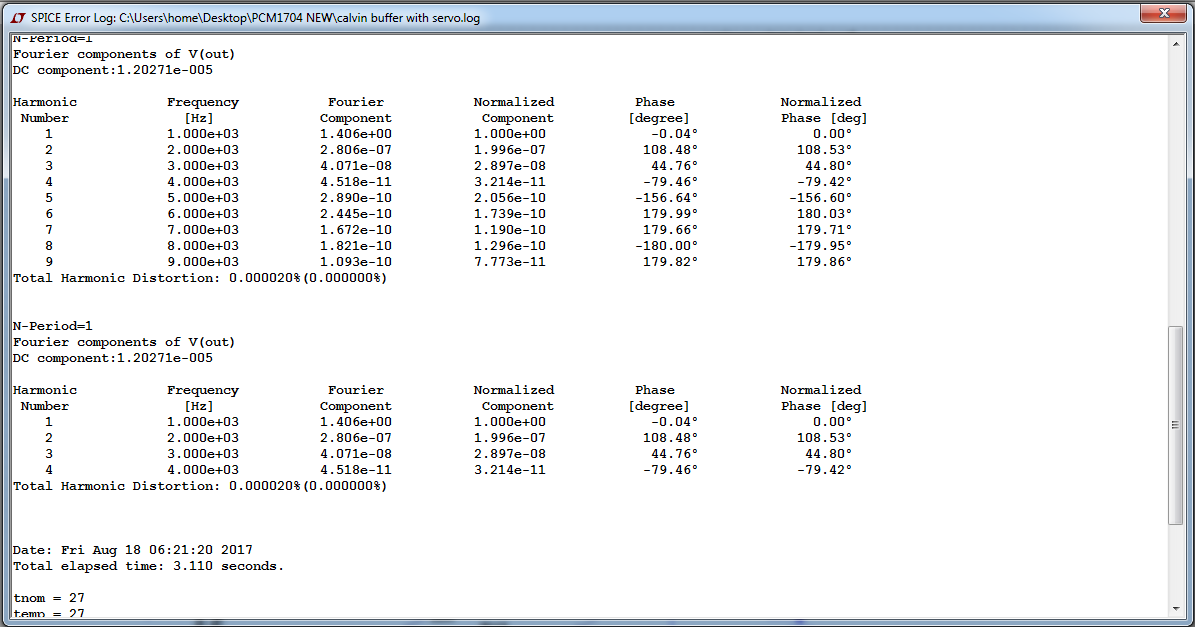

The servo seems like working with offset in 5mv. The issue is THD went up significantly
armonic Frequency Fourier Normalized Phase Normalized
Number [Hz] Component Component [degree] Phase [deg]
1 1.000e+03 1.407e+00 1.000e+00 0.12° 0.00°
2 2.000e+03 4.443e-04 3.158e-04 43.08° 42.97°
3 3.000e+03 2.011e-04 1.429e-04 -147.32° -147.43°
4 4.000e+03 4.585e-05 3.258e-05 37.59° 37.47°
5 5.000e+03 3.055e-06 2.171e-06 116.76° 116.64°
6 6.000e+03 2.511e-05 1.785e-05 -159.04° -159.16°
7 7.000e+03 7.942e-06 5.644e-06 44.54° 44.42°
8 8.000e+03 5.641e-06 4.009e-06 -174.18° -174.30°
9 9.000e+03 8.259e-06 5.869e-06 -165.39° -165.51°
Total Harmonic Distortion: 0.034870%(0.034880%)

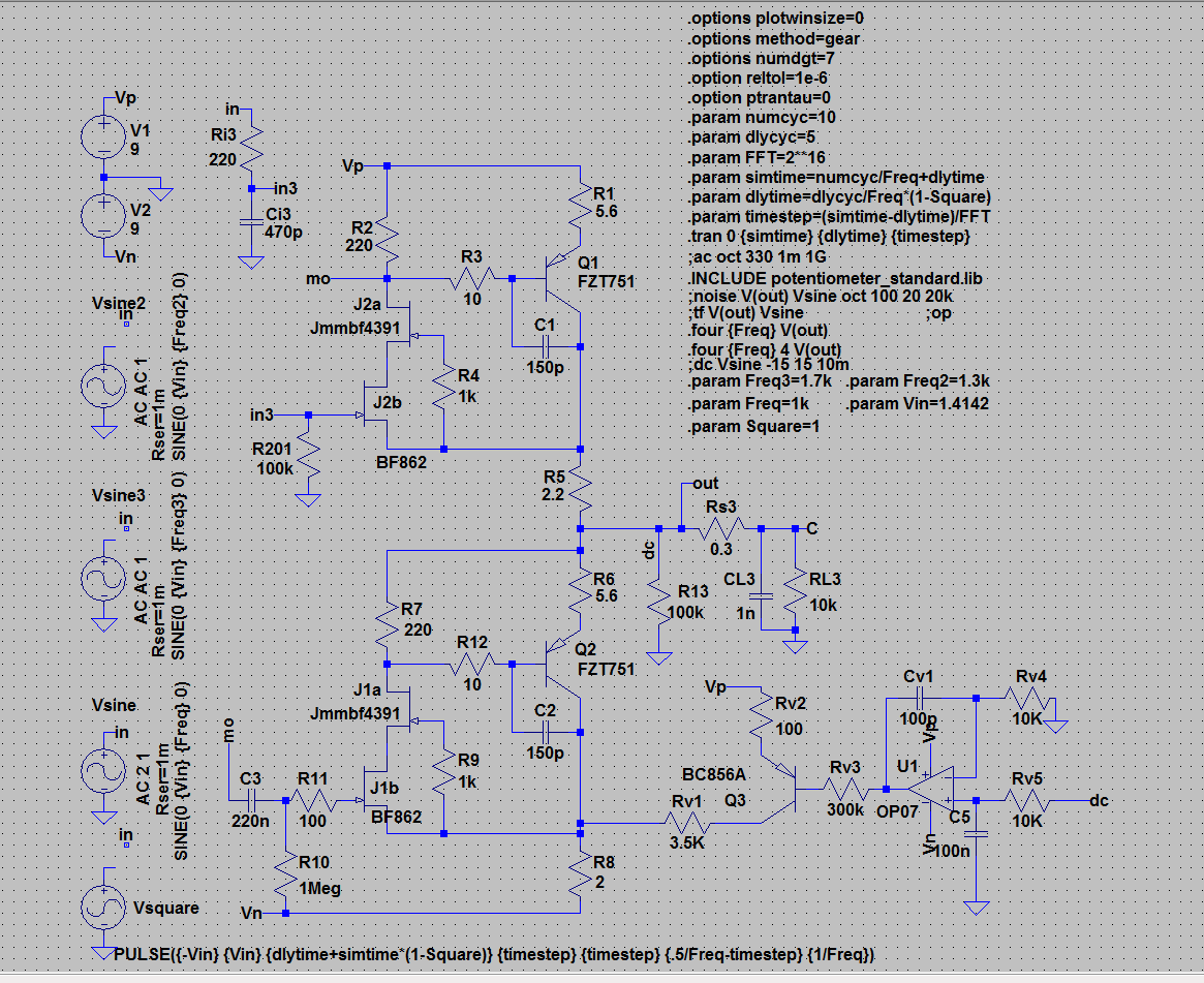

Jan,
While waiting for Calvin,I did sim with values you suggested.And the THD dropped to original 0.00006 figures.
V-offset between input and output 0.009V ,when I changed the value of R5 and R8 to 6 and 5 ohm to create offset. Without servo measures 0.07V .

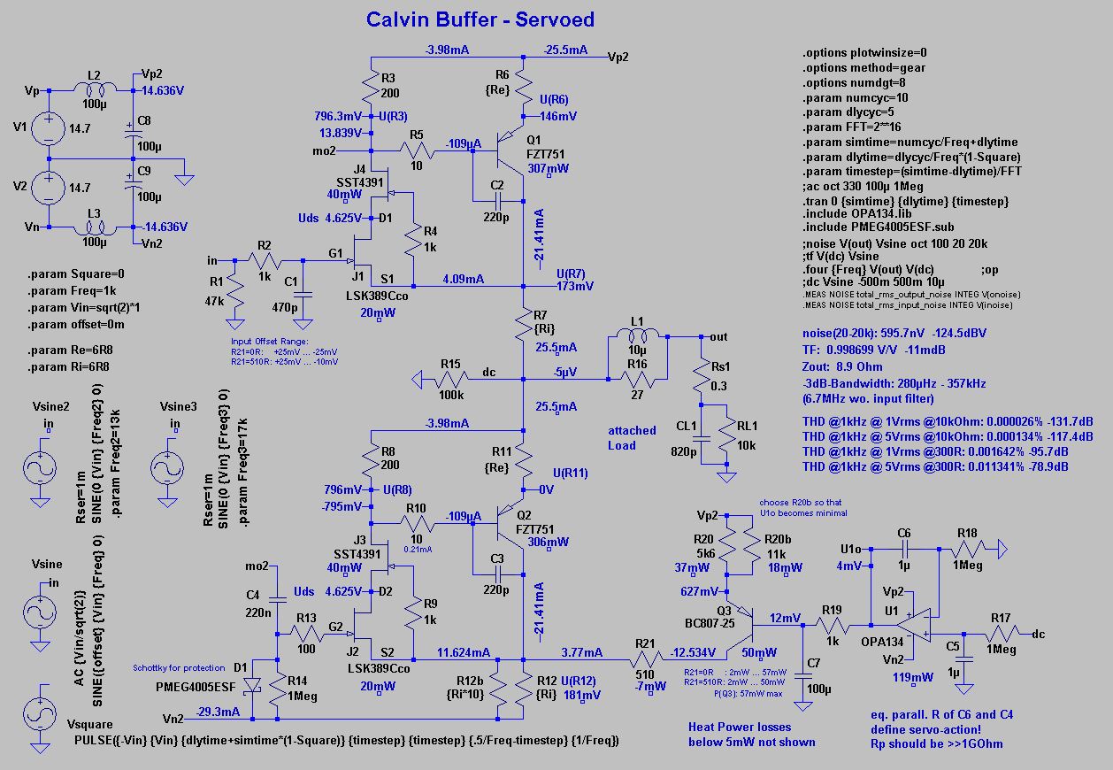

attached is a circuit, that works as it should.
What seems non optimal in Your schematic?
- R5/R8 seem a bit low in value. The lower values lead to higher idle currents and heat power losses. For loads down to 300=hm (=> 600R balanced) up to 25mA of idle current suffices.
- depending on the chosen input JFET (LSK389 or BF862) choose R1/R6 so that the JFETs idle at 3-5mA.
- choose R8 ~10% lower in value than R5. This can easily be achieved in that You keep R8 = R5 and parallel connect a resistor to R8 of value 10xR5 (or 10xR8, see R12b in my schem).
- choose the servo Caps and Rs = 1µF and 1Meg (don´t know how the other lower values made it into the schem without noticing).
- With high valued servo resistors a JFET-input OPAmp could be a better choice than a bipolar input OPAmp. The new TI OPA140 and OPA141 are high-precision JFET-types ... but the good old OPA134, OPA132 and OPA604 will suffice also.
- choose C4 = 100µF. The post filter´s -3dB freq should be well below the audible range to achieve a noticeable effect.
- Rv2 is way too low and forces the OPAmps output into the supply rail. The optimal value for Rv2 would be chosen so that the OPAmp´s output settles around 0V. As a rough rule-of-thumb procedure choose the current through Q3 = Iidle 1/10. If the buffer idles at say 30mA, choose Iq3 ~3mA. As the OPAmps output holds Q3´s base at ~0V, Q3´s emitter sits at ~600mV. Rv2 then calculates to (Vp-600mV)/3mA, roughly 9V/3mA. So Rv2 should be ~3kOhm in Your schem. In my schem Rv2=R20||R20b. With R20 beeing kind of preset resistor and R20b fine tunes the OPAmps output voltage (and it takes some heat power loss from R20).
- Though the servo can also ´fix´ a certain small input offset voltage I´d suggest to ac-couple the input via a dc-blocking cap. One never knows how the preceding device is built. If it is dc-coupled, utilizing a dc-servo, both devices might ´fight´ for supremacy ... possibly causing oscillation. With a cap the servo can concentrate on defeating only the circuit´s own dc-offset.
- a last note: choose low leakage type caps for Cv1, C5 and C3. In simu, if You use the parasitic parameters of the Caps choose the equiv. parallel resistance no less than 1GOhm. Lower values and the DC-servo seems to loose its servoing capabilities. I´m not sure yet what causes such behaviour and why.
jauu
Calvin
between +-10V and +-15V should be ok.
Due tio the required voltage overhead of the cascoding JFETs J1a/J2a (J3/J4 in my schem) subtract at least ~4-5V from the supply rail as peak output voltage.
In case of supply rails lower than +-10V consider to omit with J1a/J2a alltogether.
They only make a difference in THD whem driving heavy low-ohmic loads.
If Your load stays >1k then both, cascoded and non-cascoded versions are almost equal.
From the THD figures printed on the schem You can see that the figures remain vanishingly low ... so low that it´d be almost impossible to measure.
Harmonic distribution shows a nice decay towards H2, H3 etc.
So nothing really to post here.
Joachim Gerhard had measured his built of he Buffer and posted the results and found it to be very good.
jauu
Calvin
You can omit with the 1k Gate resistors R4 and R9 also.
Since now the max. peak output voltage can reach almost the rails (minus ~1V) and the LSKs as well as the BFs only require ~2V You can get away with only +-6V rails for 2Vrms output.
Make it +-9V to +-12V and You have sufficient headroom for almost any line level load.
Don't go higher for the non-cascoded version, as this could lead to a latch up situation which will destroy the JFET. The LSKs seem to be pretty sensitive in this regard.
I had some simple cascoded JFET Buffers destroyed by this effect.
See the Schottky Diode D1 in my schematic for protection.
Noise isn't affected but by a tiny margin to the better. THD into loads >10k could also be marginally better.
It's into low ohmic loads <<1k and for higher supply rails that the cascoded variant has the edge THD wise.
jauu
