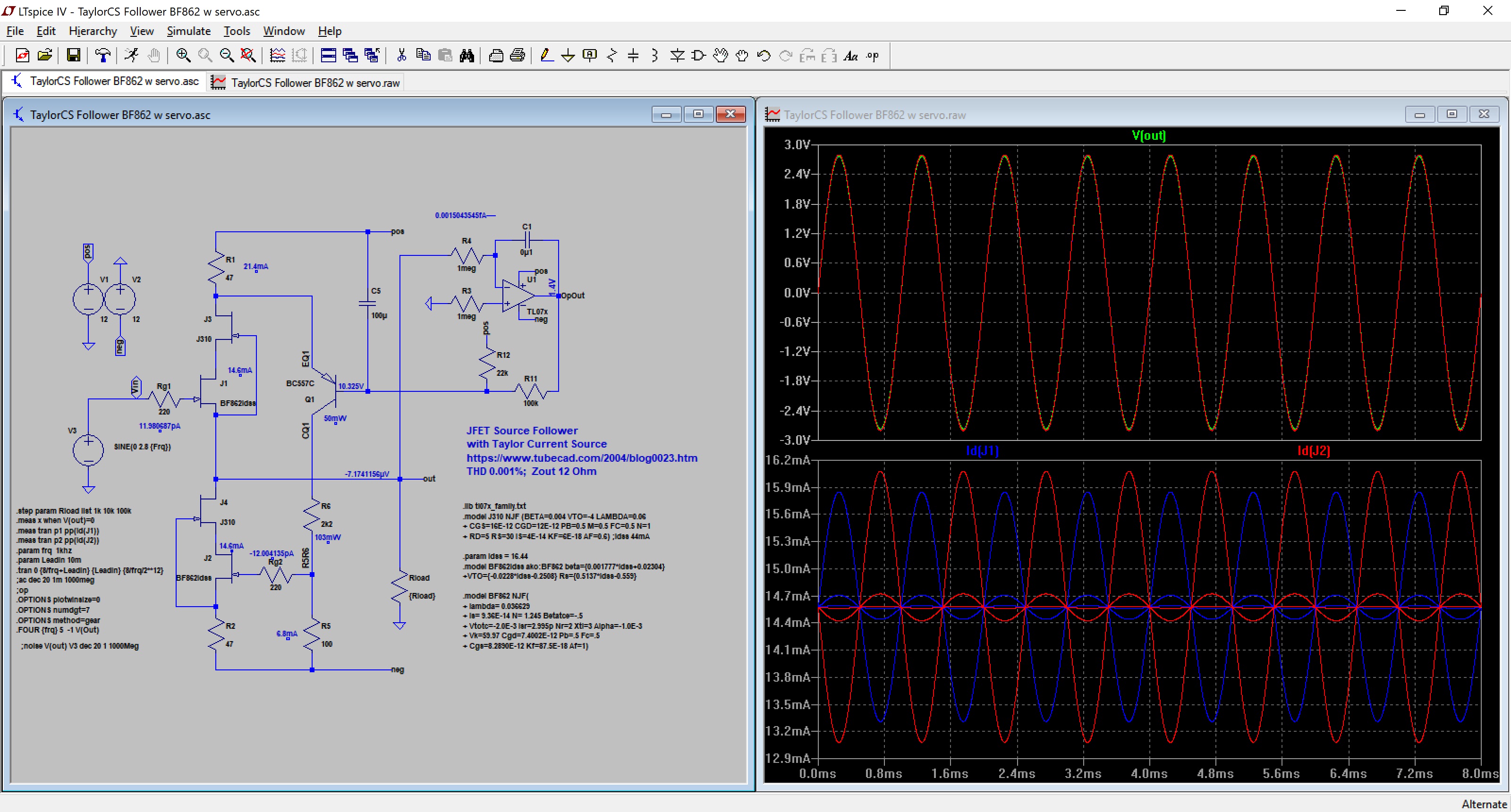

Maybe this is a good spot to chip in my current project:
A source follower buffer with a Taylor current source. EUVL brought it up in his thread on source followers. It is also explained in John Broskie's tubecad.
The circuit is push-pull, but instead of transmitting the voltage from the sense resistor R1 to the current source J2 by a capacitor, it uses a pnp-transistor. That way you can use a capacitor C5 to keep the power supply ripple away from the gate of the current source. A second extra is the opportunity to add a servo to set the base voltage of the transistor. With two low pass filters R4/C1 and R11/C5 there is virtually no signal left at Q1.
Actually it doesn't need a servo because you can also set the Q5 base voltage, and thus output DC, with a trimpot and it will pretty much stay there. If J1-J4 are pairwise matched and thermally coupled they only thing that makes DC drift is the temperature of Q1. And you can keep the heat on Q1 low with choosing the right R6.
The circuit is not CFP but it still sports a Zout of only 12 Ohm.

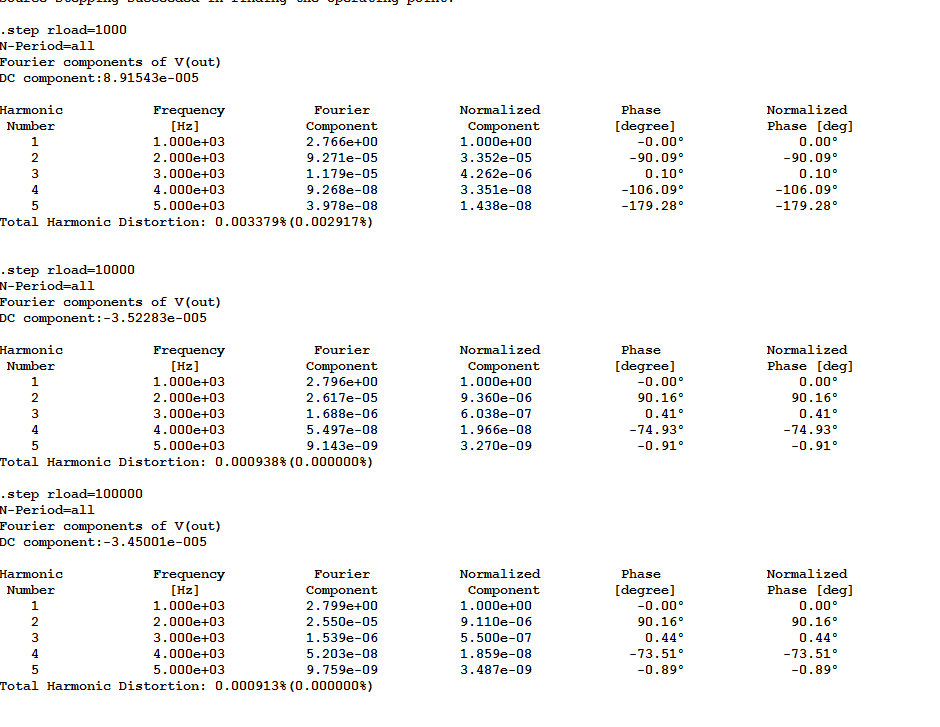

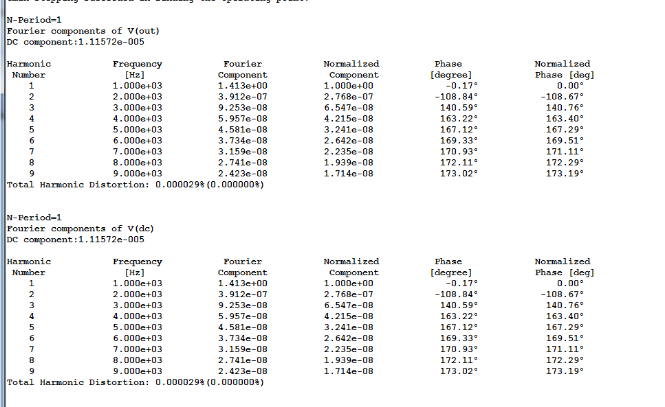

My last schematic has mistakes.Attached is the corrected one. What do y'all think about this one?
To ElFishi,
I have simulated Taylor follower and found to have higher THD. With Calvins design THD is very low with Z out close to 9Ohms. so why go after TCS follower?

Go with what suits you. The TCS follower has far less parts 🙂
The differences in simulated THD I find negligible, we are already far out.
Real life THD will be different anyway since the JFET model in LTSPICE is linear while real JFETs are not.
When I measure my test circuit with a behringer UCA202 (admittedly not a high end device) and RightMark Audio Analyzer I find it indistinguishable from the plain loopback.
Your input has a .22uF cap and a 10k pot: makes for a highpass filter with a cut-off frequency of 72Hz. May sound a bit dull in the low end...
Low parts count gives you a better chance to understand how the circuit works, I'd say.

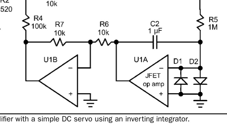

If you are happy to use an input cap (and you can have a small one after the volume pot) then you can actually use a more regular (and tested) servo circuit. See e.g. chapter 8 in Cordell, Designing Audio Amplifiers.

Reading the servo chapter from Cordell. Is there any benefit in using double OPAMP to make a servo as such rather than using one cap less?i would assume two will be more noisy?

Is there any benefit in using double OPAMP to make a servo as such...
The minimum gain makes a difference.
Beeing 1 with a noninverting integrator, while the inverting integrator drops down to 0.
Doesn´t count much though, as the noninverting integrators input is pre-filtered by R17/C5 (in #15), thereby generating the 0-output not by feedback action but ´nulling´ the input signal.

I don't recommend the dual opamp version.
Use a +ve servo where it works alone.
Use a -ve version where it works alone.
Don't use a -ve plus inverter, where a +ve does the job.
