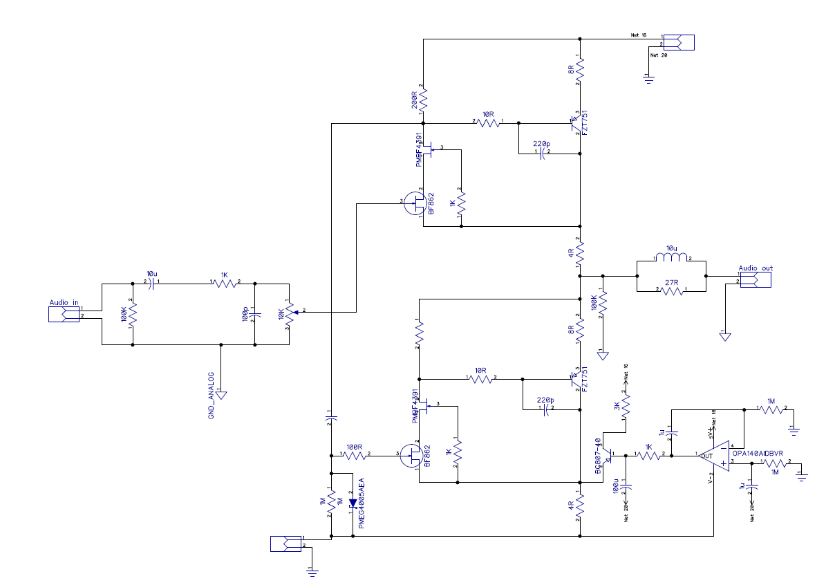

Thanks Calvin.How does this look ?
With the new setup I am getting an offset of 13mv between in and out.Is it accepatable?

to choose a 10k Volume control poti is reasonable but check that the bandwidth limit of the Highpass formed by the 10uF cap and the poti remains sufficiently low.
Choose more common values for the emitter and the source resistances.
The closest values to 8R would be 7.5R and 8.2R, resp for 4R it are 3.9R or 4.7R.
Around 4R will lead to quite high idle currents --> check for sufficient cooling of the bipolars.
You connected both inputs of the servo OPAmp to gnd .... why??
Doesn't make sense to me.
The only time You'd do this is when You tune the 3k resistor of the bipolar servo transistor, which btw ihas to be a pnp and not a npn.
Since You designed both source resistors to be the same 4R, there's no sense in using a servo anyway.
In that case simply build the Calvin buffer with offset trimming by a Poti paralleled to the lower halfs JFET-Drain resistor and omit the servo alltogether.
I wonder though, when You seemingly haven't understood the circuit in fullness, why don't You stick with the given values first and begin fudging and tuning after a successful built of the first?

The lowest I get is
DC component:-2.99094e-008
That is with R20 in post #15 with 1.5K and PNP Q2SB1427.
Buffer current is 53ma and current through R20 is 10ma.
Total Harmonic Distortion: 0.000033%.

Everything under ~10mV of output offset is reasonably low.
With typical mutimeters You won´t be able to reliably measure down to 1mV or even less.
So don´t worry too much about to get the lowest figures.
Just keep an eye if teh offset remains low over time (after heating up).
