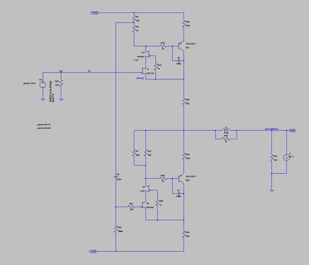

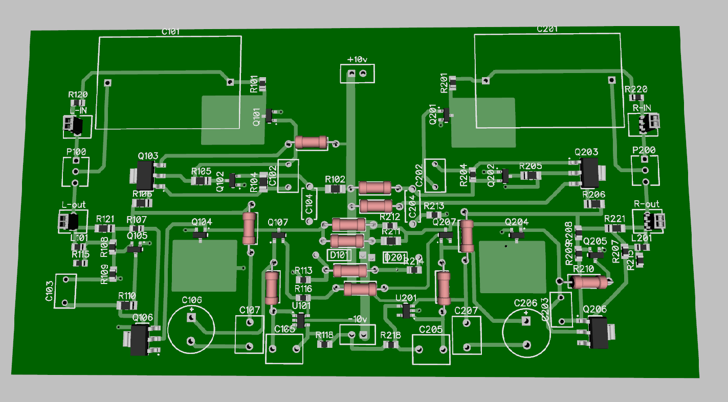

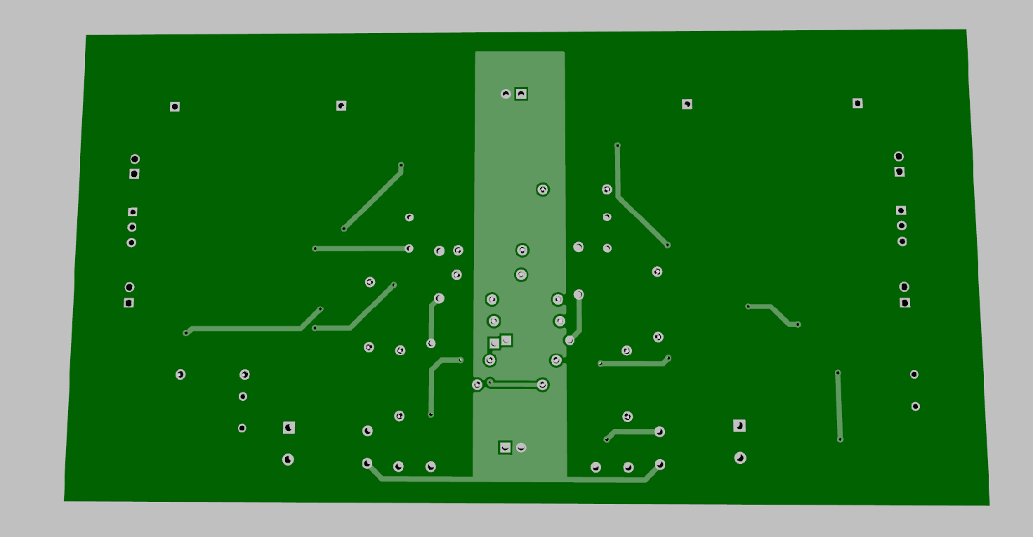

is this better? Sorry Calvin all SMD is very attractive but likely need a multilayer PCB.It might be my in experience too.So I replaced few smd with TH resistors.

I was validating the claim made by Ammel.At least in simulation I like the Calvin'S design over some others. And Ammel seems like talking with some grudge in mind. He does not understand why the Servo is used.

The clipped component leads in the carpet thing is still a bunch of nonsense as far as I'm concerned for justification to use all SMDs.
You do want you want kinku. After all, it is DIY as Jan stated.😀
Yes...I totally UNDERSTAND why you're using a servo to reduce offset since you're using SM JFETs(BF862) that are more challenging to match than the TO-92 devices I used in my examples.
Apparently you're too lazy or lack the knowledge to Idss match the PF5102 and J107 devices that work well in this design and used by myself...eliminating the need or complexity of a DC servo.

Ammel , sorry to say the servo is used not because Smd jfet is hard to match. In fact matching has very few things to do with servo and and using a servo won't void the need for Idss matching the master JFet. BF862 is considered even better in some aspects ( low gate Capacitance) than LSK in whichever thread I read. And the reason why I am looking for a discrete preamp/ buffer is to avoid opamp in the first place. I saw the threads and even in my personal interactions Calvin has more patience than anyone else around in this forum.May be time for you to move on. At the end I may or may not like what I make, or I may like it for sometime and then start looking for something" better", but that is what DIY is all about.
Hello Calvin
I am having difficulties simulating the Calvin buffer according to your design.
If I use Re = 6r8 and Ri = 2r2 as per the building guide (paradise) I have too much idling current.
The best compromise I found is with Re = 15 and Ri = 6r4 but even so idling is around 40mA.
Would you care to guide me here ?
