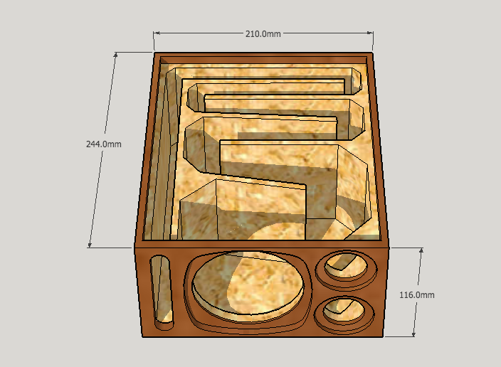

Nice design. Did you arrive at this via simulation?
No, I don't think the simulation models for transmission lines are particularly accurate with constrained line csa. Instead I simply scaled my existing noisePlank to suit the Sd of the SB driver, and lengthened the line to push the resonance down.

623661d1498914702-calling-all-t-line-experts-designing-40-hz-compact-enclosure-screen-shot-2017-07-01-5.48.52-pm.png
Note that the corner deflectors habe been shown to be counter-productive.

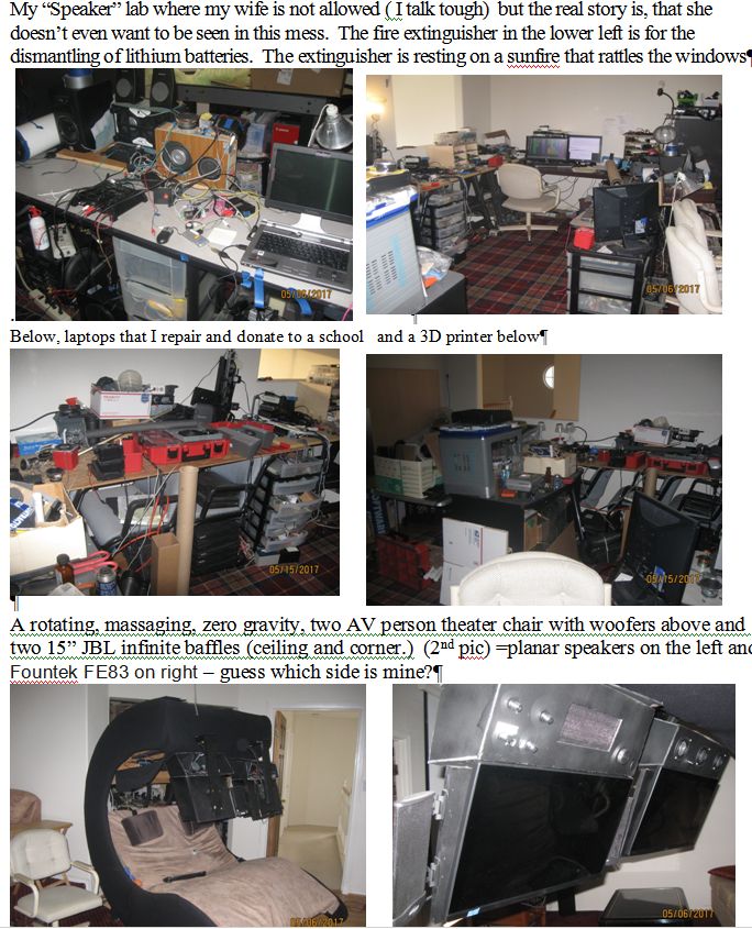

I was 3D printing a potential helix T-Line when my wife came into my speaker "lab" for the first time in a long while. She commented, "what a mess" so here are some older pictures of it - does it look like a mess? Nah
scott
