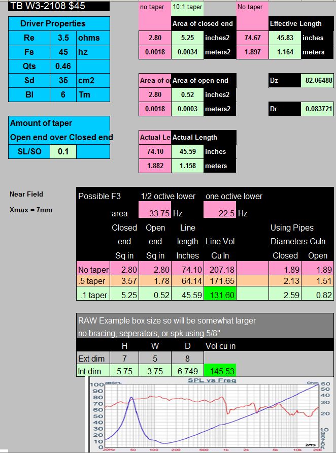

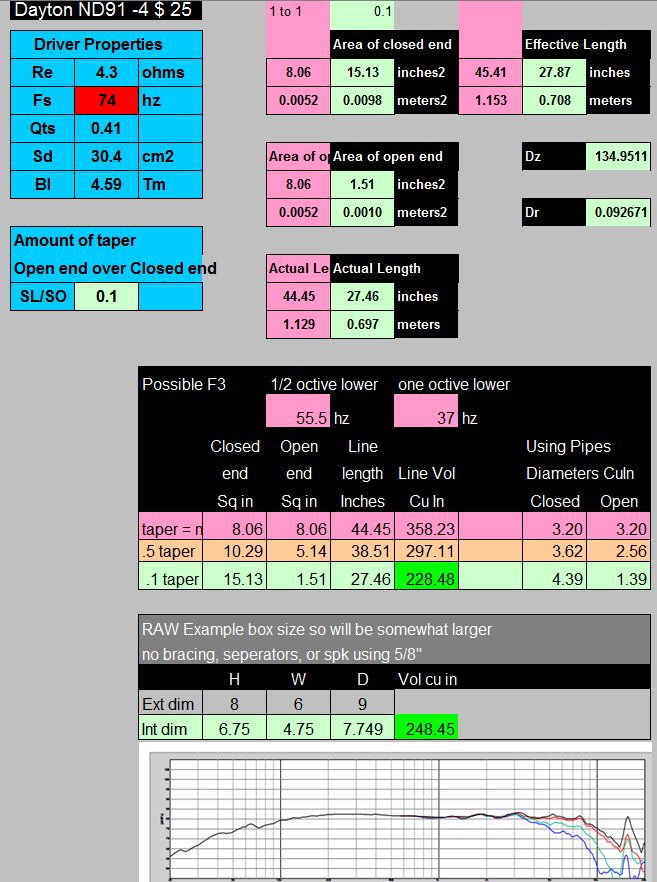

Thanks Planet10 for the advice. I now realize that the volume needs to be there as well as the length. I understand that the SD is not the main determination of the CSA but the Vas and/or Qts is. Does anyone know the formula to use to figure the CSA at the top of the closed chamber using either the Vas and/or Qts?
I have people telling me that a tapered T-line can't be as small as I'm thinking but here are the numbers that Alignment_Tables_Calculator_3_3_09.xls gives me for these three drivers. I understand that this spreadsheet has numbers close to MJK's numbers but maybe not? So I must be missing something because it sure looks like a near field 40hz in a small box is possible. Could someone check these numbers? Thanks
scott

Hey Dave,
could you look at the pictures in post 33 and give us your take on them. It seems that those drivers might get to around the 40 without EQ in the Line Volume mentioned (not box vol since those dimensions need the interior panels, speaker and outside panels. Thanks
scott

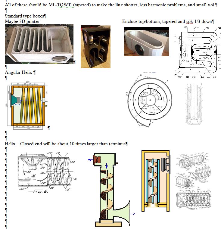

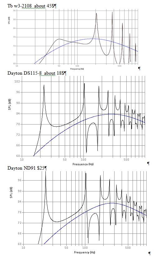

Hey Dave, Gm, Xrk91, and any other T-Line expert.
Here are the graphs below that seem to indicate that it is possible to make a very small T-line, near field, with an F3 at 40Hz (see post 46 for the size of the "line") and that is using, what I believe are inefficient enclosures compared to the ones picture below. Which one of those has the best chance as well as easy to build?
So I think I have done the work to, at least, look further into this but I can't seem to get people willing to join a group to collaborate, discuss a design, build it along with me so I can make a guide and post the results to this forum.
If the pictures below don't motivate anyone with, what it seems, like interesting, different and innovated T-lines, then there is no reason for me to continue to try to motivate people. If someone else wants to take up this thread and see if they can do better, I'll jump back in.
Thanks for all the posts up to now,
scott

There is nothing to innovate. You cannot fool the laws of physics, just operate within them. As Carl Sagan pointed out, the universe is not obliged to be in perfect harmony with human ambition.
-Acoustical length determines tuning Fb (Fp).
-Net bulk defines the lower corner frequency[ies].
-Line profile defines the usable (within in most cases rather narrow limits) gain BW.
-Driver and terminus tap locations where relevant help adjust the quantity of passband ripple by reducing excitation of harmonic modes.
-Damping also assists with attenuating undesired harmonic resonances, and where relevant, flattening the impedance if that happens to be a design goal (as in a purist TL).
That really is about 'it', on a macro level. You can play around with other factors on a detail front, which can and do affect performance, but none of them to the best of my knowledge are 'new', 'innovative' or 'different', and have been well-known physical principles and aspects of acoustical, gas-flow and mechanical engineering for decades. Not trying to squash enthusiasm or sound negative here, just stating some basic facts.
