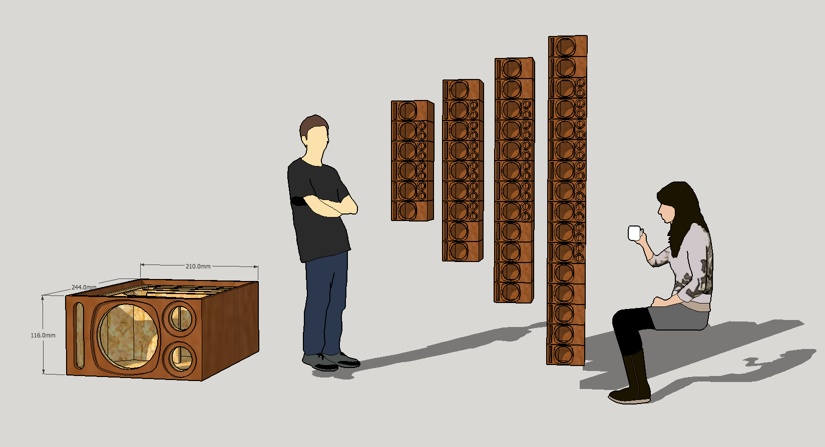

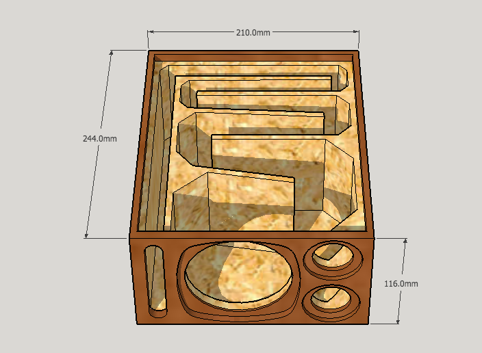

Here's my plan for a low volume transmission line. SB12PFC25 plus a couple of Vifa NE19VTS tweeters in a small cabinet. Line is 77cm^2 at the driver end and 17.6cm^2 at the open end, with a length of around 1.2m.
The whole thing is intended to be stacked in various heights to make a line array, but obviously the individual unit will hopefully be able to produce reasonable bass without too much eq.

Nice design. Did you arrive at this via simulation? Reminds me of a compact TL monitor I made that was inspired by a PMC monitor.
http://www.diyaudio.com/forums/multi-way/281778-low-cost-pmc-inspired-tl-monitor-dc130a-dc28f.html
Adjusting stuffing is key to getting a good group delay (here 8.6ms at 50Hz) - the impedance sweep will show a squashed bump with two small bumps on it when tuned just right.
With miniDSP active XO using Harsch setup I was able to get a pretty much transient perfect behavior. Here is step response and impulse:
The thing is, once you have folded up a weakly tapered line as much as you have, you wind up with an acoustic labyrinth, and once properly stuffed, you might as well do a simple sealed box. If you are intending to do a line array, sealed would be a far better answer anyway.

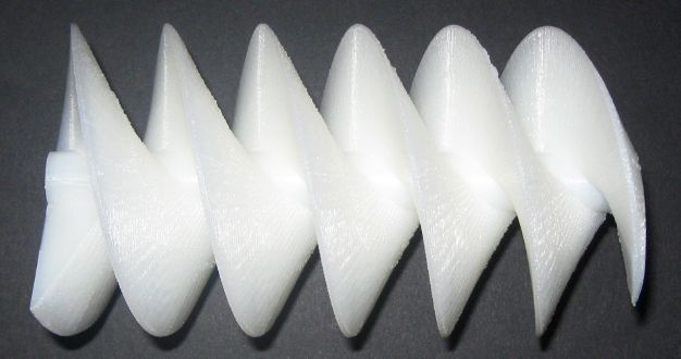

Bob's comment seems reasonable so if I went with a very smooth labyrinth, like the helix (picture below) that I printed with my 3d printer, would that be a better design for a T-line? The one below is a straight T-line but I could vary it to be tapered, I assume the overall taper would be 10:1. Here's what I'm thinking: Use the helix starting just below the speaker so the taper might be (ex. 5 to 1) for the helix. Above the speaker, probably 1/3, would be just a straight pipe or rectangle box. I would use my adjustable T-Line box to get the volumes and length correct before building the T-line. The helix box in the picture below is more complicated to do so would one of the others give the same results?

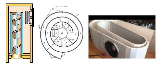

Xrk971, you are an expert both on foamcore and on T-Lines, what is your opinion about the three designs in the picture?

There is no separation of volume above, behind and below the driver in a QW enclosure. There is just volume, as in net bulk. The cross sectional area at different points is a function of this and the chosen line profile (length, taper).
Not that it matters, re the three items in the picture you attach above, the first is a vented box with an unnecessarily complex port, the second appears to be simply a long untapered line with a coupling chamber (sometimes called a daline, albeit with questionable accuracy) and the third is [quite a large] tapped back loaded horn.
thanks Scottmoose for staying involved. I didn't make myself clear on both questions:
1. I realize there are not separate chambers in a T-line but the CSA behind the speaker needs to be a certain minimum depth (affecting volume) which then effects the closed end top CSA and then the terminus. So what I was asking, not very well, is how much depth and then side to side, therefore volume, behind the frame opening (not magnet) is needed for a 3 or 4 inch speaker to "breathe." I assume that if the magnet butts up against the back that is ok as long as the width around the frame is large enough. Also, doesn't there need to be a certain minimum volume for the whole T-line in order for the whole t-line concept to work therefore if so, I would expect that the QTS and VAS of the speaker would determine that. Where can I find a program that tells me that volume? I think MLK's info is based on SD2.
2. And again, not well asked, but what I meant was: Because a T-line is a variant of a BR enclosure, which of those designs would be the best "converted" to a T-Line: To meet, closest to my goal, (keyword= closest) of a near field, f3 40hz, most compact enclosure.
thanks
scott
