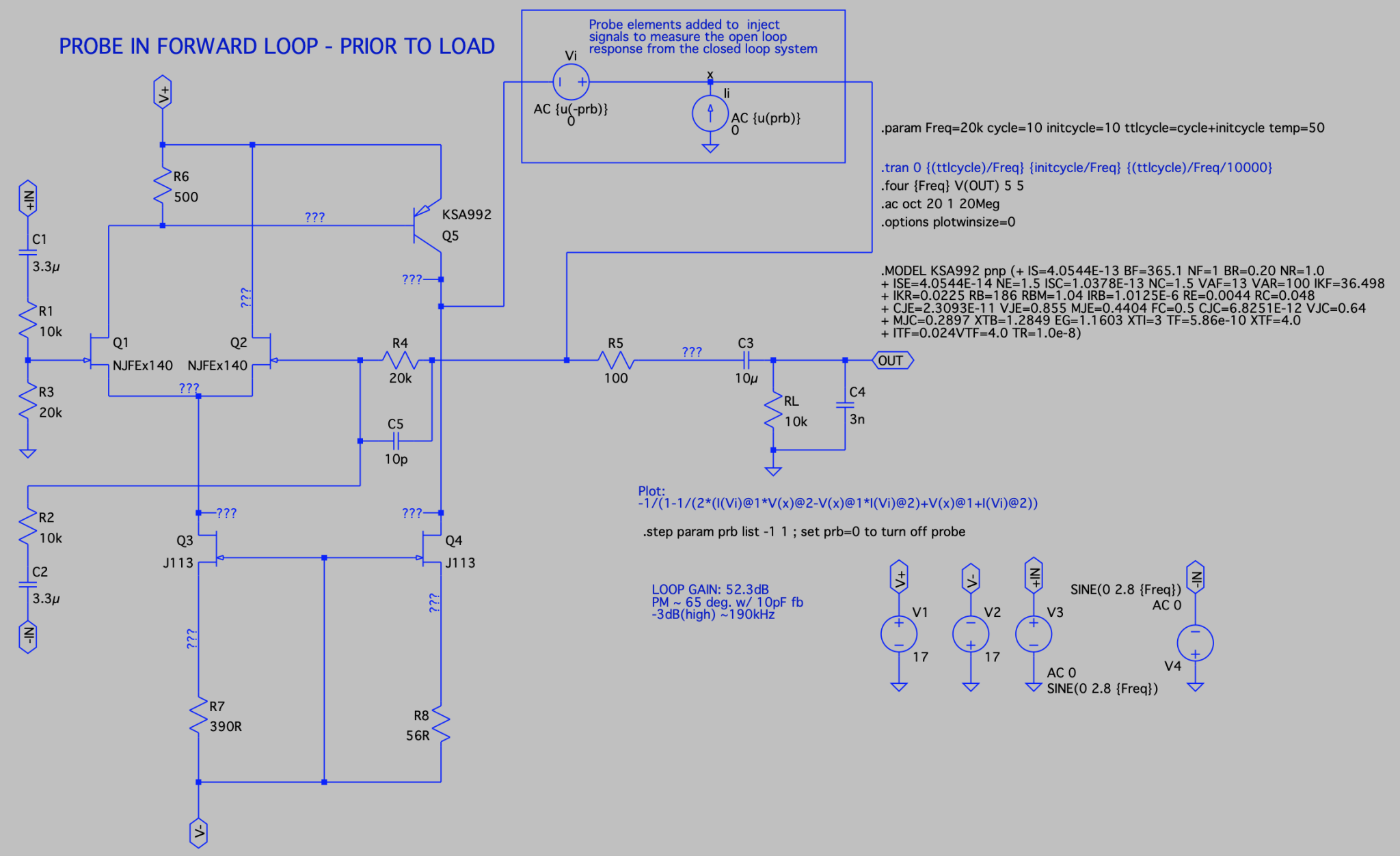

I'm using LoopGain2.asc to check stability. Results seem reasonable except for one piece of confusion. It seems like the probe elements should be within the FB return path, yet this jig has them prior to the load resistor--still in the forward path.
A large resistive load by itself doesn't seem to make any difference which side of the probe it's on, at least in my circuits, but the location of a more complex load surely must matter.
I also have some versions of my circuit with local feedback just around the output stage, and this of course makes a big difference whether the probe circuit is located in the forward path prior to the local FB cap/load node or in the feedback path on the other side of the output node. (I know there are some caveats in the Tian/Middlebrook papers about nested loops, but I think that's a separate issue. Nested loops are in the circuit of post #38 and the user reports good results. He also has the input to the probe sources as being the load node, contrary to LoopGain2.)
The short question is where is the right place to insert the probe sources?

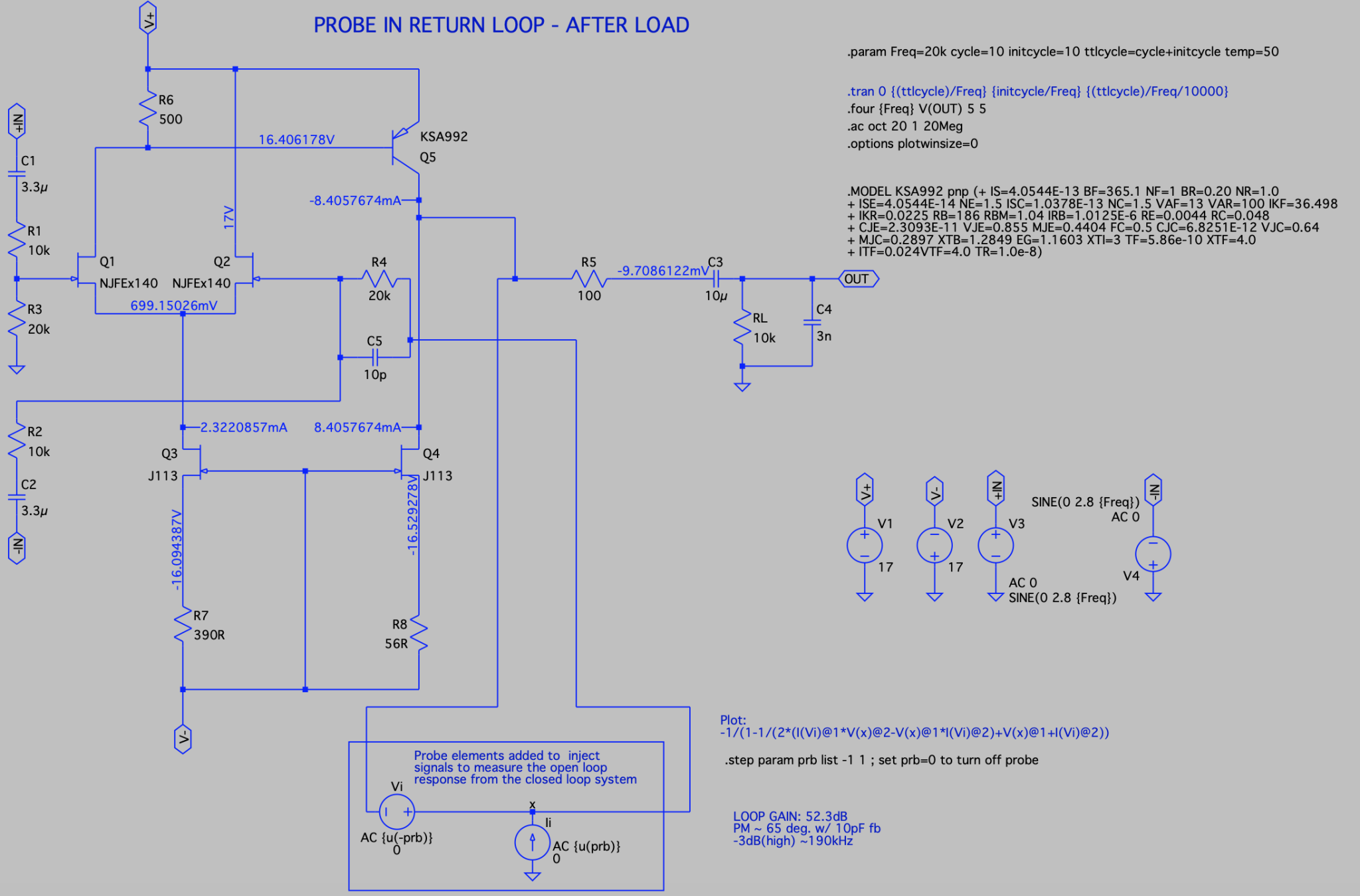

To my question, yes I'm getting the same or nearly the same results. But it seems like where you insert the probe matters, and LoopGain2 has it prior to the load, as it's applied in the circuit shown here. The RETURN LOOP version, attached, is how I would expect it should be: after the load.
So I get the same (or virtually the same) results, but I don't understand why it doesn't seem to matter. Comments, please? Thanks!

In one, the circuit is being broken between the output device in the fwd loop, Q5, and the output. (edited for clarity)
In the other, there probe breaks the ckt between that junction and the feedback network. If the probe ckt is lossless (seen as a short), then it would be invisible. Is that what you're saying?
(2nd edit: Also the probe reverses direction in the second case, of course, to follow signal direction.)
Tian's probe from LoopGain2.asc is designed in such a way that neither the place where it is inserted into the feedback loop nor the direction matter. The details can be found in the original article "Striving for Small-Signal Stability" referenced by LoopGain2.asc but are a bit complicated for a forum post.
Middelbrook's method from LoopGain.asc is insensitive to where the loop is broken but is sensitive to the direction. This produces error in situations where the signal flows around the loop in both directions (i.e. always in any practical circuit; usually, the effect is small at audio frequencies). Note that LoopGain.asc uses two steps implemented as two separate models, rather than two .STEPs of one model as in LoopGain2.asc.
Both probe location (or rather the impedances on each side of the probe) and the direction of the probe matter if a simple voltage or current source is used as a probe. For example, a single voltage source probe must be connected between a low-impedance "output" and a high-impedance "input" of the loop:
This is discussed in detail in Middlebrook's "Measurement of Loop Gain in Feedback Systems", Int. J. Electronics, 1975, vol. 38, no. 4, pp. 485-512, but is easy to see for yourself in a simulator.
BTW, Tian's formula gives you the phase differently. A simple probe and Middlebrook's show you how the phase changes as the signal travels around the loop. Tian's directly shows you the phase margin.
One more thing: in LTSpice, you can have resistors with one value for AC simulation and another, for everything else. This helps to break loops in AC while preserving operation points and transient analysis. Use them instead of that big inductor.

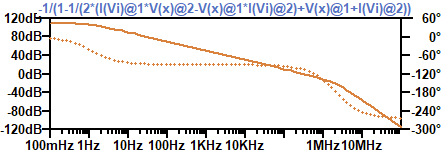

If you look at LoopGain2.asc:
you see that the loop gain phase is 0° at DC and goes negative negative at higher frequencies. The phase margin is the difference between the phase shown for 0dB (about -120° here) and -180°. BTW LoopGain.asc adds a minus sign to the voltage loop gain Gv=-V(x)/V to obtain the same result.
A 0° phase at DC is somewhat counterintuitive for negative feedback. The phase at DC should be -180°, not 0°, and get more negative with frequency. Alternatively, it could be +180° at DC and go more positive as phase lag increases with frequency - this convention is used in some opamp datasheets:
But this is nitpicking. Practically speaking, any convention works as long as no one is confused.

I figured out how to answer my own question. Subtracting the traces on either side of the probe yields zero. So the probe is not seen at all. I'm sure that's part of the whole point, but this is little too esoteric for me to conceptualize. In real world, where you break or load a circuit certainly matters, so this can puzzle because it doesn't.
Yes. The probe has to be invisible otherwise it would influence the circuit.
Think about a case where you would want to measure the current in a connection.
You can just insert a voltage source with voltage set to zero, and graph the current through the zero-voltage source.
That will show you the current in the connection but the source is invisible for the circuit.
You can see that the probe uses something similar.
Jan
