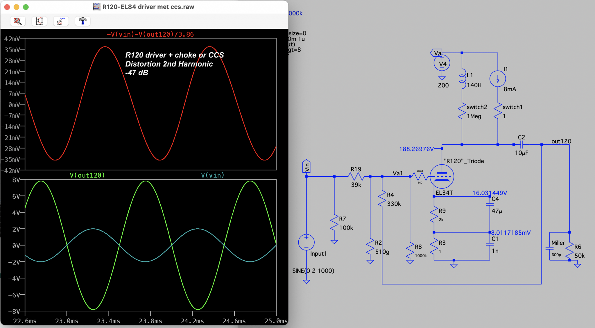

What I wanted to do is: plot -Vin-Vout/gain.
-Vi changes the phase; I subtract the output devided by gain.

Thanks, here my thinking:
To me, the Vout/gain would represent a wave that is as large as the input; so subtracting it from the input again should give zero nada. But there will be a difference.
I think then: The residual of Vin-Vout/gain is the harmonics and phase shift.
To subtract, I need to put Vin in the inrse phase because otherwise the two add up. . . So manually it works (see the 3,85) I compared the two voltages by hand - approximated by testing small difference between 3.8 and 3.9 in the measured data - then went for lowest figure - the way I my distortion meter works too. This takes a lot of time of course.

- I think it is better to take this to the large thread on how LTSPICE works ??
I don't see how there can be a difference between ' Vin' and ' Vin' .
The gain is by definition Vout/Vin, so if you measure Vout/Vin you by definition have the gain.
This gain is a complex quantity having a magnitude and phase and differing with frequency and also with level (distortion).
Why don't you plot Vout/Vin, that'll show you gain, warts and all.

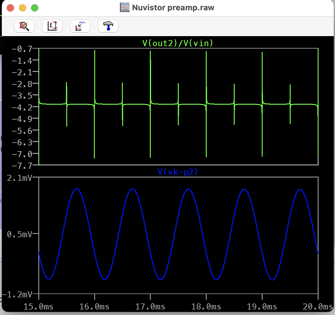

... and that is how crossover distortion looks: sharp deviations from the nominal gain at crossover.
Nice plot. It may not be 100% realistic, as the spice models are not either, but it's a nice illustration.

Looks like a transistor cross-over. (BC547>>??) But it is not 'real' to me. :🙂
The bottom trace is the cathode that I try to null to -50 or even 70 dB.
The problem is that you ask the simulator to handle a division by zero at the zero-crossing instants. This is a problem, unless it is specifically addressed in the soft. We, as human can handle intellectually infinitesimal quantities or infinites: we can even distinguish different types of infinity (like ∞<∞²), etc. but unless the soft is designed to handle it, it will give incoherent results.What I mean is really Vout/gain-Vin should be zero else gives the distortion. . . I hardly recognize this.
Anyway: the warts . .
In the boundary regions, the accuracy will decrease according to the number of digits, rounding method, etc., until it breaks down completely at the singularity
ahh, thanks that is an unsolvable problem then the way I started out.
