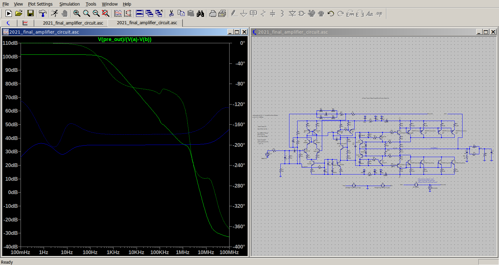

Thanks for all your replies. I searched online to find websites describing the Tian Test/Probe method and failed to find anything helpful. I only found scattered and fragmented information. Together with that, when I found a webpage explaining how to do a Tian Probe, the webpage information was outdated by two decades. It made references to dialog boxes and dialog options which no longer exist in LTSpice. Furthermore, the graphics describing what pseudo-components should be added, were inaccessible. This left too many gaps in the method, and I ended up not being able to do any Tian Tests. So, I reverted back to what I was doing.
The Method:
To calculate the open loop gain I devided the amplifier in two parts which isolated the input stage and the part from the VAS onwards. The negative feedback loop was broken.
The first thing to do was to simulate the amplifier with the negative feedback loop closed. This was done to find the minimum and maximum current fed in the VAS's input.
Injecting a current into the base of the VAS using a current source with a DC current of 35uA and AC signal with a peak of 65uA, the output swing of the VAS was about 100V. These values yield the following calculation:
Code:
VAS dV/dI = (30 - (-70))/(100e-6 - (-30e-6))
          = 769231 Volts/Amperes
After this, the input stage was fed a voltage of 20mV peak superposed on 10mV DC. This allowed the voltage to remain always positive (Yes, Zero is defined as positive). The output from input stage was directed into two signal diodes in series connected to the positive voltage rail that drives the input stage and VAS. The current through these latter diodes was plotted together with the differential input voltage into the bases of the differential pair. The following is a calculation with this data:
Code:
dI/dV = (250e-6 - 647e-6)/(9.82e-3 - 23.77e-3)
      = 0.0285 Amperes/Volt
Knowing the input stage's gain (Transconductance, although it has nothing to do with conductance), the open loop gain at 2000Hz was calculated by multiplying the two gains, as follows:
Code:
open loop gain = input_stages_transconductance * VAS_transresistance
                         = 0.0285*769231
                         = 21923
All calculated gains are RAW gains.
This second calculation corroborated my first findings.

Thanks for replying. Finally, I could execute the test. The provided example calculated some form of power as the expression for the graph involves products of voltage and current. Seeing the thus obtained results, I had to change the expression for the graph with V(output)/(V(a) - V(b)), where a and b are the non-inverting and inverting inputs respectively. The results obtained, corroborate my previous calculation results, and the shape of the open loop gain is typical of commercial opamps. This is a further corrobate that what I am doing should be in the right direction. The open loop gain for my giant opamp is extremely high for very low frequencies dropping to about 3300 times at 16kHz. It has the form of a single step with the high end at low frequencies and the low end at high frequencies. It is composed of three distinct linear segments.
Considering a raw gain of about 60 with negative feedback, this is enough. In fact, the amplifier works and is used every day.
I am attaching a screenshot.
