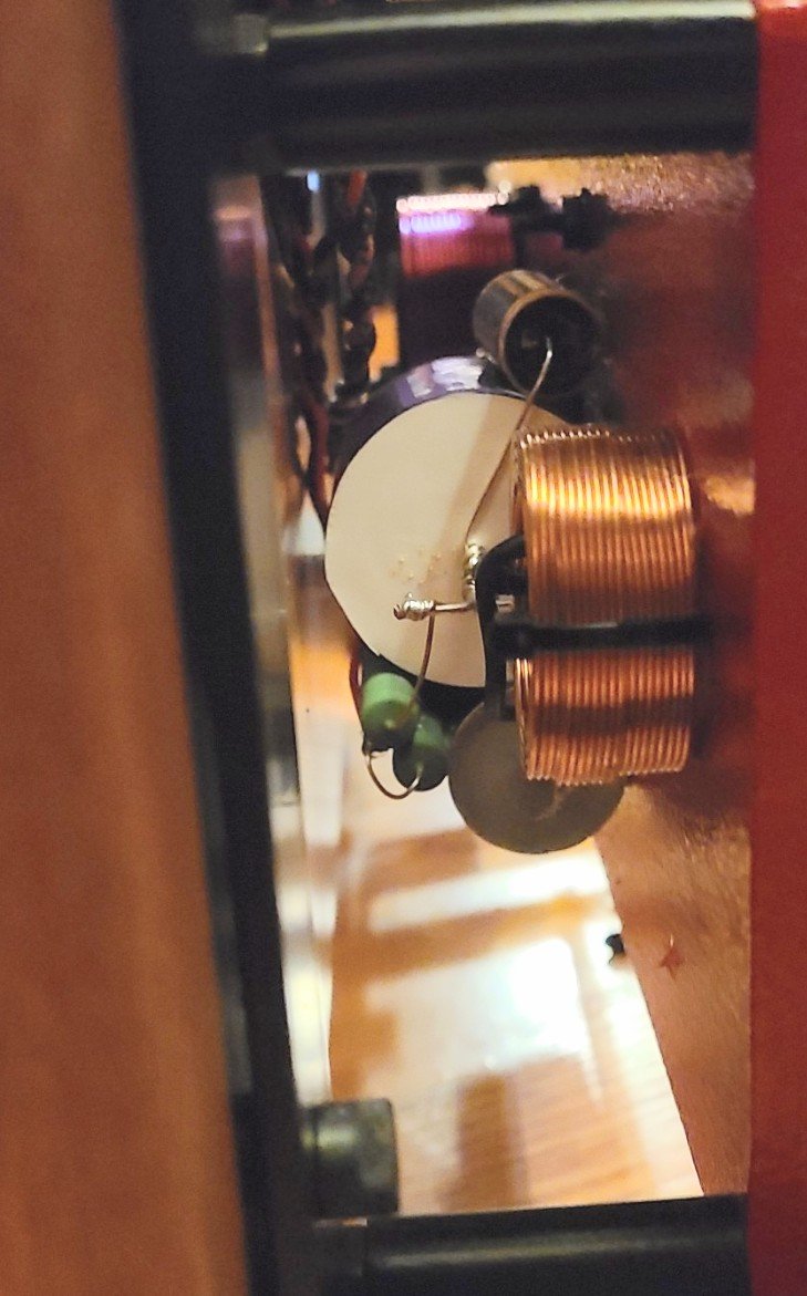

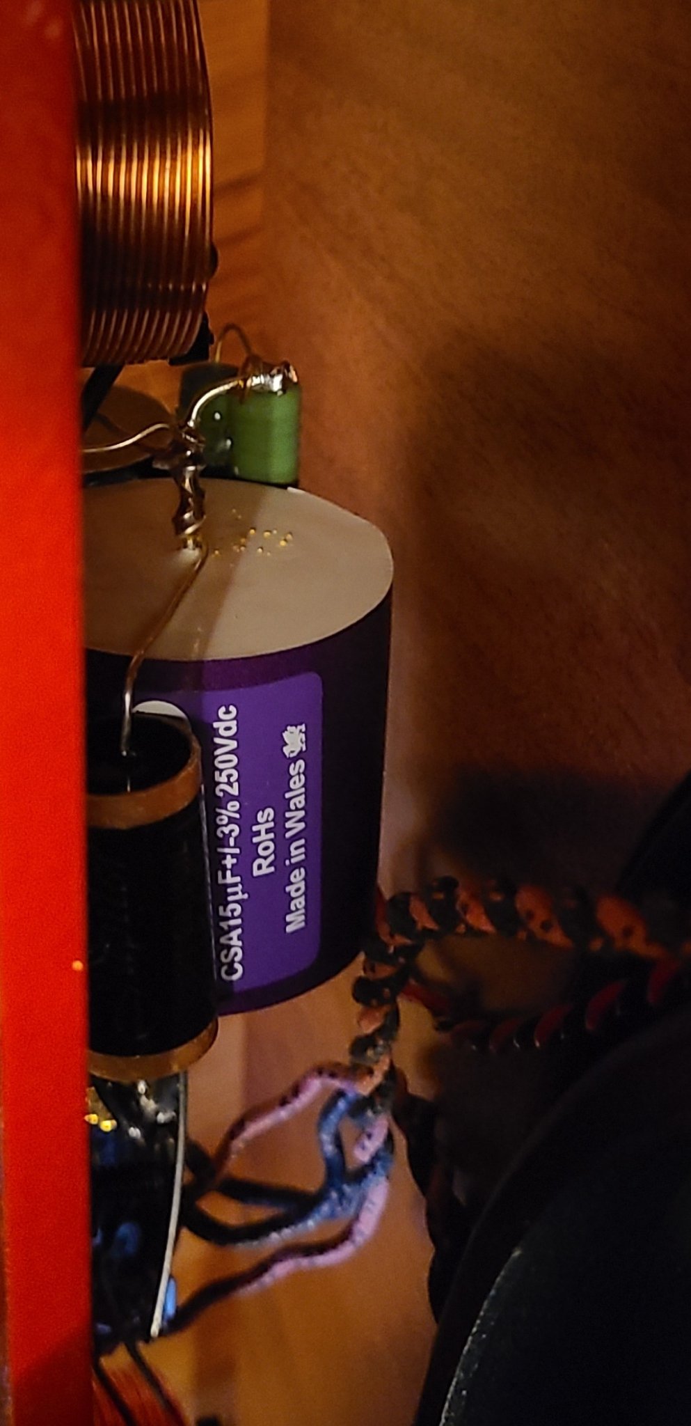

Word on the street is that Clayton changed the crossovers for the Caladans! There has been a minor "facelift". From what i can tell there is now a 13uF cap on the tweeter. There is also another resistor in the mix. Not sure of any values that has changed beyond the one cap or how it's configured yet. The baffle thickness has also been increased from 1,5" to 2" thick for rigidity.
Sorry, my bad! It's supposed to be a 15uF cap and a 0.1uF Jupiter copper foil bypass cap in the tweeter circuit. And it looks like there is also a resistor in the woofer circuit. I have a vague memory of someone talking about that in this thread? How would that effect the frequency response?

Anybody with knowledge in x-overs who might understand what the difference in design is compared to the "original" from looking at these pictures?
Apart from different values in the caps on the tweeter circuit, there seems to be another resistor in the mix. Any ideas?
I can't tell from those what the circuit layout is. There's a 15uF ClarityCap with a small value Jupiter cap bypassing it. But there's also a smaller ClarityCap (I think) nestled I there. Is it also paralleled with the big cap? The resistors look as if they might be in series with the main cap, padding down the tweeter, presumably.
