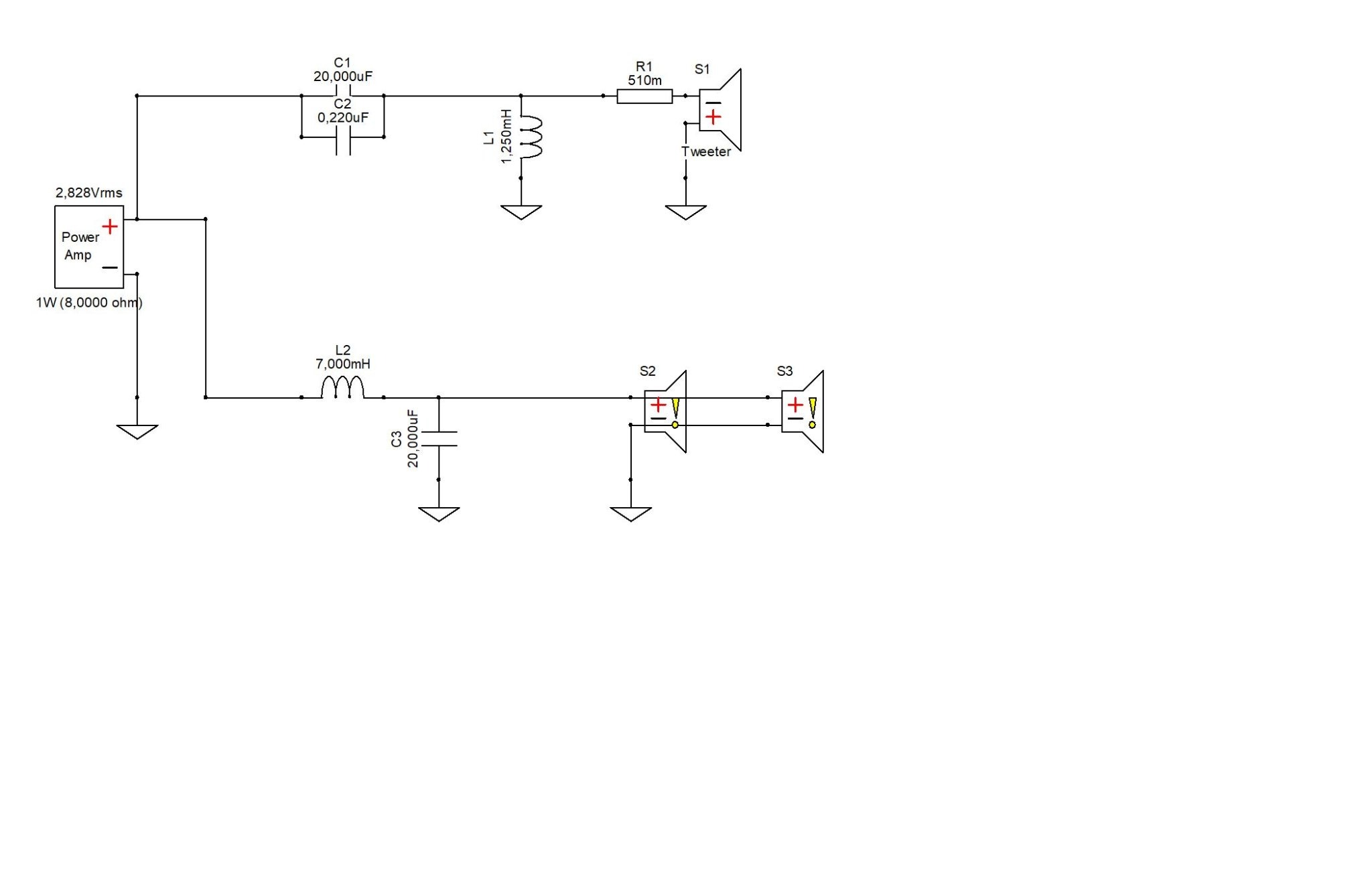

I am not understanding how the woofers can be 7mh for the 4 ohm load...isn't that like 90hz low pass?
Just read this thread. Yes, 2nd order 7mH and 20uF doesn't look like it ought to work. However if you were to shunt the coil with a resistor, maybe 9 to 12 ohms, it models very nicely. Is it possible there's a resistor hidden away somewhere in the Caladan woofer crossover, perhaps below the coil?

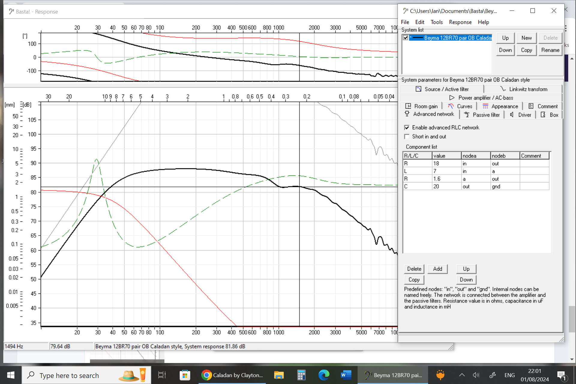

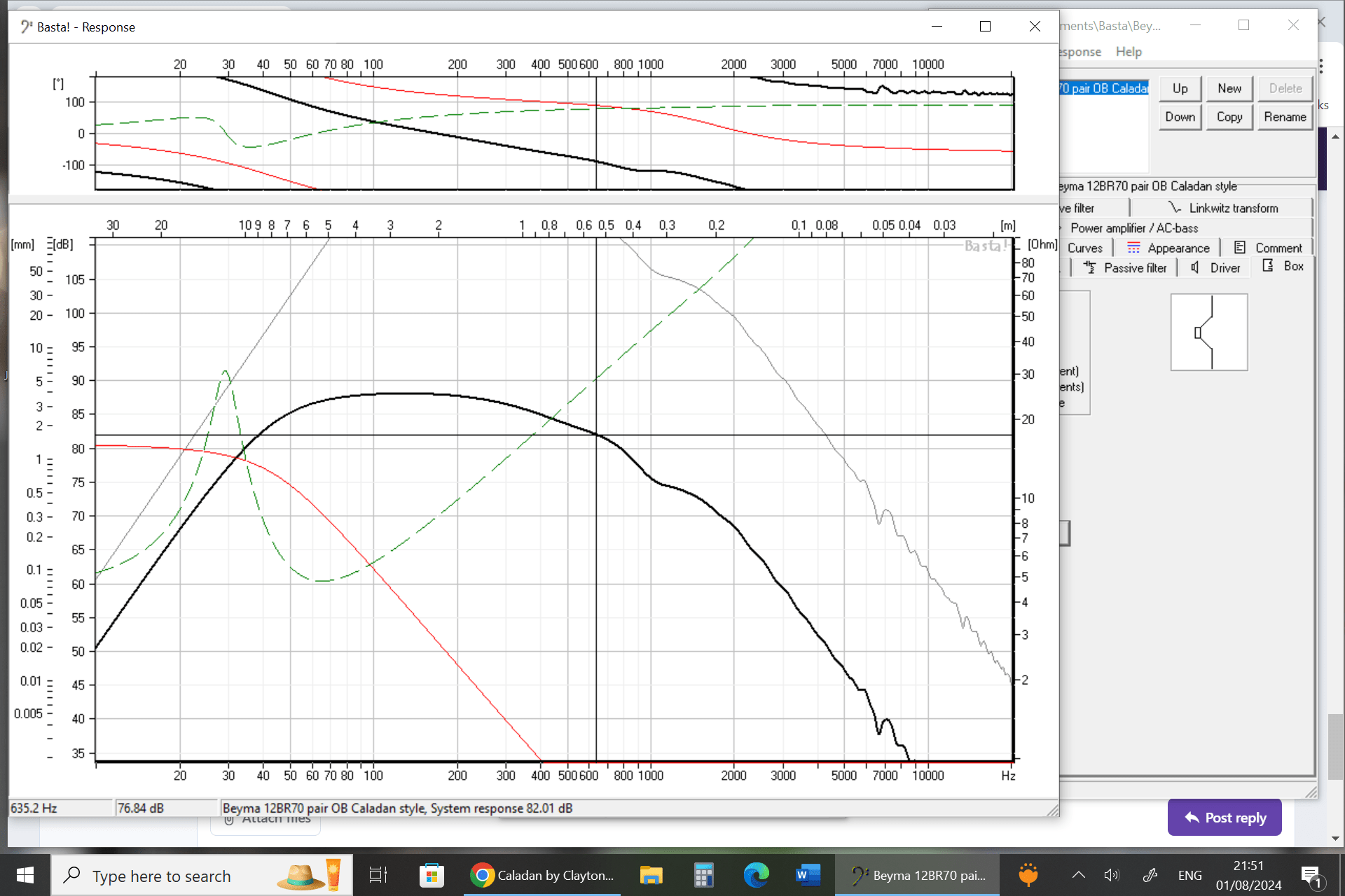

Just to illustrate what I said above, here's a sim of the Caladan woofers, based on the info earlier in the thread. Baffle is the correct size, inductor is 7mH, air core, 18 AWG (so 1.6 ohms DCR), cap is 20 uF.
Response is 6dB down at about 635 Hz, which is a long way short of a 1 kHz crossover.
Here's another sim with everything the same, except the coil is shunted by an 18 ohm resistor. Crossover point could be 1.5 kHz now. (Incidentally the dip around 1 kHz is a baffle effect. The little chamfer around the woofers may actually reduce this in practice.)
(PS In my earlier post, I guessed that a 9-12 ohm resistor would work well, but I was assuming that the coil had a DCR of about 0.6 ohms. However it looks as if the coil used in the Caladan actually has about 1.6 ohms DCR, so the shunt resistor probably needs to be bigger. )
Of course, my simulation is just a guess, and it doesn't take account of the real-world frequency behaviour of the drivers. Maybe the Beyma woofers have a rising response in the 600-1000 Hz band, which would offset the modelled droop? (The graph on the manufacturer's datasheet could be read that way, but the resolution on the vertical axis is so coarse it's hard to be sure.) The photos I've seen of the Caladan woofer crossover certainly don't show any sign of a shunting resistor.

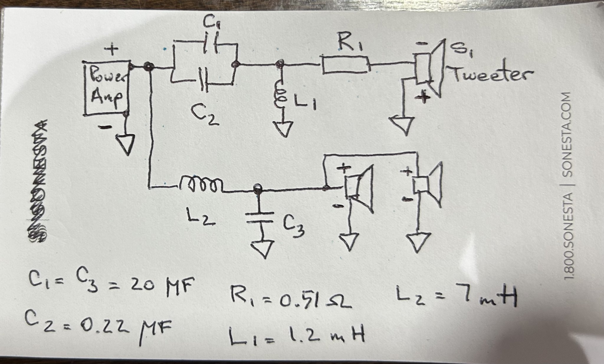

1 - is this the right crossover?
2 - Have anybody tried it with good results?
3 - what XO have anybody tried with good results?
If everything about your speaker is close to exactly the same as another person's, the you could copy their crossover, theoretically. But likely as not, something significant will be different.

This is the proper crossover design. The only thing I'm not 100% sure about is the 1.25mh coil. Maybe someone can measure an original pair of Caladans?
