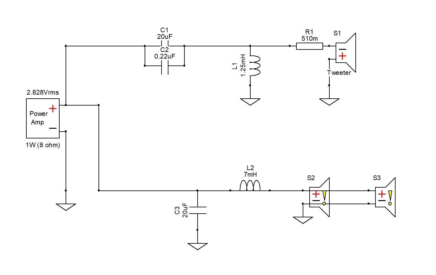

How do i parallel the caps to each other but the same time put them in series to the tweeter? And what does it do compared to the arrangement i had in my last post?
Yes like that, if you also exchange the position of the cap and the coil of the woofers it will be perfect.
How come there is two caps at the tweeter circuit? Could they be replaced with one 22uF capacitor instead? Jantzen have a 22uF caps. However, they are not cheap. But the Jupiter Wax ain't cheap either. Would there be a benefit?

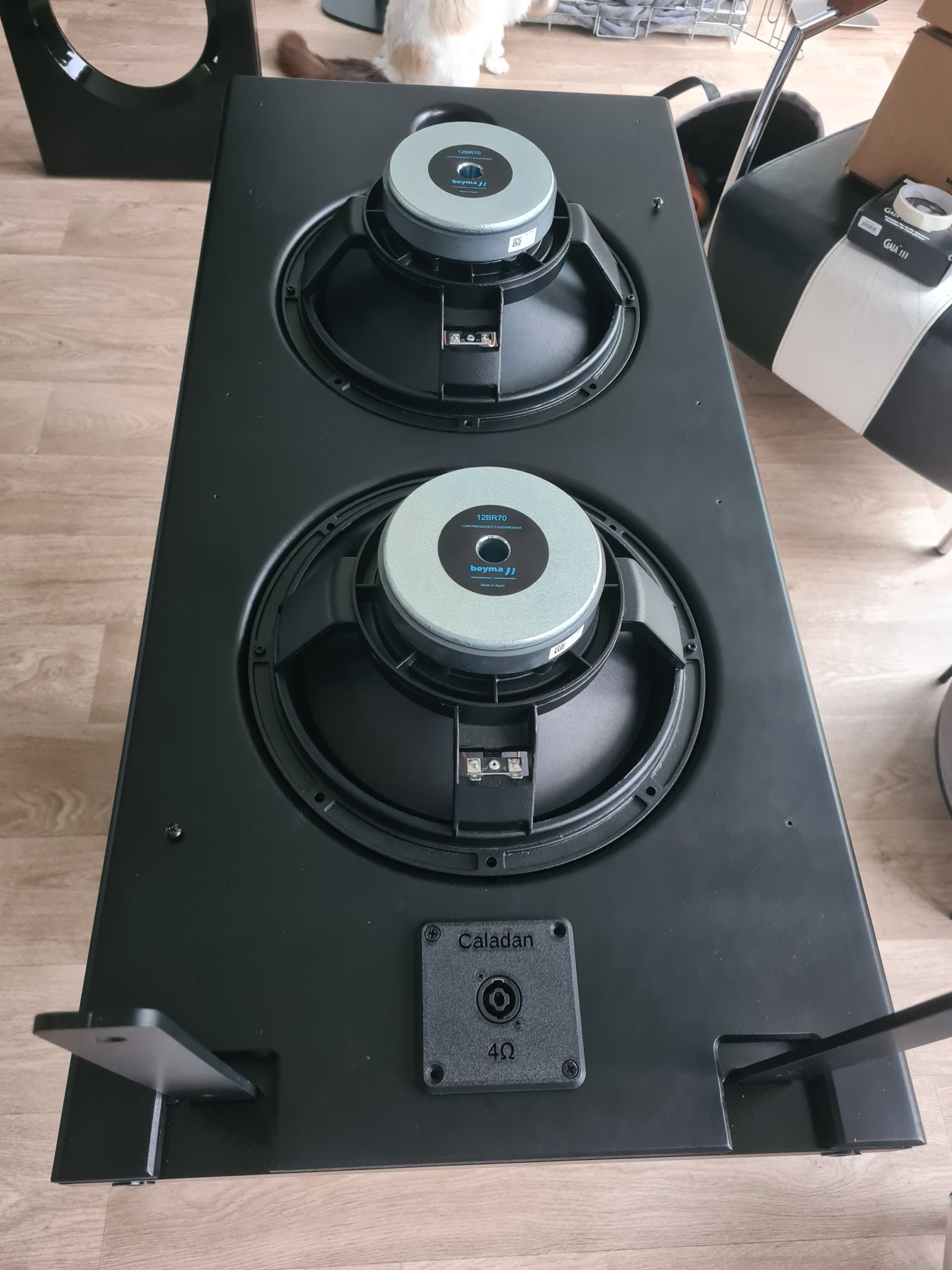

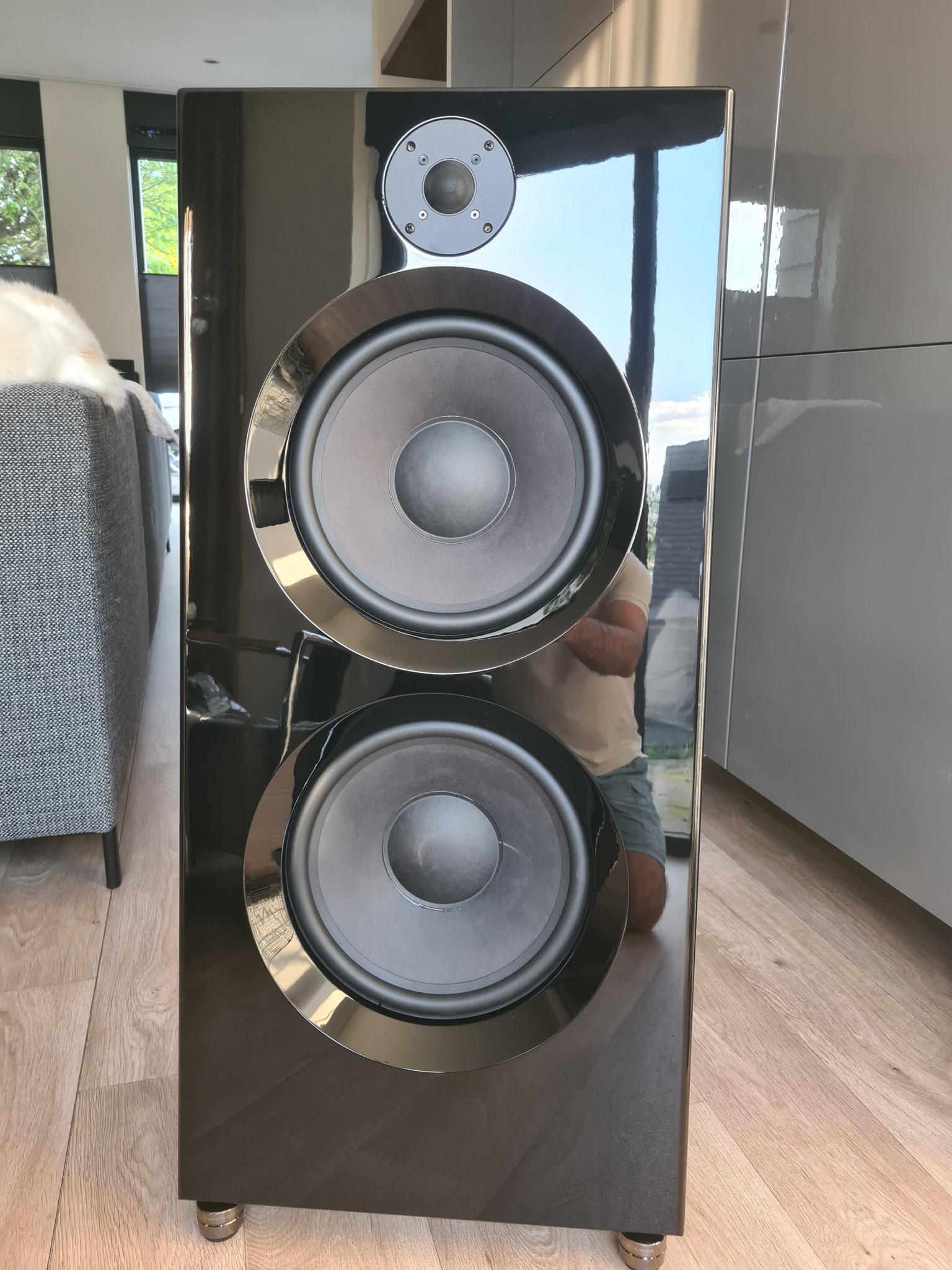

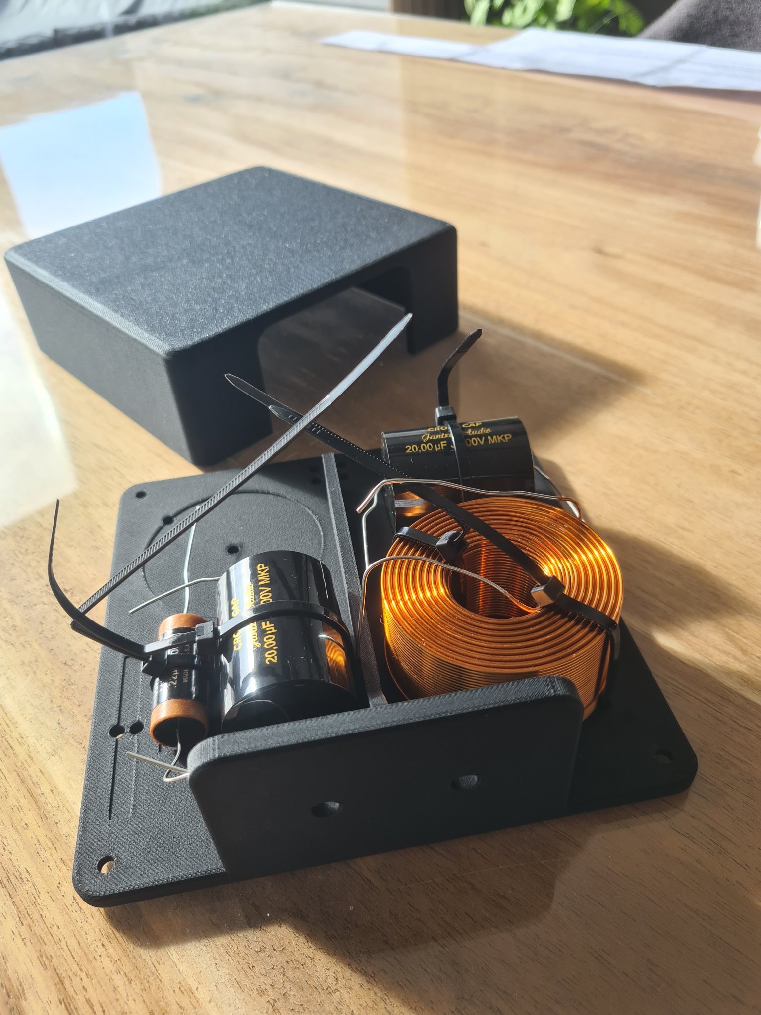

Building this speaker with the passive crossover and also possible to active minidsp crossover. Did nit like the crossover in the speaker itself so i printed an enclosure for it. And made an backplate for hiding the wiring.
I thought the Caladan Crossover was a series type, not parallel....maybe confusing this speaker with another Open Baffle type speaker
Building this speaker with the passive crossover and also possible to active minidsp crossover. Did nit like the crossover in the speaker itself so i printed an enclosure for it. And made an backplate for hiding the wiring. View attachment 1306640View attachment 1306641View attachment 1306644
I really really like your build. Please tell us how they sound.
