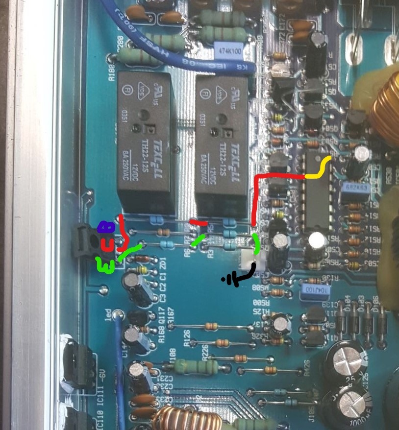

There is no driver board per say for the power supply. All the components are on the main board. I can get a better picture of that area if necessary.

What type of resistor are the blue ones with one blue band? They don't appear to provide any appreciable resistance when checked with the dmm? I pretty sure I have seen them in an image in the tutorial, but can't find them again.
Did you say that there was a resistor in series with the collector of Q1?

Blue band? A black band is the marking on a 0 ohm resistor. They are sometimes used as jumpers. In the Earthquake amps, they were used in the over-current protection circuit as shunt resistors.
Just the zero ohm resistors.

I'm not sure. I thought the voltage was coming from pin 11 of the 494.
One side of ZD1 is connected to the capacitor next to it and the 470 ohm R7 and the base of Q1.
I am reading over the protection circuit pages in the tutorial and I will disassemble the amp tomorrow and also trace the circuit more completely.
Thank you
Yes, my first thought was that the source of the voltage to the KD600 was pin 11 because it was labeled output. I figured that there was a source of input into the 494 and pin 11 and 8 were outputs as a result of that input, maybe Vcc? Maybe using a part of the 494 as a "regulator"? I am trying to learn, so I look at things and form hypotheses about what is going on, many times I am wrong, sometimes I get it right. It is obviously nice when I get it right, but I tend to learn more when I get it wrong at first.
After removing the board and following the traces on the bottom of the pcb, it was clear that pin 11 and 8 were sourced through a resistor in series connected to B+.
That resistor was labeled 2.2 ohms but read 888 ohms, which is were the voltage drop was occurring. I replaced the resistor with a new resistor marked 2.2 ohms now I am getting 12V to the input of the fan motor and everything is working properly.
