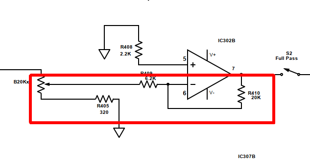

The output of IC301a and IC301b are identical.
The change in the amplitude of the input signal is occurring at the gain pot for Ch 4 (decreased). The attenuation does not occur if the pot is set to either full cw or full ccw, but is present at all points in between.
I have pulled the pot and put a 20K resistor in place of the Ch 4 pot and the attenuation still occurred across that resistor.
I also switched the pots, gang1 and gang2 and no change.
I can place a 10K resistor in parallel with R409 and get the signals on the output of IC302b and IC302a to match pretty close.
When doing the calculations for Vo of IC302, as originally built, with input of 1V both are very close, 3.198 V vs - 3.226V.
What in the gain pot could cause the attenuation of the signal between the output of IC301b and the output of the gain pot?
I have drawn the schematic of channels 3 and 4,attached below. Channels 1 and 2 are identical also with the identical problem i.e. Ch 2 and Ch 4 signals attenuated through the gain pot.
There is also a crossover circuit that is not shown, because the problem is occurring before that switch. I may add it in when I get time and post it incase, it might help someone in the future with repairing this type of amplifier as there are several amps, by different names, that appear to use this configuration on the pre-amp.

I have pulled all of those resistors and all are within spec.
Would you suggest just changing the value of R409, to manipulate the gain of the op amp to match outputs?
Changing the value of R409, doesn't explain why the calculated output and the output in practice do not align, but it does seem to at least compensate for the problem.

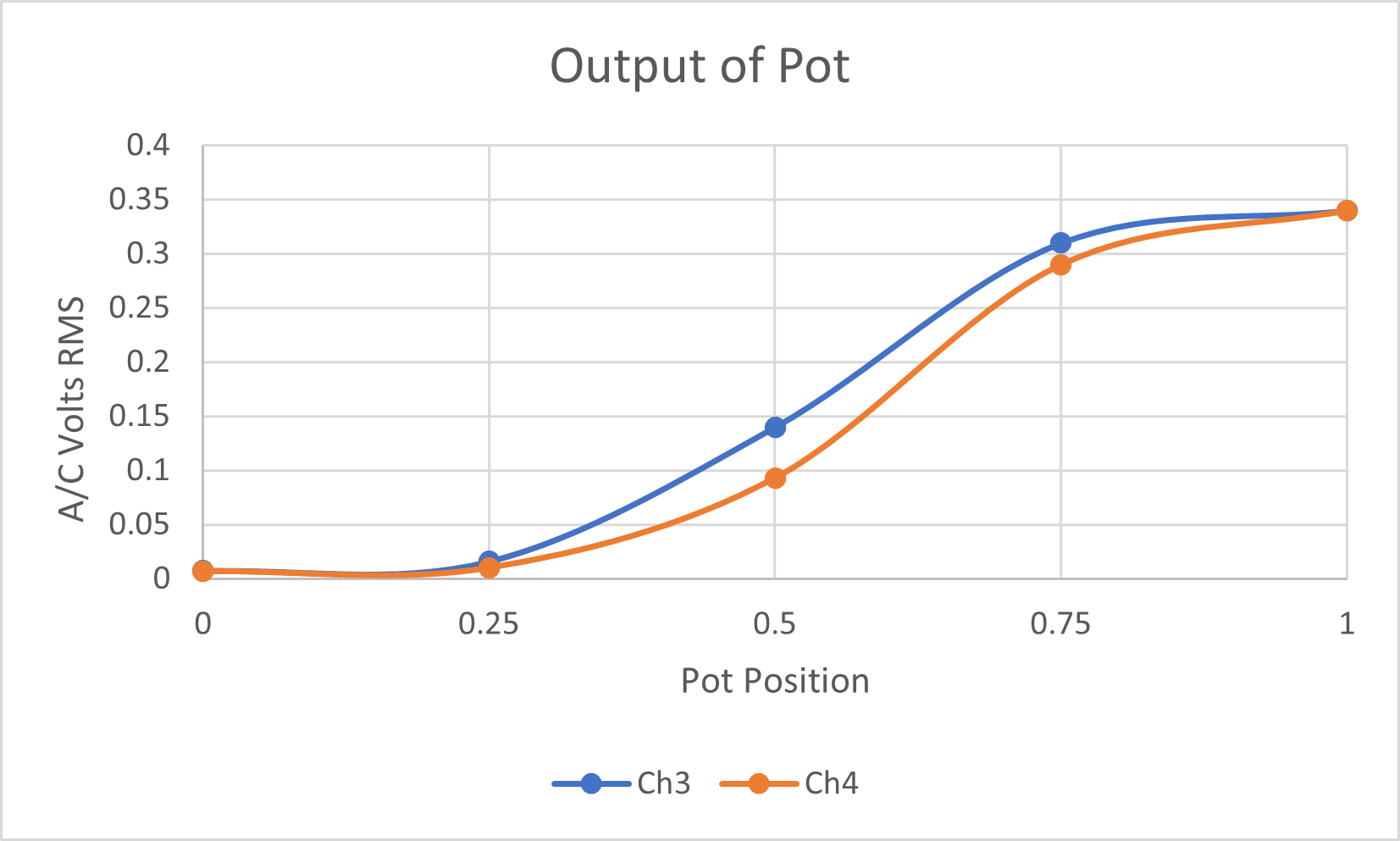

Taken at pins 1 (Ch 3) and 7 (Ch4) of IC302 using a DMM with secondary ground as reference.
Pot Full CCW: Ch 3: 0.05 Vpp, Ch 4: 0.05Vpp
Pot @ 1/2: Ch 3: 1.40 Vpp, Ch 4: 1.01 Vpp
Pot @ 3/4 (greatest difference): Ch 3: 2.54 Vpp, Ch 4: 1.91 Vpp
Pot Full CW: Ch 3: 3.11 Vpp, Ch 4: 3.11 Vpp
I thought that if I graphed the pot position vs output, that if both gangs were possibly different tapers it would show, but they both are trending the same.
Both signals match before entering the pot.
I also previously, disassembled and cleaned both gangs with DeoxIT D5.
Yes, as you mentioned, adding the resistor in parallel with R409, was only successful in matching the signals at 1/2 position of the pots.
