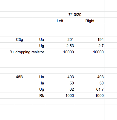

If you have 2 each C3g tubes that use LED (constant voltage) biasing . . .
then please, do not expect the tube voltages / currents to be the same.
Live with the different voltages / currents, Or . . .
Find better matched C3g tubes (real expensive);
Use a current sink to bias the C3g (and put a bypass cap across the current sink);
Or (real scary to some), use a self bias resistor with a bypass cap across it.
There are reasons why some designers use something different than LED biasing.
But your results are well within normal tube variations, stop worrying about it.
I would suggest that the slight difference of plate voltage and slight difference of plate current is lots less than most peoples 2 ears

voltage across the RC 10K resistor is approx: 200V and 190V. I ordered some new 10K power resistors (25W) and will install in 2 days.
I was using battery bias (-2.7V) and am going to go back to the LED bias shortly. FYI: with the measurements posted earlier today, the output voltage for a 120hz -12db sine wave is 2.2V and 2.4V (left and right monoblocks, respectively). So, about a 10% voltage difference at the OPT output.

That is a 1dB difference.

There is nothing wrong with the resistors. Ohms law will tell you one tube is drawing more current than the other. 6A3sUMMER is correct with his assessment of the led bias. The c3g tubes are not matched and bias differently with the same grid voltage.

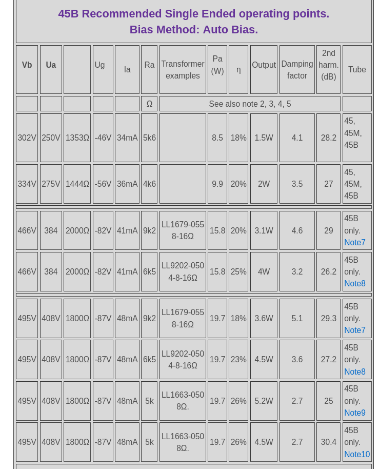

Please see load lines & operating points in the attached file. The yellow operating points are a result of Rk=1k. The blue operating points are Rk=1.5k. B+ = 398V.
I am unsure which is "better", as load lines and operating points are new to me. Both operating points appear to be moved to the "right" of the chart. Am I correct that the operating point should be roughly centered between the 0.0 bias and -100 bias?
To confuse me further, the EML website has operating points suggested in the response above from nicoch58.
