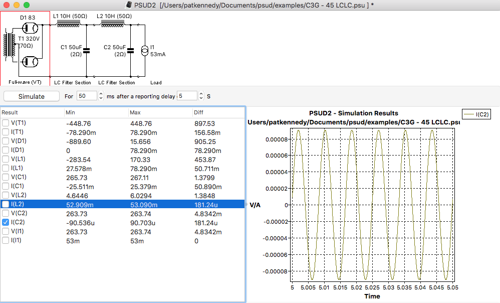

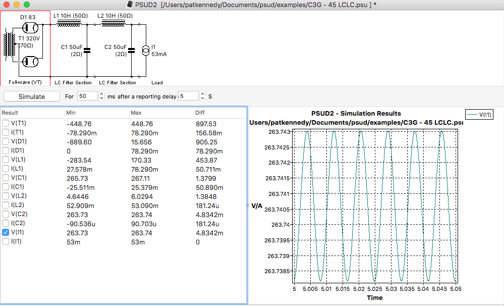

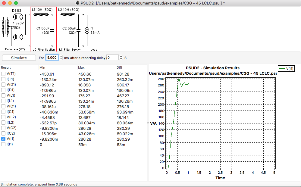

Ian,
The 450V B+ was without load.
Using PSUD, here is what we get:
320V secondary -> 5U4GB -> 10uf -> 10H -> 50uF
Ripple 84uV p-p
B+ 387V
I am leaning towards a 274B rectifier at this point. I have a 5U4GB in stock, so currently using it for my breadboard. I also have a 274B Sophia Electric Aqua which permits C1 <= 40uF.
My bleed resistors are 5W, 330K and working OK from a voltage drainage standpoint.
Pat

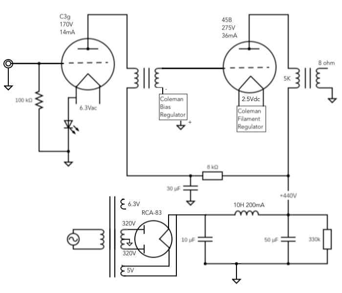

Team - progress. Please see the latest schematic, v3.0. I decided the following:
1. Using Rod Coleman DC heater regulators on output tube.
2. Using Rod Coleman Fix Bias regulators on output tube.
3. For this first iteration, I will use the EML 45B. This will allow me to play with higher plate voltages and current.
4. CLC power supply, for now. Later iterations will likely move to LCLC.
Thank you, everyone, for your help. If you see any glaring errors, please let me know.
This regulator is shunt type. Connect regulator -negative- output (positive is on ground) to IT secondary "lower" point (instead of Gnd) without any resistor.

banpuku,
Power Supply:
For the type 83 mercury rectifier, your schematic in Post # 65 is missing 3 parts . . .
A switch from the center tap of the B+ secondary to ground (Wait until the 83 filaments warm up the Mercury, before closing the switch from the center tap to ground).
And, when you turn the amp off, be sure to return the center tap switch to the Open position.
Otherwise, the next time you turn the amp on, the tube may arc or explode.
And,
Then there is another problem with using an 83 mercury rectifier.
Suppose your amp is on, and then the power mains goes out. Your center tap switch is closed. When the power mains goes back on, the mercury is not warmed up . . . and you get either arcing or an explosion.
You need two 56 Ohm resistors. Put one in series with each plate of the 83 from its respective high voltage secondary winding.
Yes, I do plan on having a separate switch for the filaments (including the 83) and the B+.

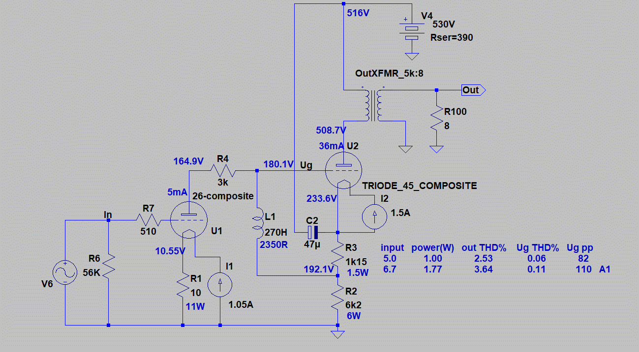

> If you run those old 1.2 Amp tube filaments from a 1.5 Amp current source, the tube life will be very shortened.
This is true!
But one might hope there are no filament supplies out there with fixed-current output. This would be wrong for almost every case (with exceptions for WE101D, WE102D etc and STC 3A/109-series which are designed to be heated by a specific current).
Current-driven heating is correctly implemented for voltage-specified filaments, when the current can be adjusted (or servoed) to the correct filament voltage, as closely as possible.
Thanks, Bela. This is exactly how it should be done.

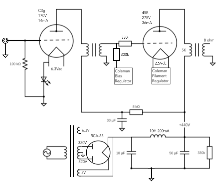

Please see attached and confirm / comment changes for the bias regulator. Thanks!

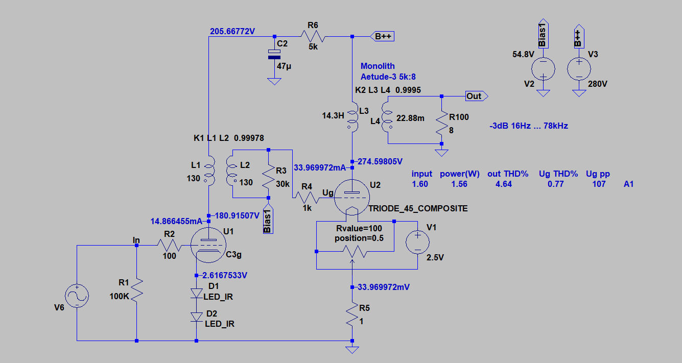

In euro21's post # 68, the 45's filament supply in the schematic was listed as a 1.5A current source.
That is the kind of thing that beginners do not know, but need to be advised of.
In my post, I should have referred to the schematic in post # 68 as having a possible problem
(for those 1.2 Amp 45 tubes).

It's okay. I did not read it as an accusation! But actually, I have seen a number of commentators writing that current-drive supplies are "bad" for this same reason; and an explanation will not hurt.
Euro21s post is an LTSPICE screenshot, so the nominal current would be expected.
Rod C.
Thanks for the education. I have never used LTSPICE. They need to improve the labels to have a little more info. I know, that makes for more space, and a larger schematic.
I am an analog guy.
For example, I do my own calculations for B+ and DC filament supplies.
Calculate resonances of CLC, ripple, DC voltage, supply impedance, etc.
Decades ago, a couple of us got caught by the resonance in a CLC supply.
Similar to an RF pi filter in a transmitter, it resonated at low audio frequencies.
The scope display was nothing short of hilarious! LOL

Looking to move towards a LCLC instead of a CLC. Here are the PSUD results. As this is my first time using PSUD, I need your input on whether or not these results look good.
4.8mV p-p ripple
181uV p-p ripple
Thoughts?
4.8mV p-p ripple
181uV p-p ripple
Thoughts?
