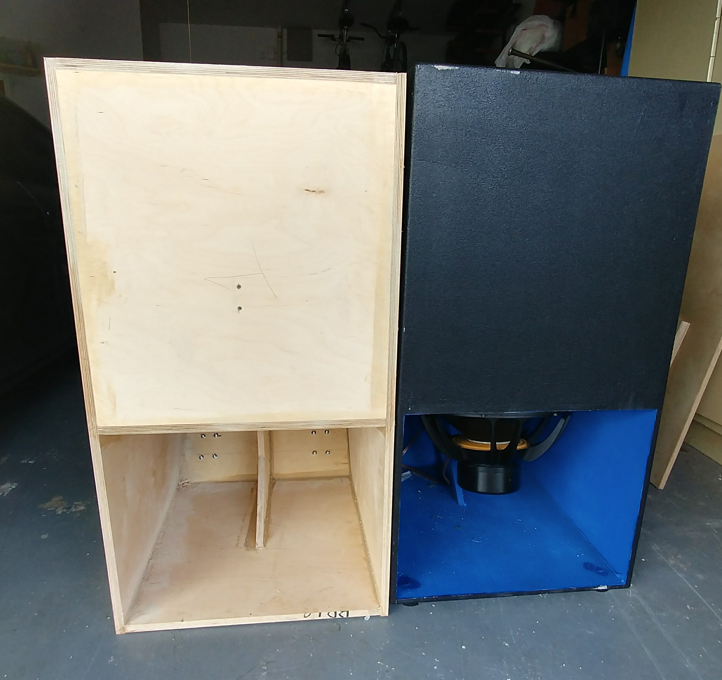

Does anyone have any measurements for this build? Or perhaps the hornresp inputs?
I am starting to build a second enclosure of that epa version thay crescendo,built, and a friend has let me botrow a measurement mic, so stay tuned I will eventually have measurements.
Great stuff, did you ever model this in hornresp?
I did not model it myself. I had built another tapped horn (20Hz using lab12 for my HT) and really like the sound. Decided I wanted a PA system again....was going to build a couple PAL12 enclosures but stumbled across a great deal on an 18sw115, so I bought it and searched this forum for a while...found this enclosure and read about how much Crescendo liked it. Didnt seem too hard to build so I went for it. I am very happy with it so figured I would build another. Just got another driver for my birthday (my wife loves me) and picked up some baltic birch a week and a half ago. Hopefully will get some time to start making wood chips today!

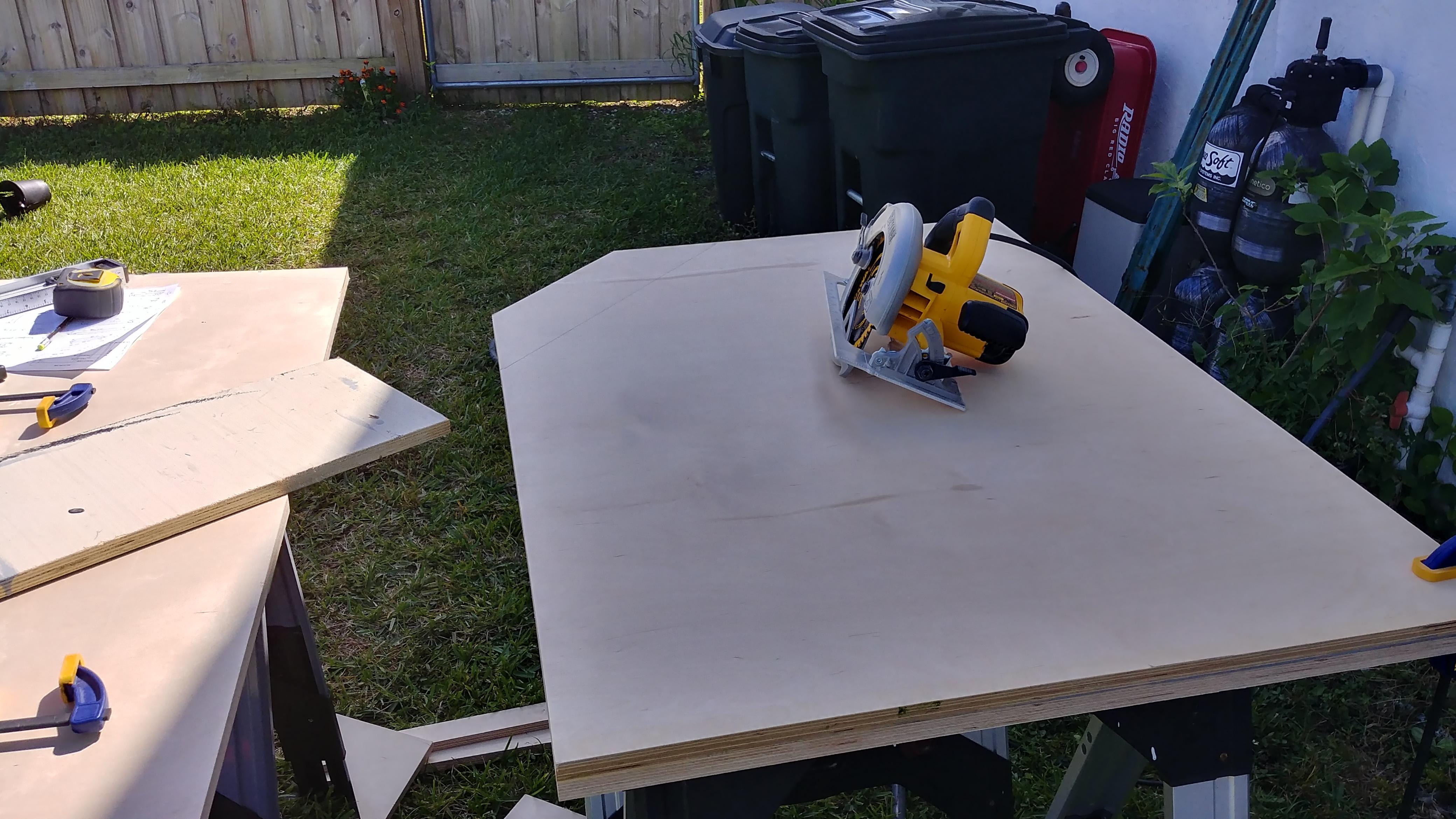

Ok not the most exciting build pic, but the sides, top, and top rear deflector are cut. My cut time coincides with my son's nap time on weekends...so incremental progress until the panels are all cut. Assembly/paint/etc can be done in the garage after he goes to bed.

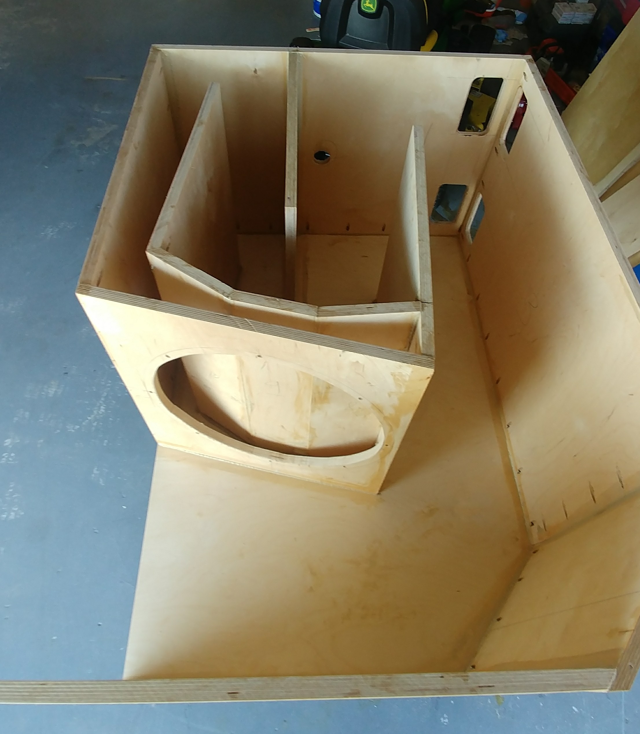

Cut hole in driver panel, holes for handles, and added roundoffs to the handle holes. Assembly to commence today.

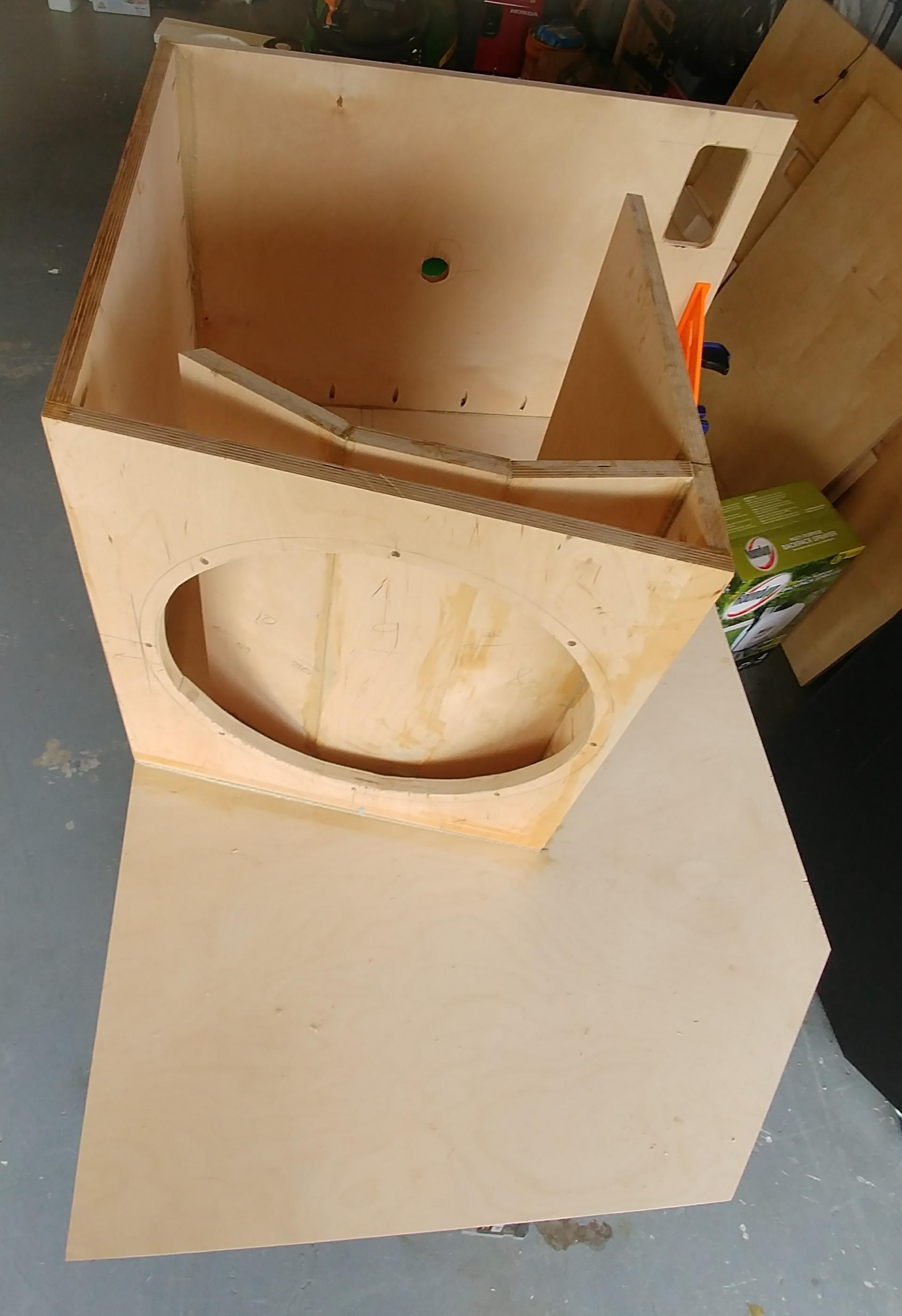

Had a tube of PL premium on hand so I laid out the plan on the sides and started the assembly process. Going well thus far!

More progress. Bracing, corner panel, side panel, finishing next.
