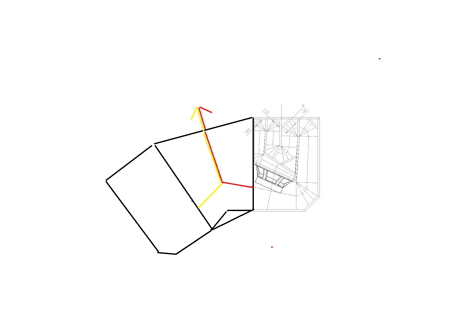

Jo, if I were you I would try experimenting with your pair of XOC1 first. I am baffled these are not popular... This requires running cabs on their side. Firstly, you gain at least 3db simply by arranging the cabs into a v and adding a top or v plate. Then if you take the concept further and honestly this is part I am very interested in is create a w plate arrangement where a horn extension is created and then ultimately shared by both cabinets. This effectively lengthens horn path and lowers LF response of the system. The round numbers I ran indicate a potential towards 10Hz lower with 45" tall cabs. Lower and louder with just some plywood. 😱 I think they are also wicked cool looking myself. Very cheesy paint drawing made so you get the idea.
I think Justin could also apply the technique with his beasts but he might need to employ a structural engineer to consult prior to each of his gigs. Nice build!

Hi Zwiller,
You should be able to get an idea of the response using the TH1 feature in Hornresp.
Oliver,
I would be immensely appreciate any guidance to do that. Am I correct, that when trying to model I would be modeling the "system" and to do that I will need to lose a segment/combine 2 existing segments together? Make S5, S4 and then add the lengths together so I can add the new final segment/shared horn? Then set TH1 to 2? Tried that but not pretty so I must not be correct but it is much louder and lower 😀
Hornresp - TH - TH1 -Extender
Hi Zwiller,
I think you are basically correct, here is what I did:
1. file name: TH1T_org - pick a TH simulation (this was a SS15/xoc1 style for the 18TBX100)
2. file name: TH1T_th1 - change from TH to TH1 (using EXP instead of PAR was closer in volume)
3. file name: TH1T_2x - double drivers/areas
4. file name: TH1T_2xE - add extender
Hope this helps,

Art, Zwiller
thanks for your inputs!
that's 6 xoc1 cabs in the same space of 4 of these, so there is a defininte size advantage, and more spl vs truck space... i think i'll stay with xoc1 th18.
For what we play probably i would be the only one missing that few hertz extension.
zwiller i was already looking at building some welter style barn doors, go on and publish your findings please - i'm reading don keele white papers and slowly grasping some horn theory, but i'm not confident enough to do akbak/hornresp work yet.
