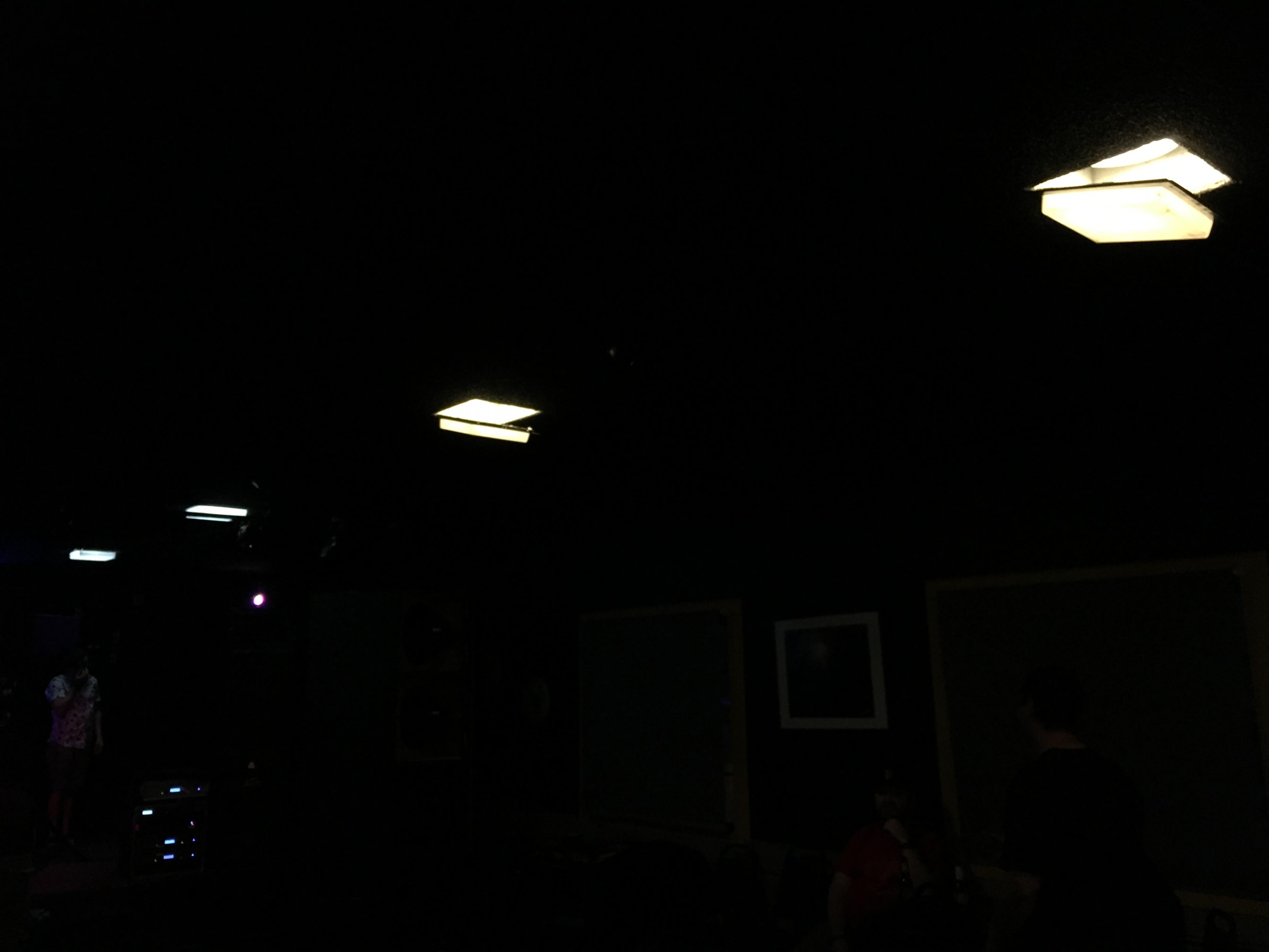

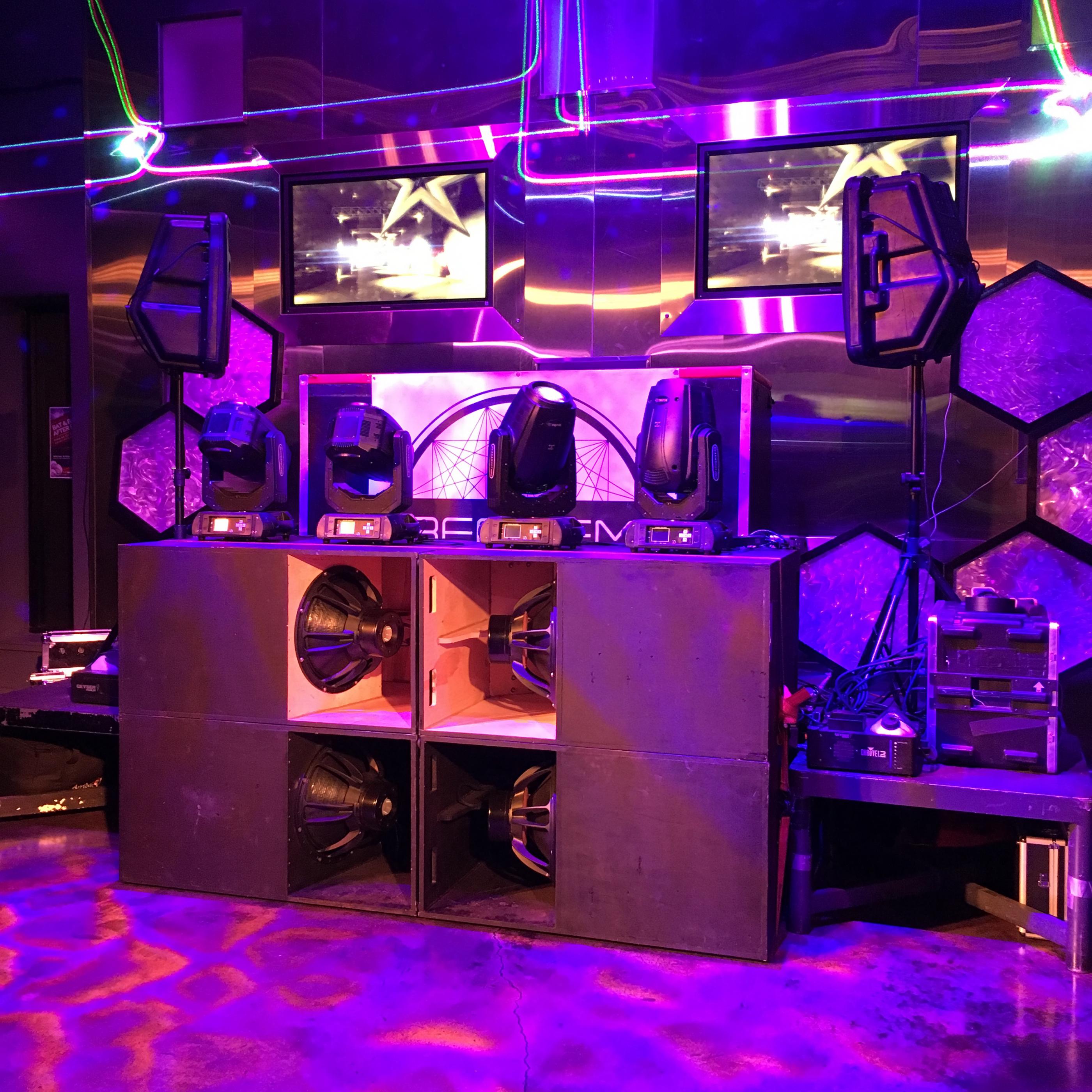

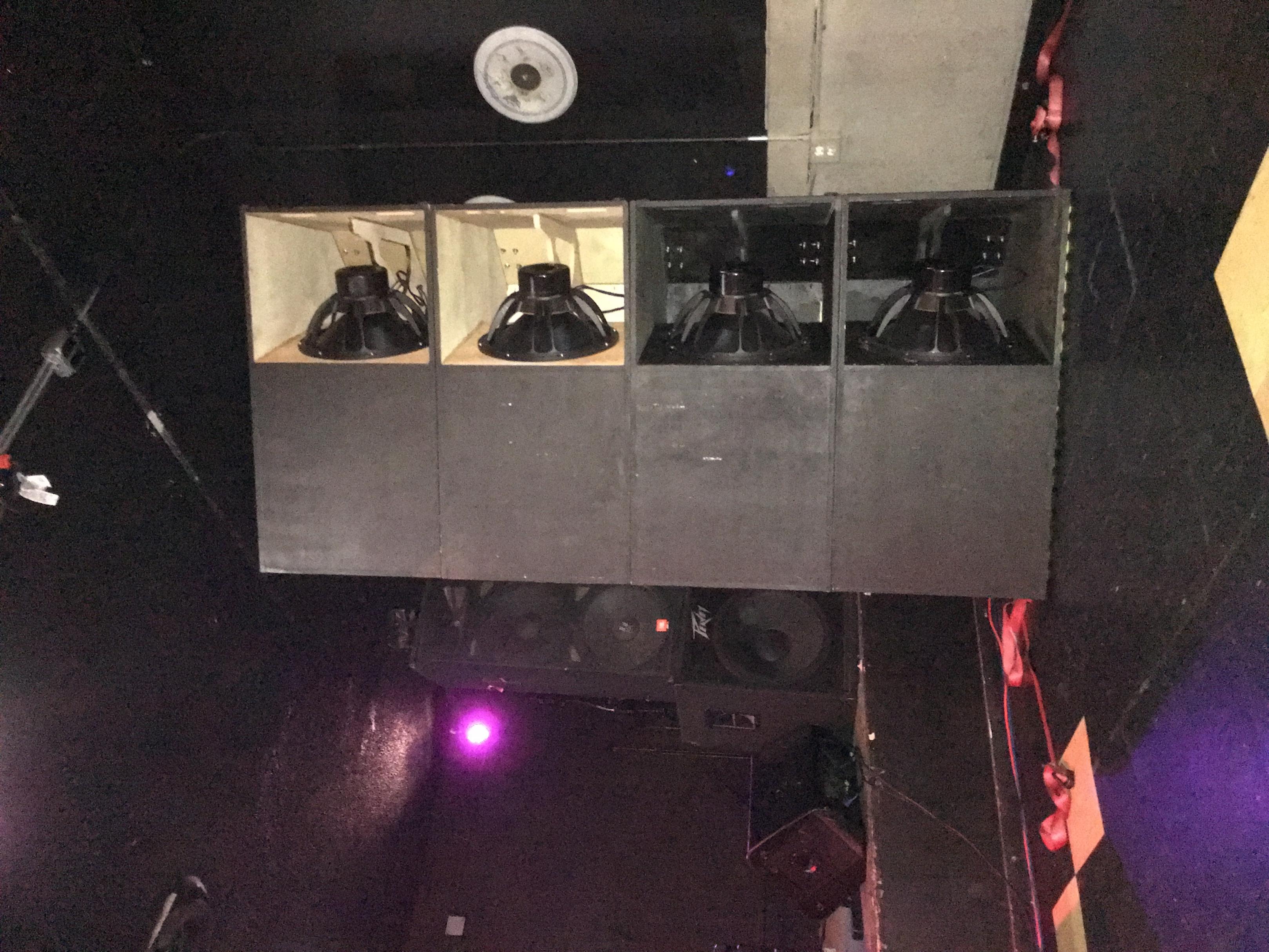

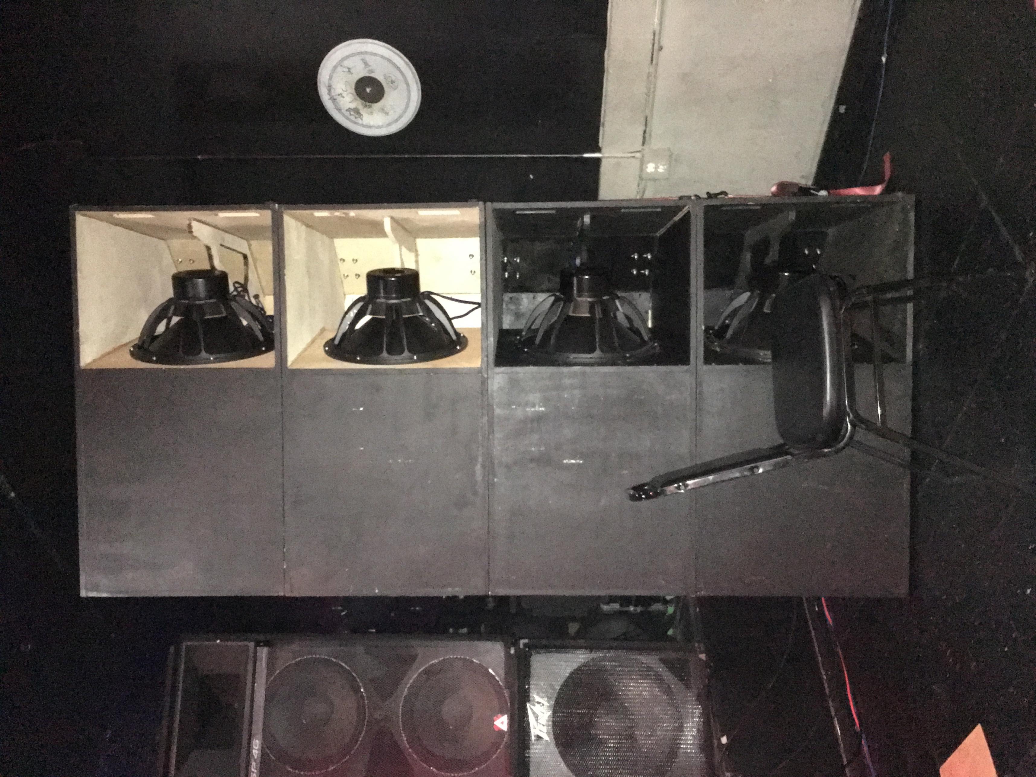

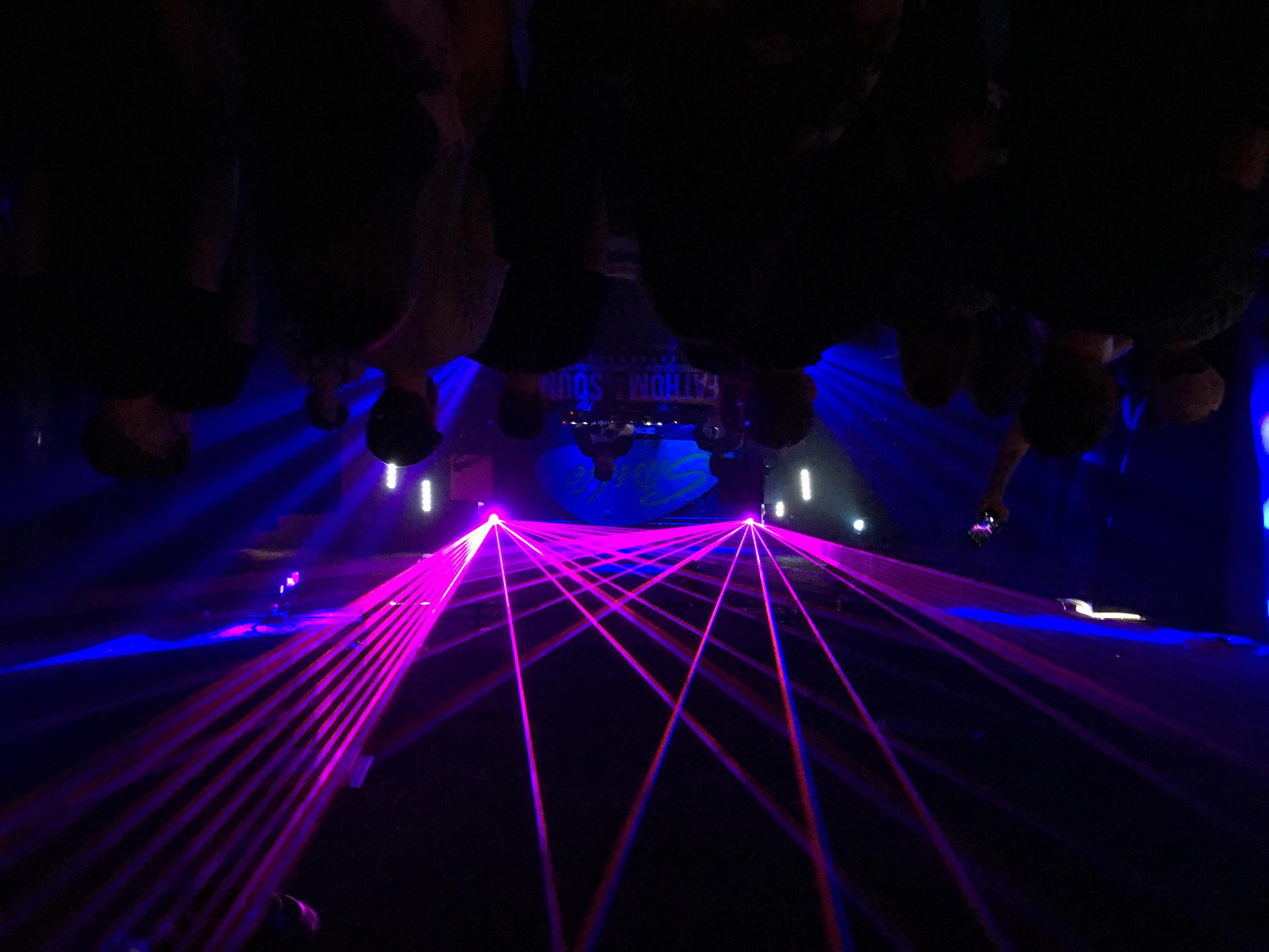

We went with this 4-high stack (first picture; second picture shows a chair for scale). Rattled light fixtures loose after a quick soundcheck (third picture). They duct taped them shut. About mid-show, the tape could no longer hold. Other guests were laughing at their hats vibrating on their heads or how their nose hairs kept tickling. Even at the back of the room (fourth picture), pressures were happily intense. You can get a pretty clear idea of room size with the last photo (taken from the stage). The venue's sound guy & bartender admitted they had never heard or felt sound like that before. It was clean and effortless low-end - didn't have to run them near their limits either. I loved the total-body-massage experience. Feet, legs, chest. It was serious. Unforgettable.

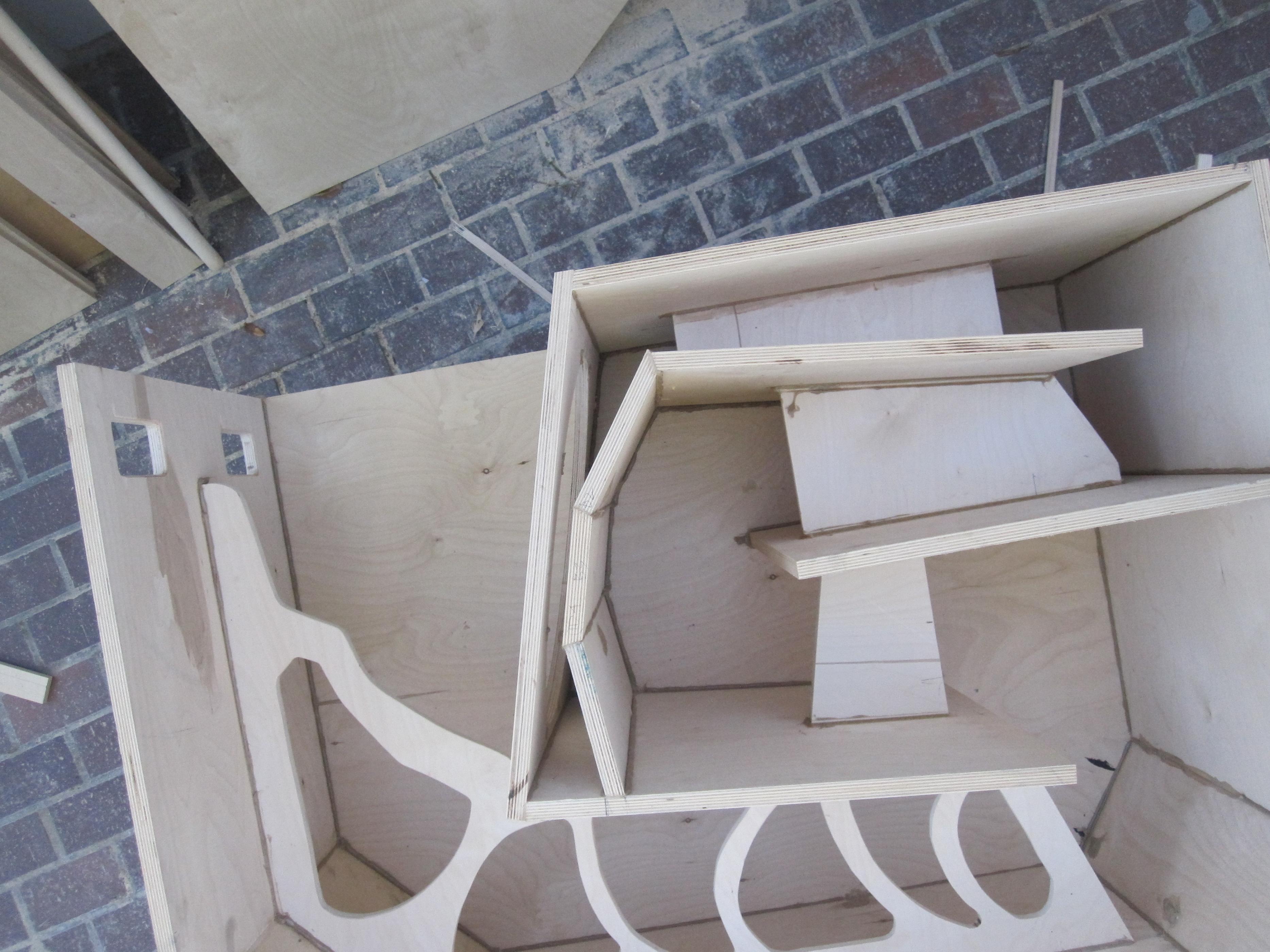

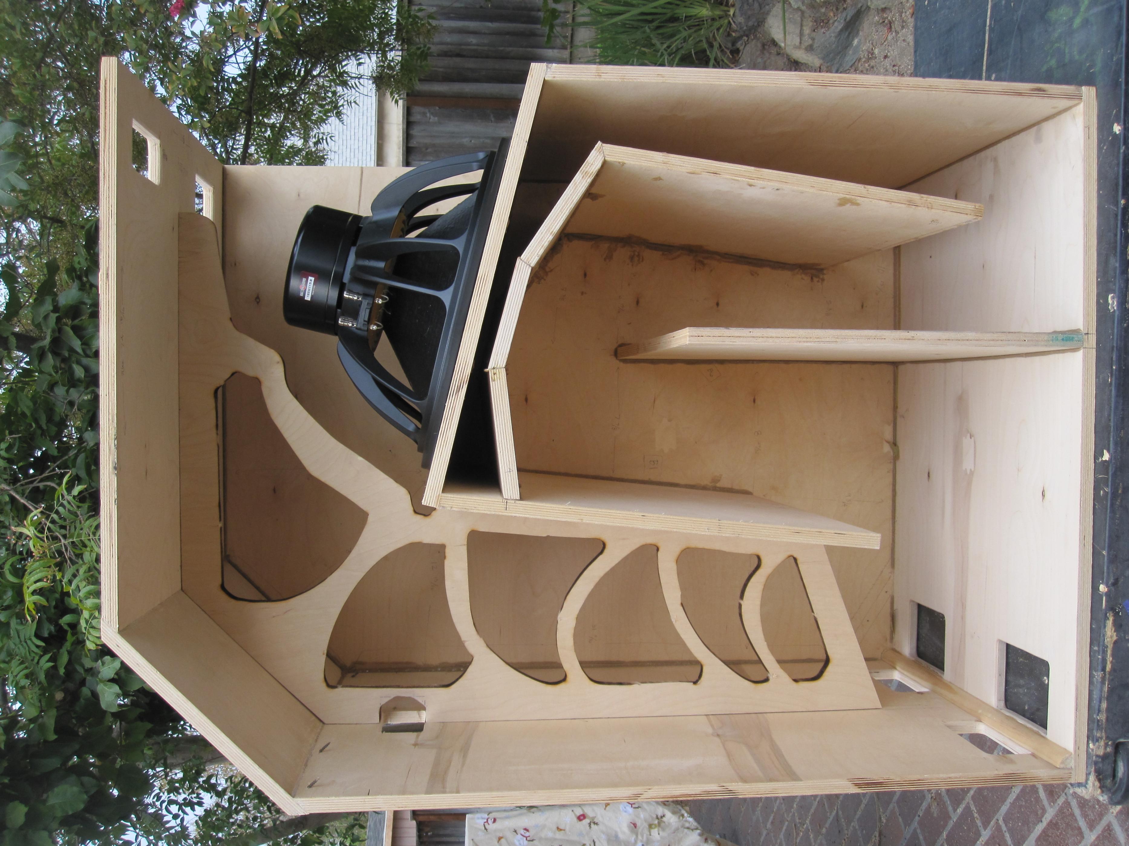

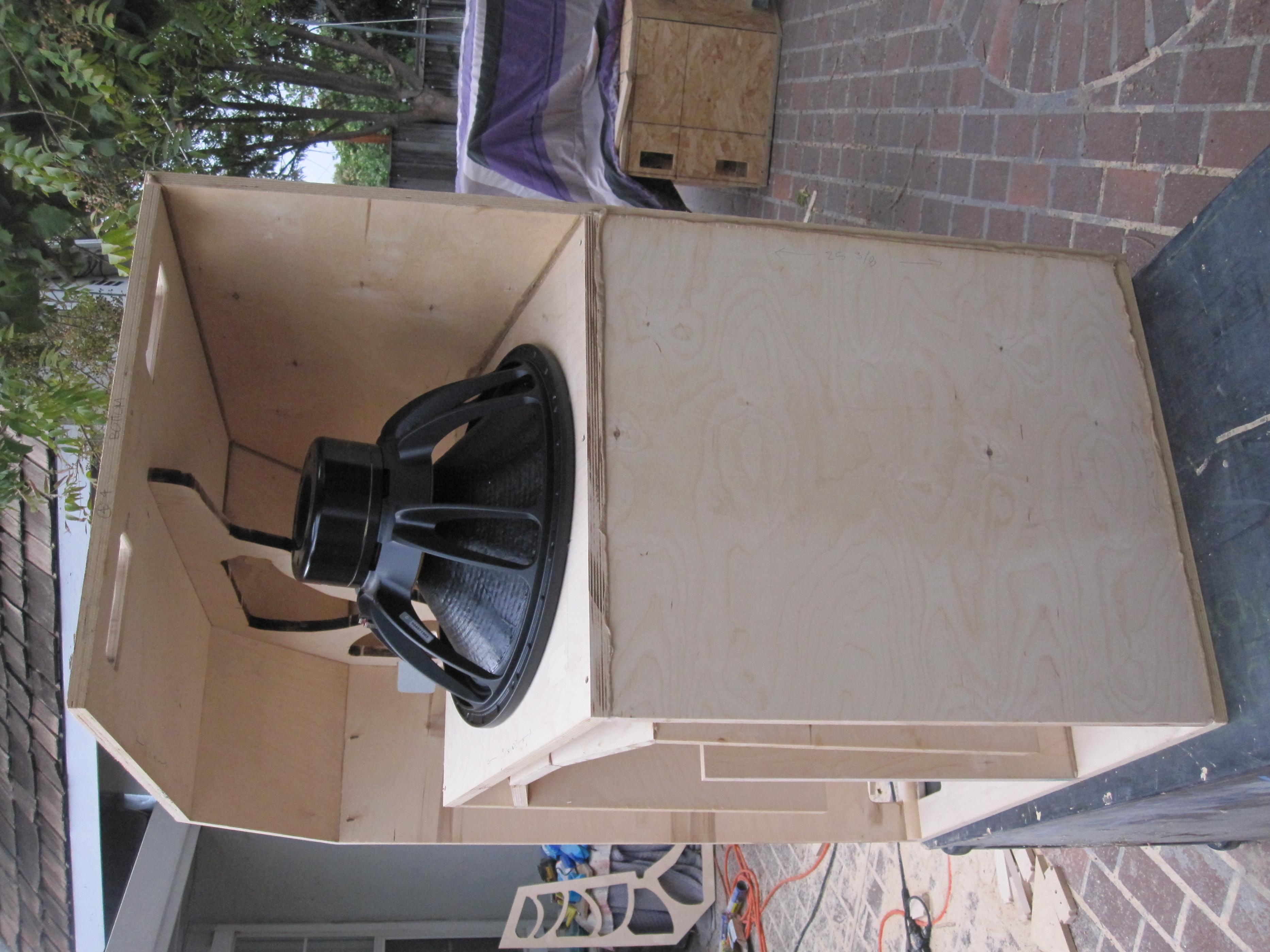

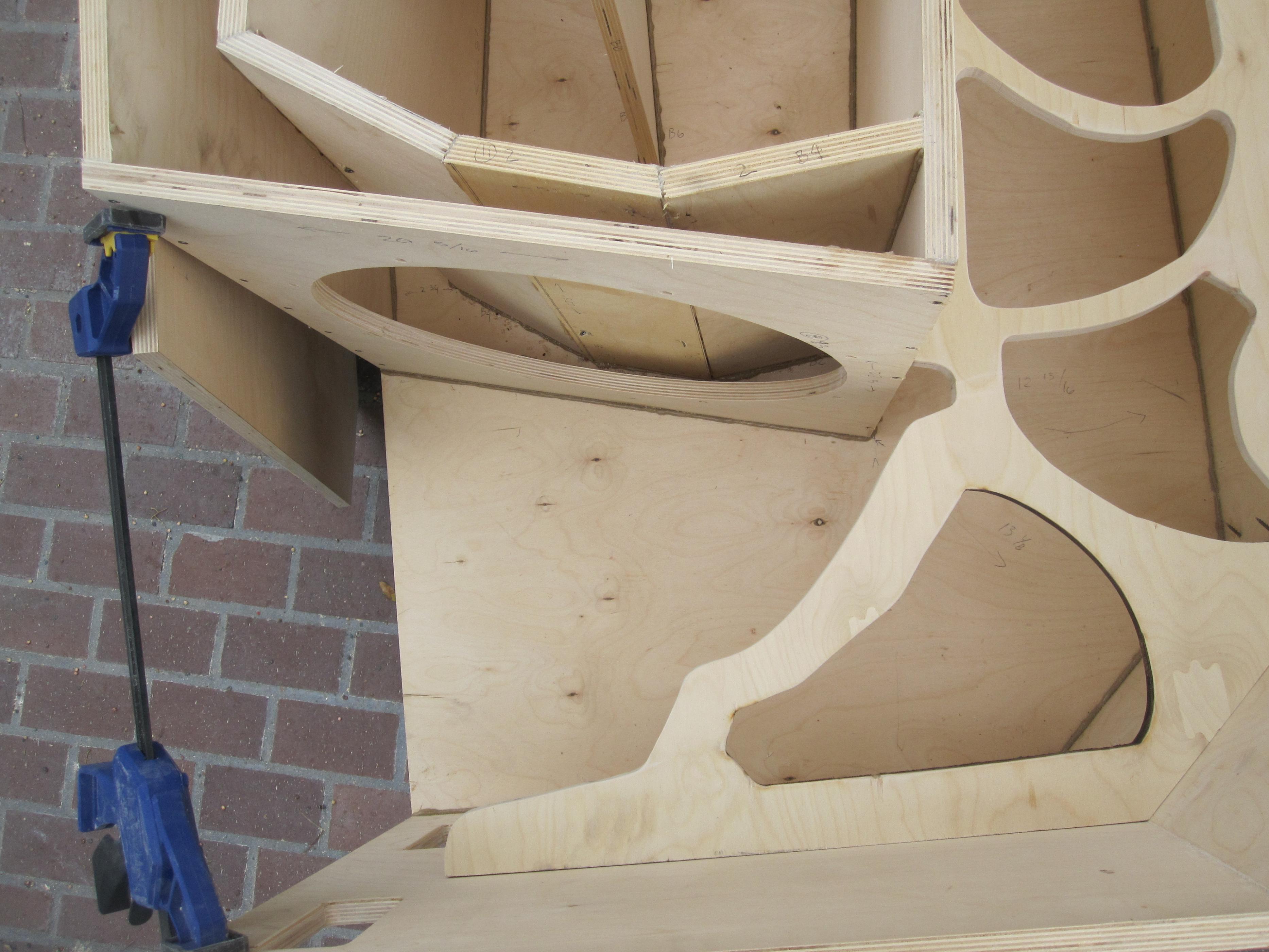

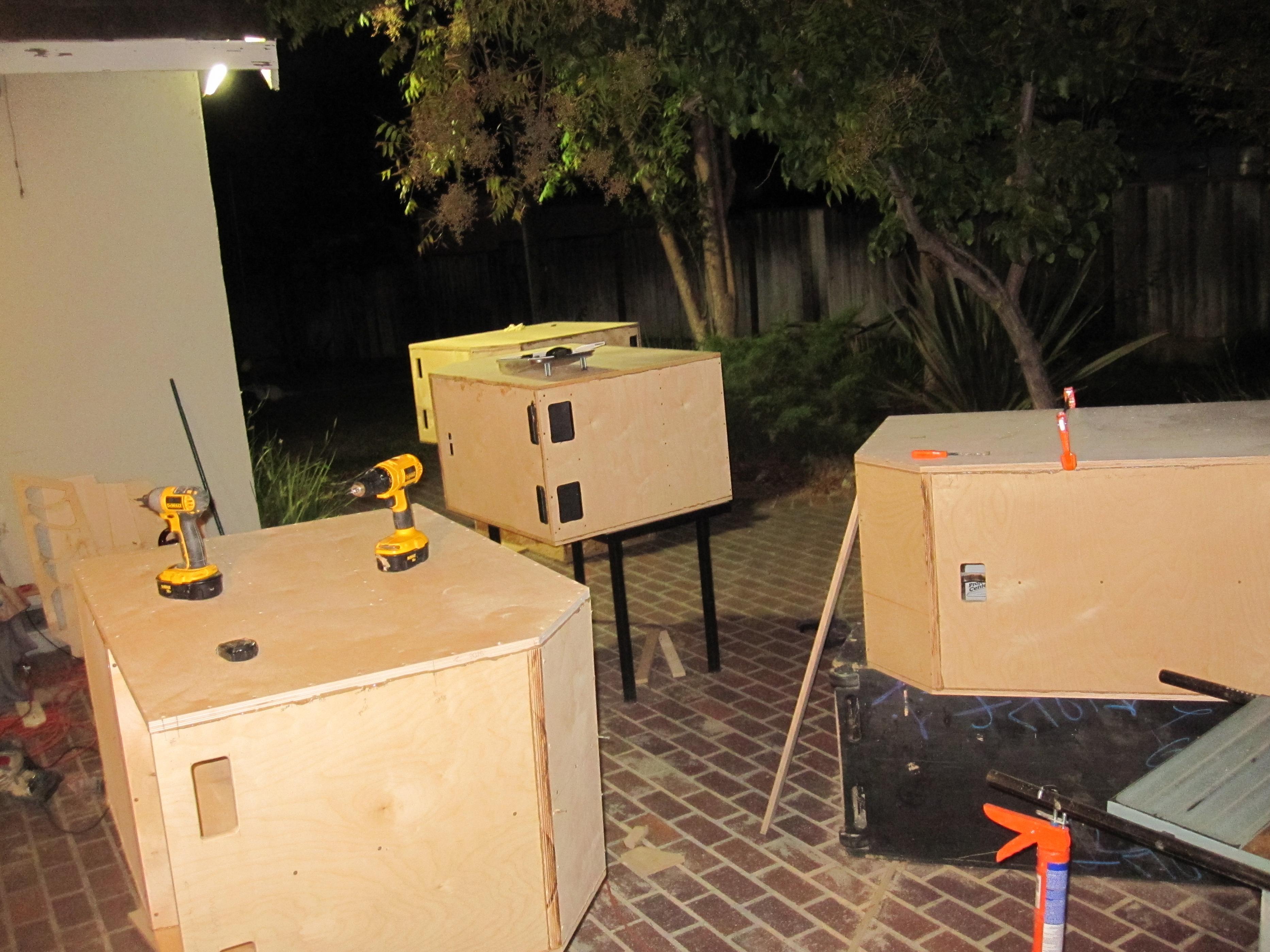

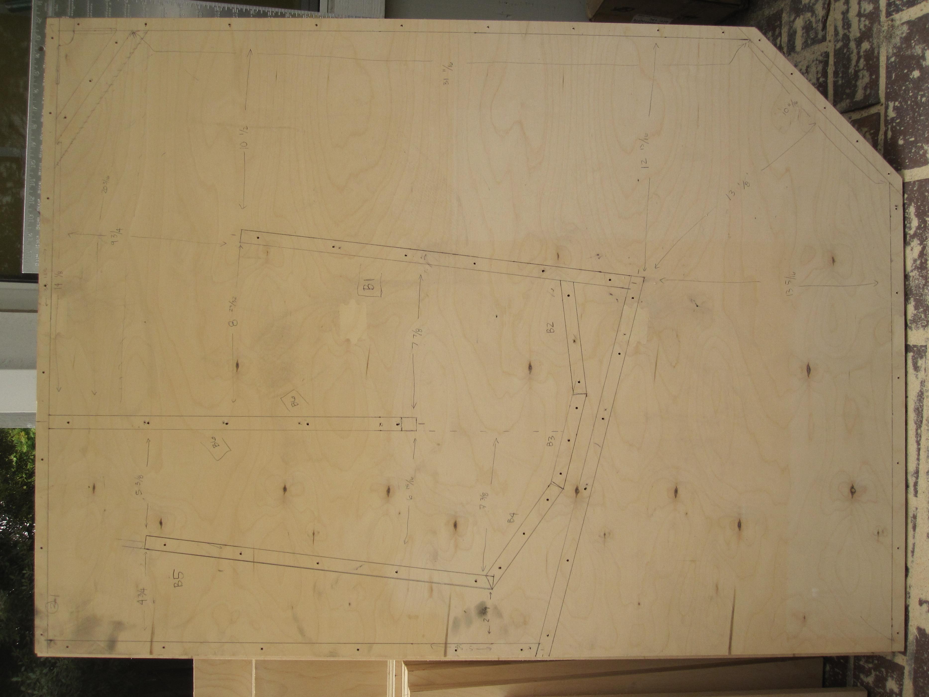

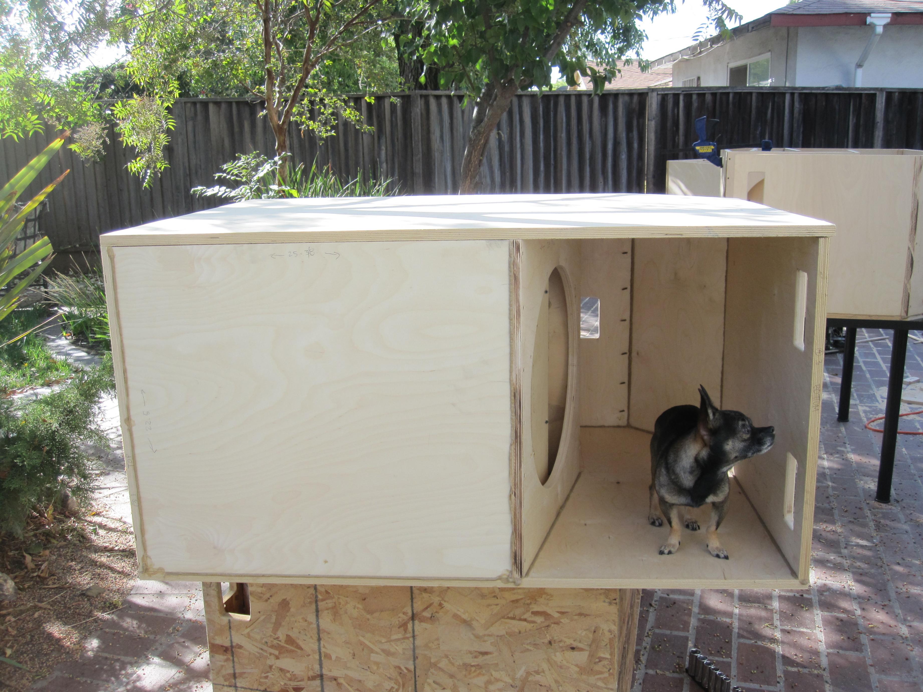

My most recent post prior to this page was Post #775, showing some internal pictures. Epa posted the CAD files in Post #773.
He includes bracing info in his post, which he setup really nice for CNC. I just made bracing of my own as I moved along. The only brace I made cut-outs for (aka hollowed out) was the largest brace, visible in the mouth. I'll attach a few more photos here.

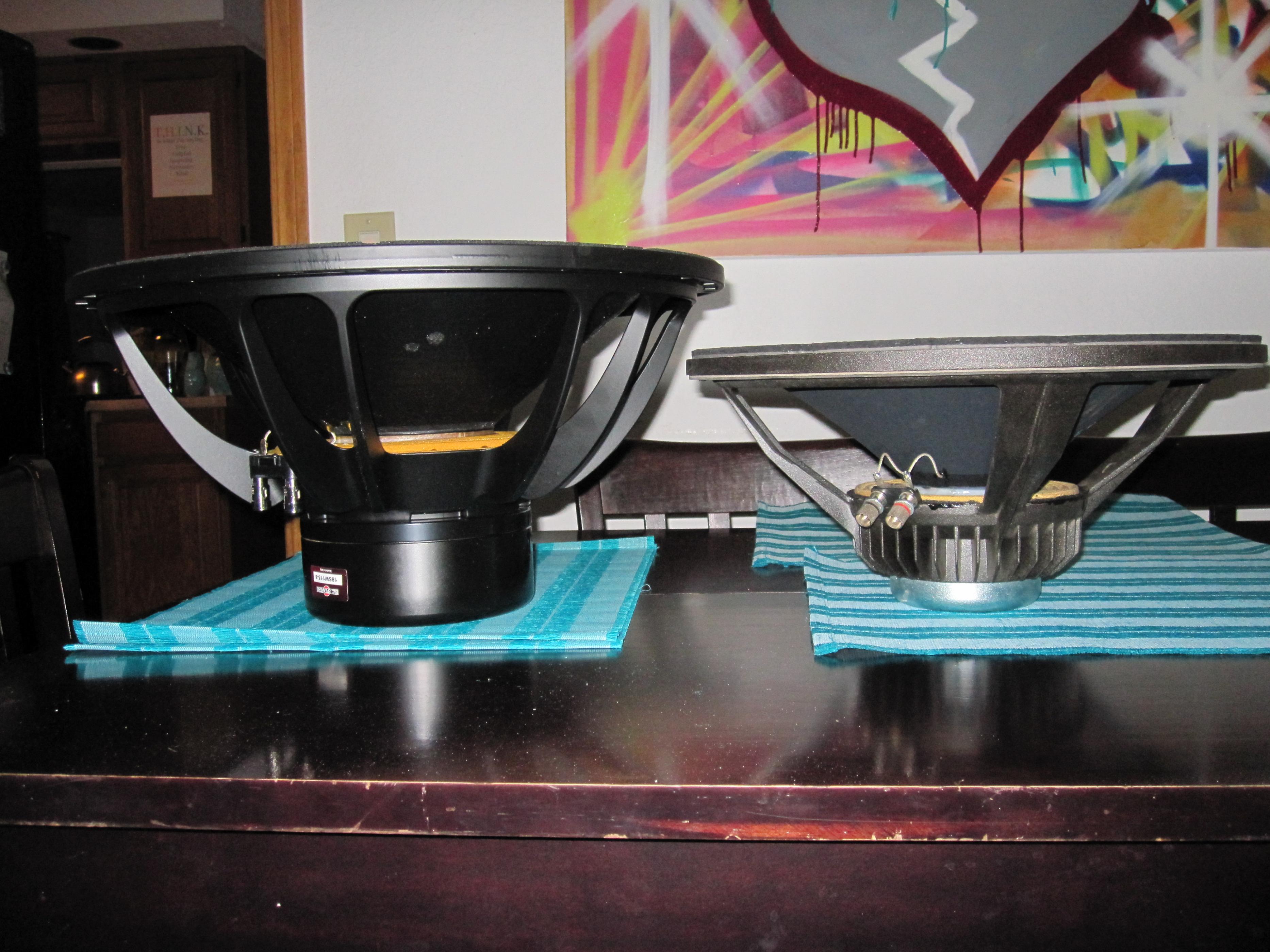

I'm using the 18SW115-8. Powering them with a QSC PL380 (stereo, approx 1500W available to each driver) and a Crown XTi6002 (bridged). I hate the signal lights on the XTi (they react slowly, they're all the same color (exc for clip) and the markings are not easily visible), so that's one reason I'm using the PL380 in stereo mode - their gains are matched, so I use the PL380 signal lights as a reference for the bridged 6002. The other reason is damping factor stays up with 8 ohm loads and short (9-10') 12AWG speaker cable runs, so I wanted to experiment with that as well (as I had been using longer cable runs and bridged amplifiers before, which lowers damping factor significantly (the long speaker cables & lower impedance due to wiring drivers in parallel). I'll experiment with a bridged PL380 (keeping speaker cable short) next, so that I'm not running the amp to its limit, as the drivers can take more for house-music shows, now that I have the bridged 6002 familiarized.

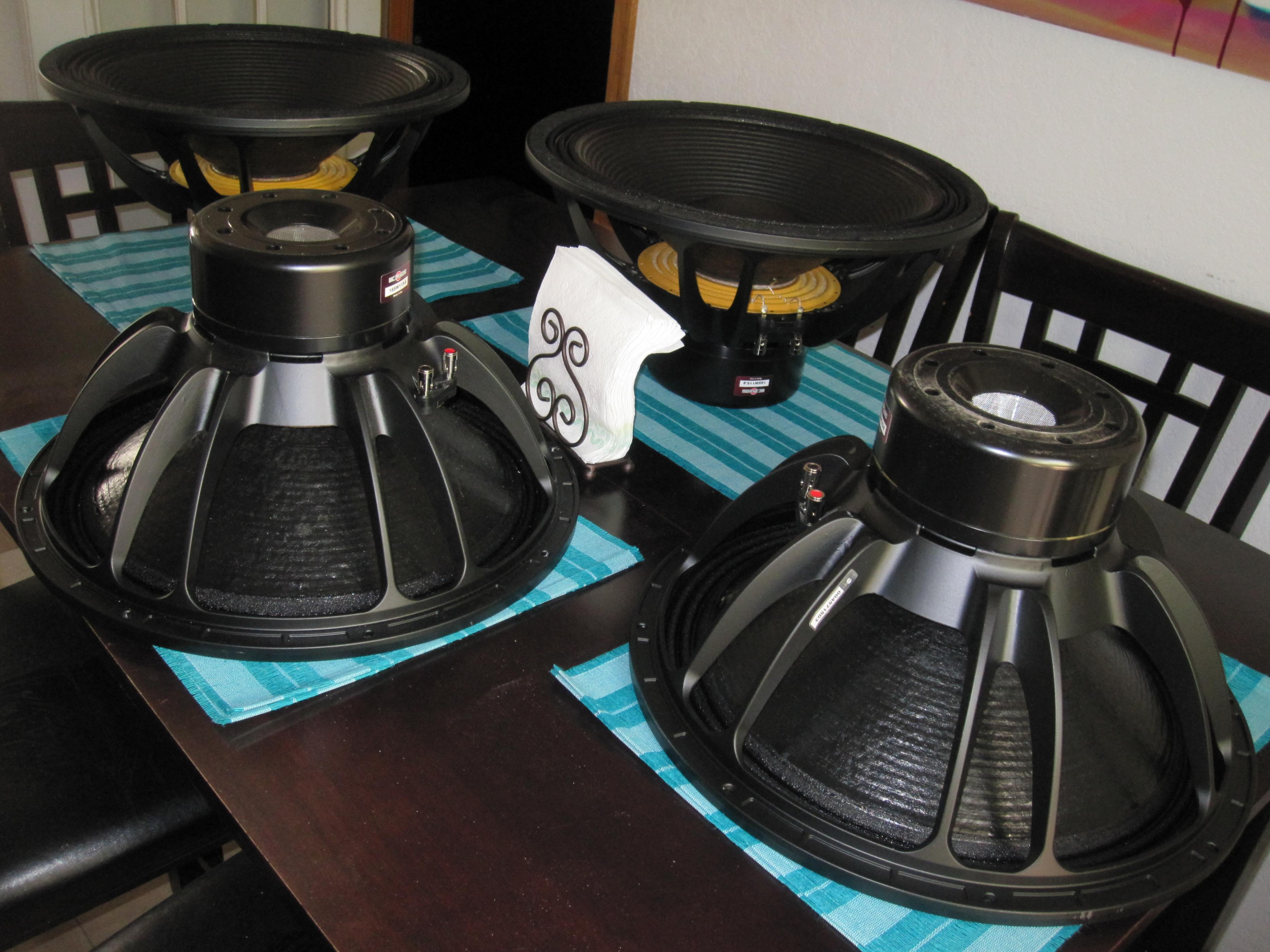

I have looked for availability of drivers and have found that 18 Sound 18NLW9000, 18NLW9601, Faital XL1800, XL1600, B&C 15SW115-8, among others are readily available. All are 8 ohm versions only. Price does vary quite a bit, but I don't mind going for the costliest which is 18 Sound 18NLW9000. I want to make a minimum of 4 cabs and a maximum of 6 cabs. Although I already have amps which can deliver a maximum of 1200 watts per channel, it would be best to have bridged amps delivering higher power into each cab. So I will go for new amps as well.
Question is, which driver from the ones listed, as well as not listed performs best. I am looking for solid response down to 30 Hz without losing impact in the 80-90 Hz region.
