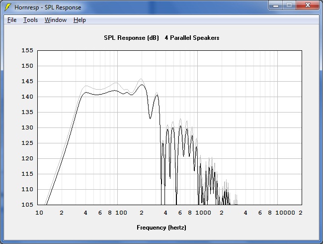

Here's a quick comparison of the 18Sound 18LW2400 and the B&C 18SW115 ($120 more from Parts Express).
B&C 18SW115:
AES = 1700
Xmax = 14 mm
BL = 30.3 Tm
Mms = 275 g
I don't have compression numbers for this driver, but maybe Djim and others can chime in on this drivers expected performance
B&C 18SW115:
AES = 1700
Xmax = 14 mm
BL = 30.3 Tm
Mms = 275 g
I wish it was that simple Crescendo... Just compare the motor/moving mass ratio against the excursion and HornResp doesn't show the costs in THD and pwr compression...

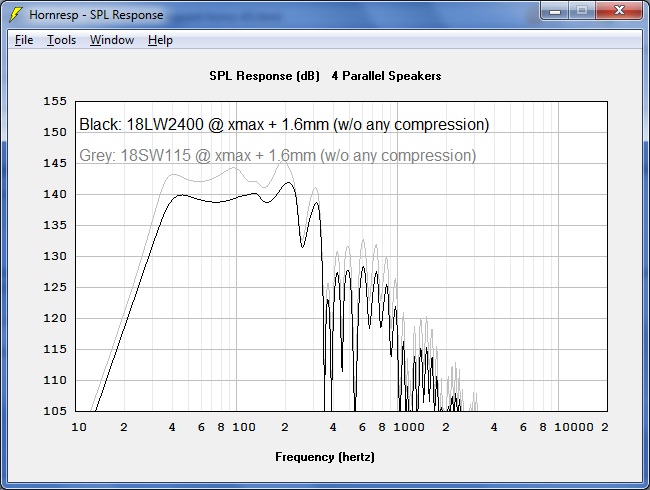

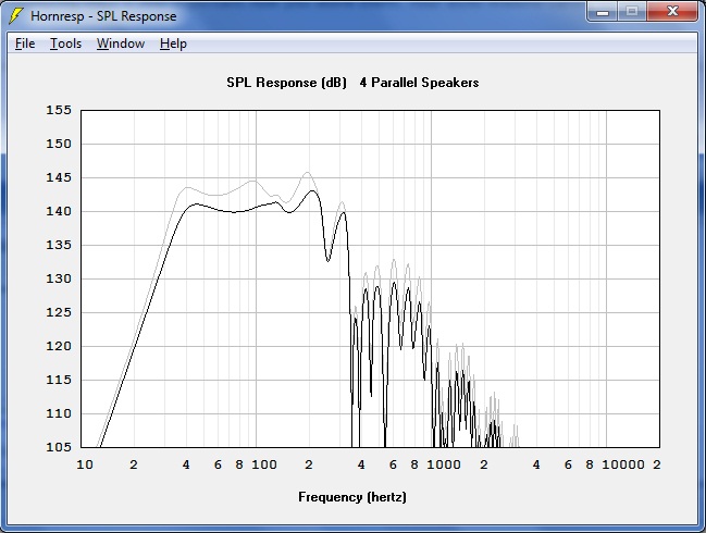

(4) 18LW2400 vs 18SW115 & LF18N451 @ MME
Before I get flame from Djim here are comparisons of the 18LW2400 up against the 18SW115 and LF18N451 @ MME (Max Efficient Excursion (BL50%)). I found this formula:
BL x 0,017) + 0,9 = BLc
BLc x Xmax = Max Efficient Excursion (BL50%)
Or:
[(BL x 0,017) + 0,9] x Xmax = Max Efficient Excursion (BL50%)
posted by Djim several pages back and was unaware of it's existence. If it has been revised, please share
The thing to keep in mind with these two HR plots (besides compression) is that the 18SW115 is at its AES limit while the 18Sound and RCF plots are well under theirs.
Grey lines are 18SW115. 18LW2400 is plot on the left; LF18N451 on the right.
What are your thoughts?
Lol............, the reason I was looking for such formula was because my earlier attempts with "Xlim -7dB for continue power" and "Xlim -4dB for max power", were accused of too much simplification and unrealistic. However, these formulas are still standing as a rock in my view. The other formula you are referring to you can forget. That was nothing more than an attempt to get around the other way which lead to a dead end actually.Before I get flame from Djim ............. [(BL x 0,017) + 0,9] x Xmax = Max Efficient Excursion (BL50%) ..........
In a world without power compression a balanced PA driver means it will reach its Xmax at its AES continues power in an optimised basreflex cab. At 2 x AES power it will reach its 50% BL. At 4 x its AES power it will reach Xlim (this point is also referred to as: AES continue power + 6dB or so called Crest factor).
So these formulas were only to prove my point for using AES power ratings for TH's just the same way you would use them for basreflex cabs (as long the Fb is above the Fs of the driver of course).
That means for your B&C it's 14mm Xmax should be theoretically reached at 1700 watts.
