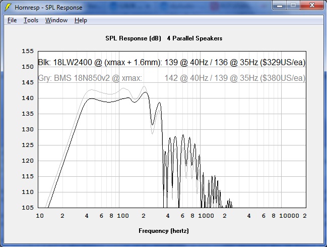

I wonder how the 18LW2400 driver would compare to the RCF LF18N451 in the real world. Note: Both drivers are at (xmax + 1.6mm) and are being modeled in Xoc1's TH18
They have almost similar overall max SPL’s when both used to their max power input. The 18 Sound pushes out about 1dB more then the RCF (in a 36Hz TH) throughout the bandpass except for < 45Hz. Under the 45Hz the RCF seems to have a little more output.
From an engineering point of view I would favour the 18Sound because it stays cooler (less power compression) under max load. If you compare motor to mass ratio they are very similar. Both use double spider suspension and only the 18Sound uses a double shortening ring system.
Soundwise most of my colleagues (me included) preferred the sound of the RCF but that’s personal. The RCF had a little less definition in the upper area but clearly sounded fuller in the lowest octave of the bandpass at max power. However the 18 Sound did sound less 'forced' at maximum power. But of course sound description is suggestive and very personal, I think.

Food for thought:
Anyone have power compression numbers for the BMS driver to see if it will even reach xmax with its power handling of 1200W? It barely reaches xmax in hornresp at its rated rms power, so I'm pretty sure it will be under xmax in the real world, in turn, less output than in hornresp.
I wish it was that simple Crescendo... Just compare the motor/moving mass ratio against the excursion and HornResp doesn't show the costs in THD and pwr compression...
BMS 18N850 V2:
AES = 1200 W
Xmax = 12 mm
BL = 25,4 Tm
Mms = 240 gram
18Sound 18LW2400:
AES = 1200 W
Xmax = 9,5 mm
BL = 25,6 Tm
Mms = 192 gram
RCF LF18N451:
AES = 1500 W
Xmax = 8,8 mm
BL = 30,2 Tm
Mms = 235 gram
You can see the extreme Xmax of the BMS that looks very tempting. But you also you can see it uses a similar motor compared to the 18Sound to move a cone that is even more heavy then the RCF cone! I'll bet that will result in more pwr compression...
So to me that means 80$ more for the BMS and plenty more to amplify the extra losses to get it at Xmax (if it doesn't burn before you get there...). Again, I repeat my statement that people look way to much to the Xmax and forget about the rest...

Djim, I was just using xmax as a benchmark, keeping other variables in mind. (i.e. IF I can get 'x' driver to reach xmax, spl will be 'xxx dB', etc). If there is a better way to directly compare drivers in a given enclosure (short of mounting and testing), please let me know. I would like to stay as accurate as possible.
