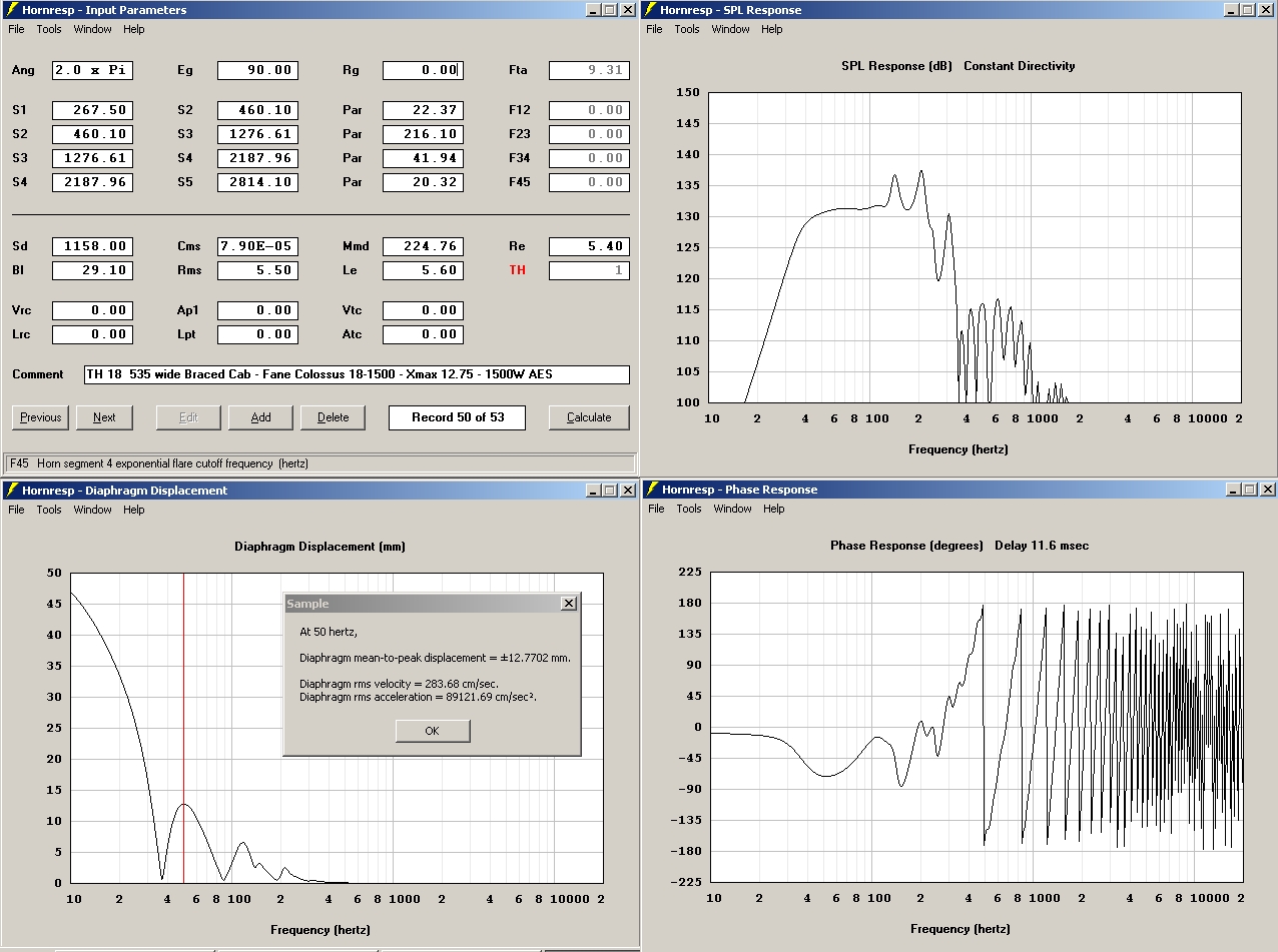

The distance from the baffle board to the inside of the base is about 300mm minimum. The distance from the bafflle board to the internal divider is 68mm minimum You could probably rework the baffle if you have tools that would fit within these dimensions and you like a challenge.🙂 My old B&D drill would fit for instance.
If you have a 18" driver in mind for a replacement then you could make an adaptor plate. If you use 18mm timber the dip at 120hz might be a bit deeper.
The dip at 120hz is also effected by the inductance of the driver. As the actual inductance is probably bigger at this frequency than the quoted inductance of the driver the frequency response is probably smoother than the sim.
Check out this UK made driver - the Fane 18-15000 - it has a high Le value.
I dont think most of us have an amp big enough to drive this to its limits.
90V for Xmax - without adding in the compression factor 😱
