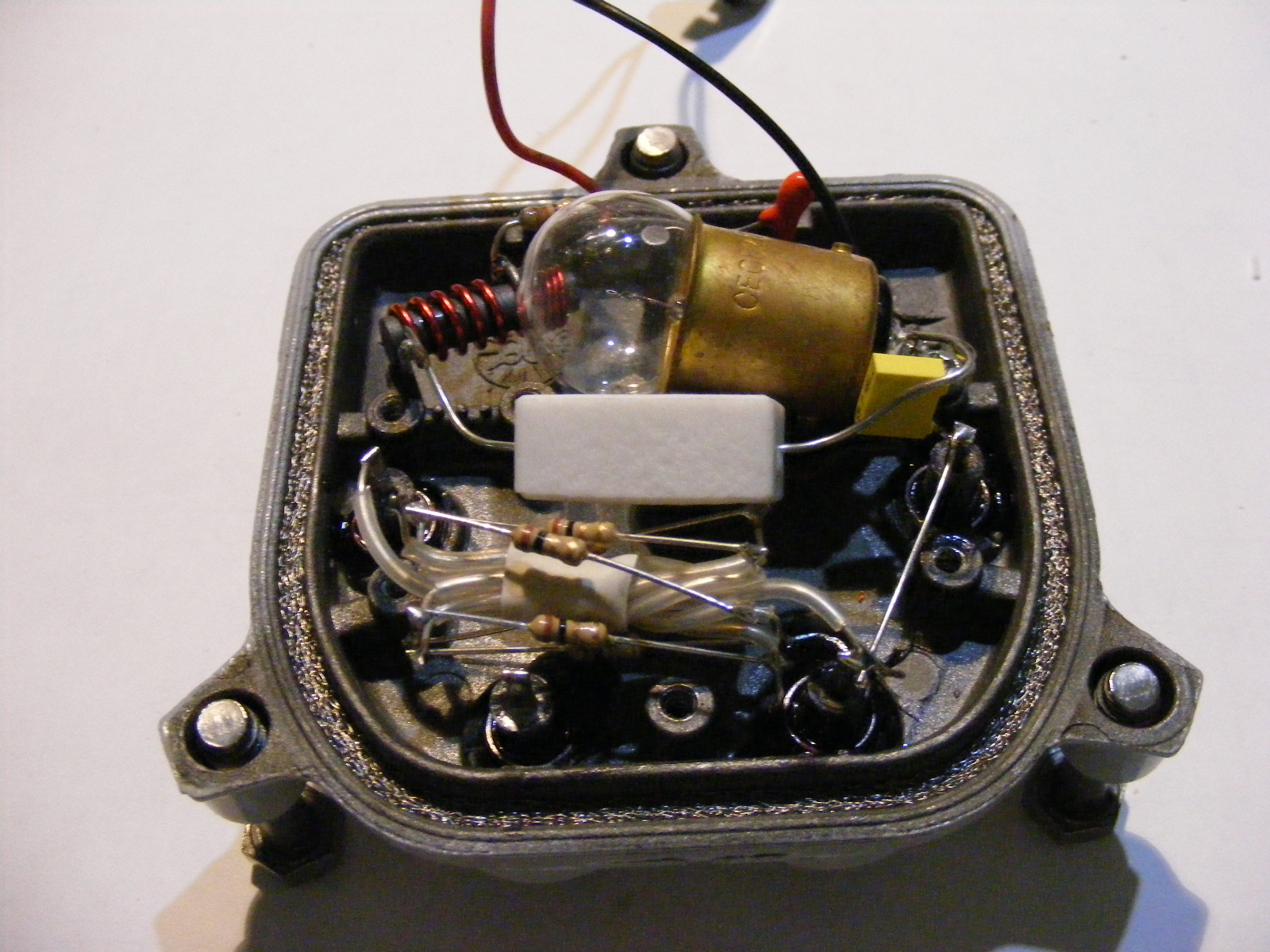

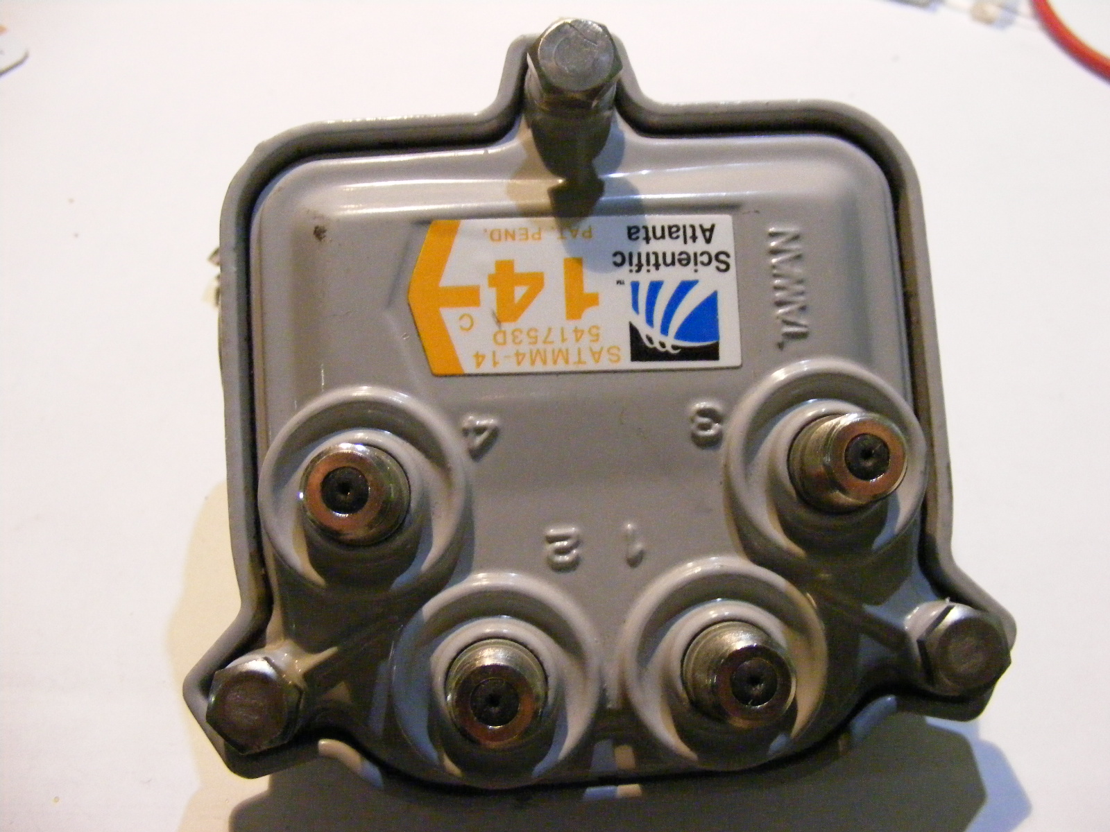

My prototype noise source and filter. First shot is outside sealed up to prevent EMI confusion, the second the insides!

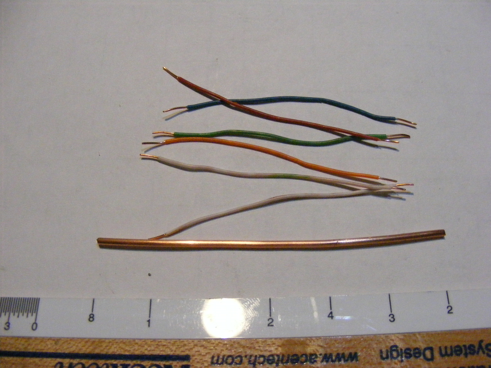

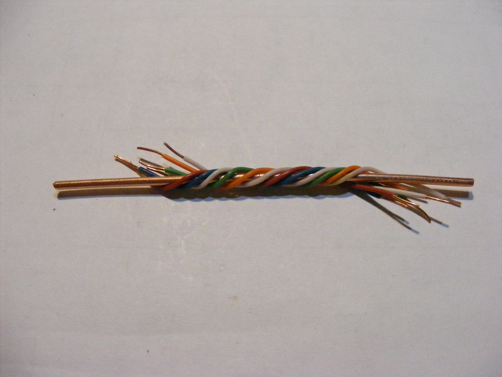

Now the starting point 7 wires 1 14 gauge the other 6 cat5 scraps. Wrap the six small wires two or three turns around the uninsulated thicker one. Note the direction of wind. Be sure they do not cross over each other. Secure them with a piece of 1/4" diameter heatshrink.

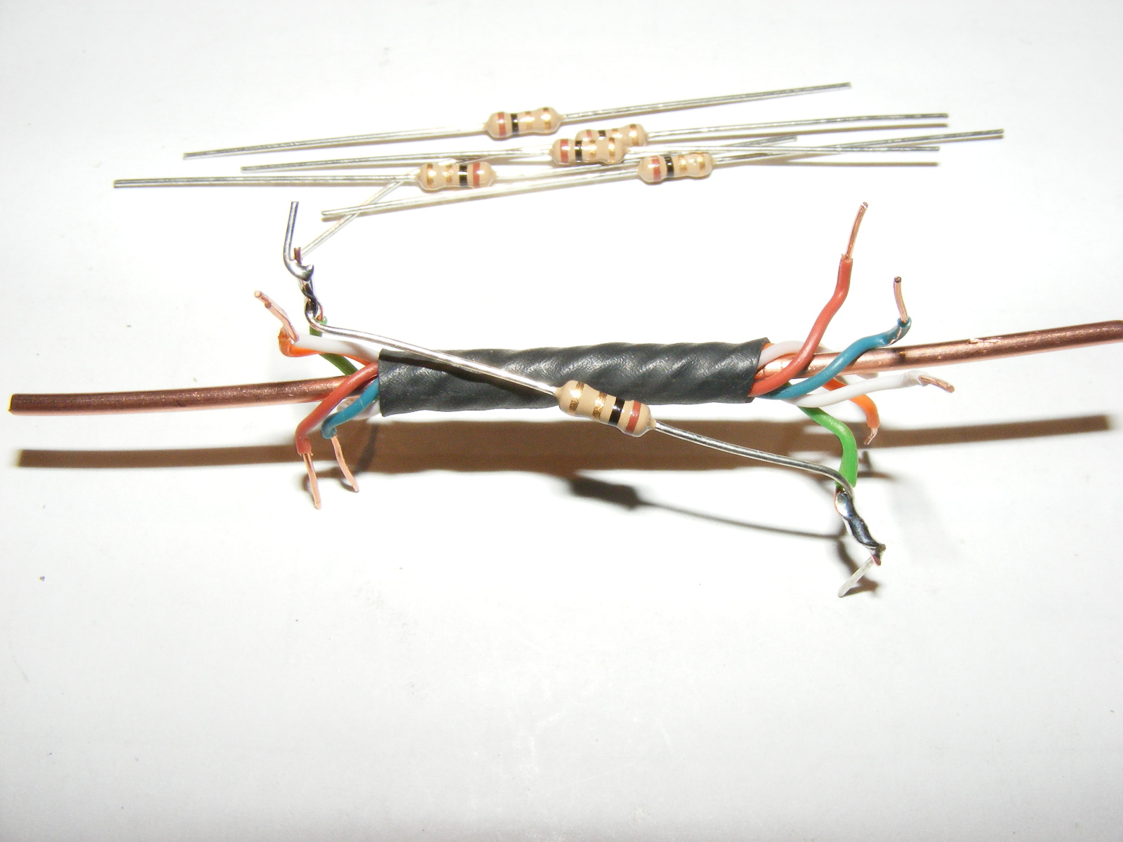

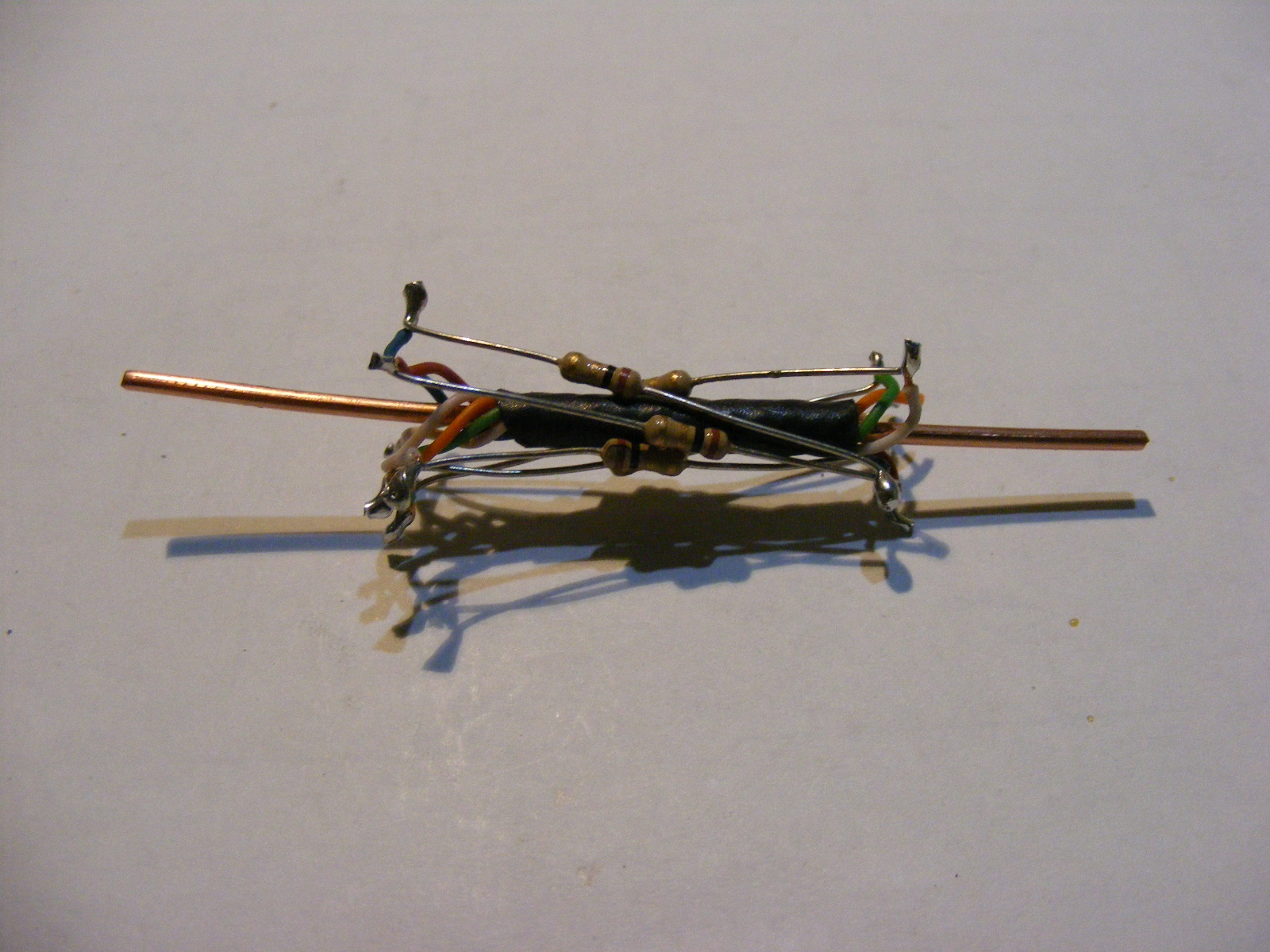

Now place a 1 ohm load resistor across each of the small wires. So in effect you have six secondary windings each loaded by it's own 1 ohm resistor. Do not place the resistors or their leads close to the center conductor.

Now why does this attenuate high frequency noise? What is the impedance at the frequencies we wish to pass unaltered? (Rhetorical questions no need to answer.)
Imagine the magnetic field that is generated by current within the 14 guage wire. Use the right hand rule.
Now, think of the wrapped wires as having a common centroid with the 14 guage wire.
The resistor completes a conductive loop which traps magnetic field.
Now, think about the current that can flow within the loop. It couples to the primary, it's voltage is proportional to the rate of change of the magnetic field caused by the current.
So what is it? The resistor sees current proportional to the rate of change of the field, so dissipation is hi-pass.
You've made a hi-pass filter. A convoluted one, but one nonetheless. And this hi-pass filter couples to a dissipative element. So, the overall effect is one of hi frequency attenuation.
Neat..
Boost the frequency up two orders of magnitude, change the wiring a tad, and voila...a directional coupler. I learned about those widgits back in '74.
Cheers, John
The dissipative element is the 6 x 1 ohm resistors.
