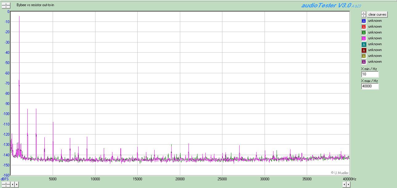

SY, could you please describe the test conditions and clarify what the two traces are recording ?.
Please elaborate.Nor did experiment support the implied increase in electron velocity (I'm rather proud of the hack I used to measure that!).

To measure any changes in electron velocity, I put the BQP in series with the cathode of a CRT in my Sekusui oscilloscope. If the devices really did violate first principles as claimed and could increase electron velocity, the trace would move from its no-BQP position. It didn't- rock steady with the device in or bypassed.
In that graph, the output of the soundcard was connected to the input via the BQP. 1kHz sine wave stimulus. 24 bit, 96k sample rate. In the other channel, the device connecting out to in was the reference resistor (a 50 cent current sensing resistor with the same DCR). No signal averaging. As you can see... no difference.

A differential test is required....
That said, by your description you are measuring two different signal paths, one with QP and one with reference resistor, so as I see it this is not a conclusive test....ie expect the two channels to not perfectly correlate ever and the plot is mostly a measure of channel differences.
Stuart, I am in no way attempting to discredit your work, I just feel that this test is flawed and please correct me if you feel otherwise.

What do you mean by moving ? Cro trace spreading horizontally or shifting vertically or what ?.To measure any changes in electron velocity, I put the BQP in series with the cathode of a CRT in my Sekusui oscilloscope. If the devices really did violate first principles as claimed and could increase electron velocity, the trace would move from its no-BQP position. It didn't- rock steady with the device in or bypassed.
When I zoom in on the plot there are many differences between the two traces.In that graph, the output of the soundcard was connected to the input via the BQP. 1kHz sine wave stimulus. 24 bit, 96k sample rate. In the other channel, the device connecting out to in was the reference resistor (a 50 cent current sensing resistor with the same DCR). No signal averaging. As you can see... no difference.
