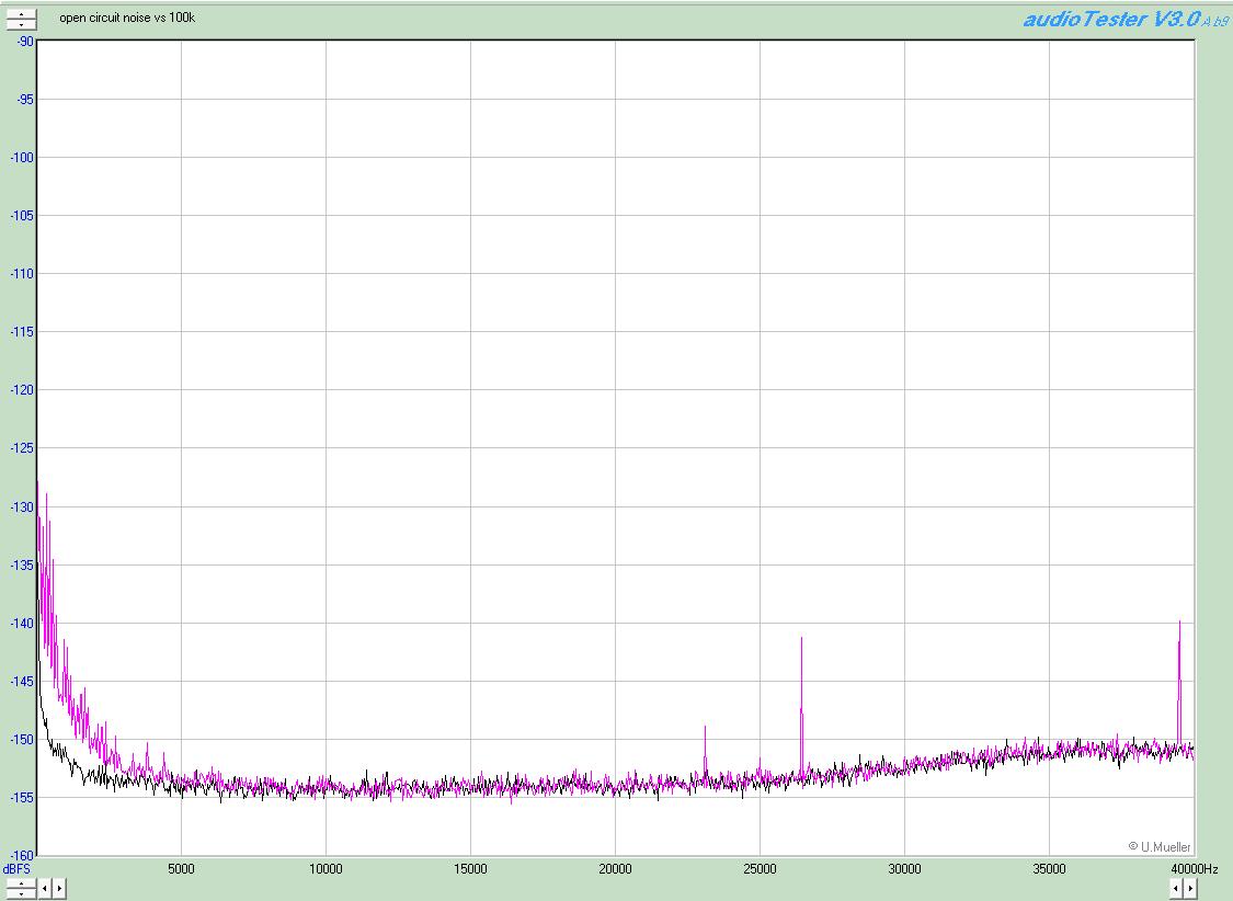

Pano, these are in response to Ed's question about the test system response with the input open-circuited. Noise with inputs shorted, shorted input vs open input, Bybee in series with 100k versus open input, shorted input versus shorted input. All in balanced connection, same Audiophile 192 card.

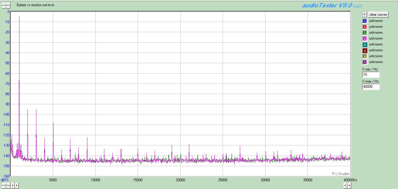

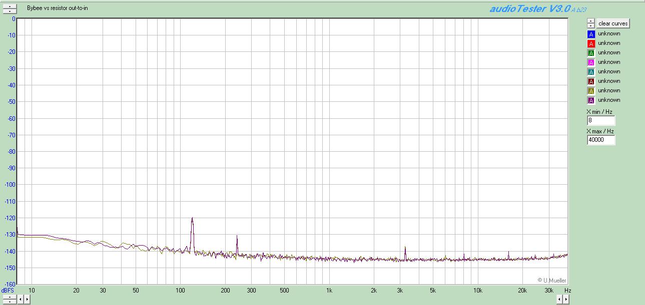

Now with the output turned on (sine wave). This is a single scan, no signal averaging. Little noise blips in one channel (green) were independent of whether the Bybee or the resistor was in that channel; that channel seems to pick up a little more noise from its surroundings albeit at minuscule levels.
