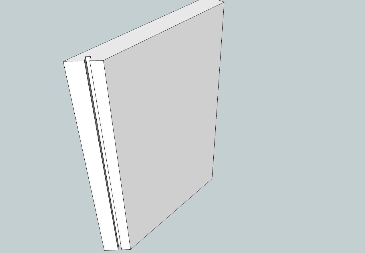

a spline the length of the miter keeps it aligned. Leave the blade angle set after you cut the miter. lower the blade and flip the piece. check your fence and cut the groove. My blade is 1/8" but if needed you can carefully adjust the fence to make a slot any thickness you wish. !/8" ply or pressboard makes a good spline.
Given your illustration, the spline would obviously be better but lacking CNC wouldn't that approach be impossible? <I like making things myself.>
P
As well, how much stronger <compared to performance> could the spline be verses biscuits? I guess you have the CNC people make the splines also?
My original point was I used biscuits and butt joints with good success in the beginning. CNC isnt a magical place where evertthing is perfect. Things still need to be fitted together and "worked". I wont lie...it is nice b]ut with it comes a brand new set of problems. Personally I wouldn't do a mittered edge...there is too much that can go wrong. I bite the bullet and get a dado set, some good pipe clamps and if budget allowed a pneumatic stapler. I have had way better results with staples than with brads.
