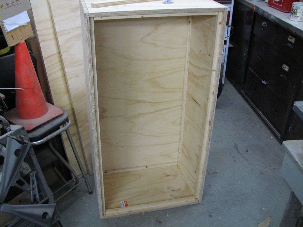

Hi Gareth,
Because the tape is applied while the pieces are face down, by the time you turn them over and roll them up, the tape is under a lot of tension creating a tight joint. The tape is the clamp(s). The small wood pieces in the 4th pic are there to hold it at the last joint and to help realign those little whoops'

These days my biscuit joiner is mostly gathering dust. For most of what I do, pocket screws done with my Kreg jig work better, are faster and are even reversible.
Doing a box with bar clamps takes a couple of people, for me anyway, and the slip factor just isn't worth taking the chance. Mitre clamps on the other hand remove the guess work and the heartache of something possibly going wrong. You can make them yourself if you have a few extra minutes and a little skill under your belt. I don't bother when the tape method works so well. 🙂No special clamps. Only bar clamps are needed if you have enough to do the full square at one time.. and a flat surface
