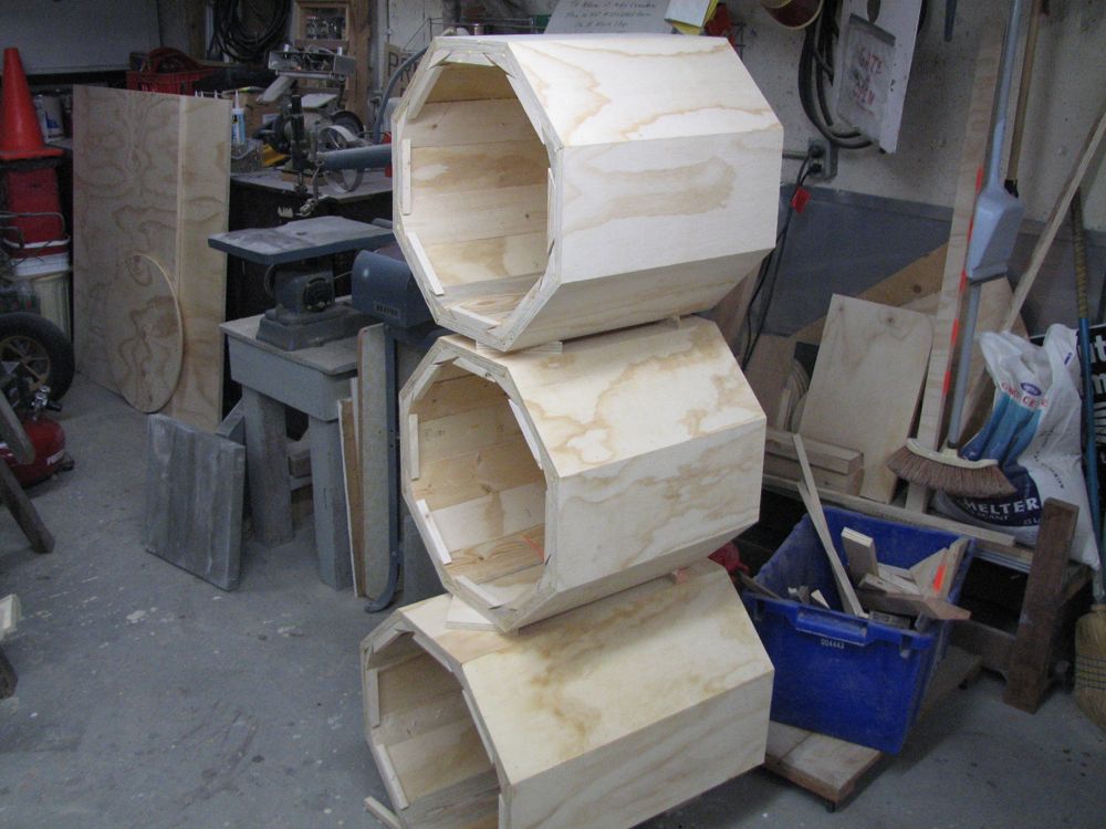

I am making some smaller 2 ways at the moment with marine ply, I want the ply to be the final exterior finish so no screws. I am going to use just a few biscuits and rely on but joints and some cleats. Nothing fancy, just softwood braces that will help me to align everything on glue day. Will use PVA glue, stuff is impermeable once set in my experience.

I think you'll find biscuits and cleats do similar things so you can probably drop one or the other. I can't think of why you might need both.

I suspect you are right Cal, thanks. In that case the cleats are preferable because they will be also add rigidity. On the other hand I have not spun up my biscuit joining thingy for a while so I might whip a few in for good measure 😉
I used screwed cleats (again to help align things) and butt joint screws and glue in my last sub project. It is ultra tuff!

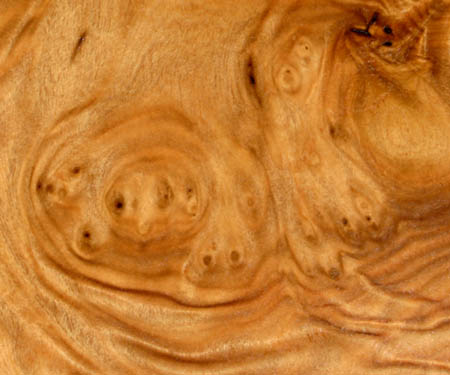

Attached is what I mean by "Figured" wood. And if you raise your own pine it would probably be better behaved.

Thanks for the pic. Figured wood looks a little like burl. What are you showing us?Cal,

Figured wood is what you call any wood with an interesting grain pattern. Nice for the visible wood on furniture, not so nice to keep trued up.
