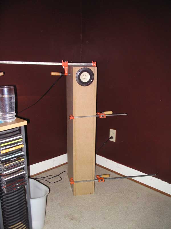

Phase One Complete

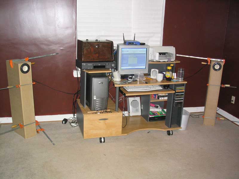

Well, I've completed Phase One of the Buschhorn project with the 108EZs and I have to say that I really like what I'm hearing. They like being in a corner and have responded well to a felted magnet and CAT 5 wiring (see photos).
Next, I'm going to stuf the top triangular void with sand / river rock and see if that tightens things up a bit in the bass department. However, I'd say that they sound great right now. The bass that comes out of these things is just incredible.
OK, you may have noticed that I'm using the PC as a sound source. This is true. I prefer the analog setup, but I just got a Soundblaster Audigy 4 with DTS / DVD-Audio / 24/96 support and I like the sound quite a bit. A little too "clean" and somewhat cold, as digital can be, but the range is nice and the soundstage is wonderful.
So don't mock me, man. Ill cut you.

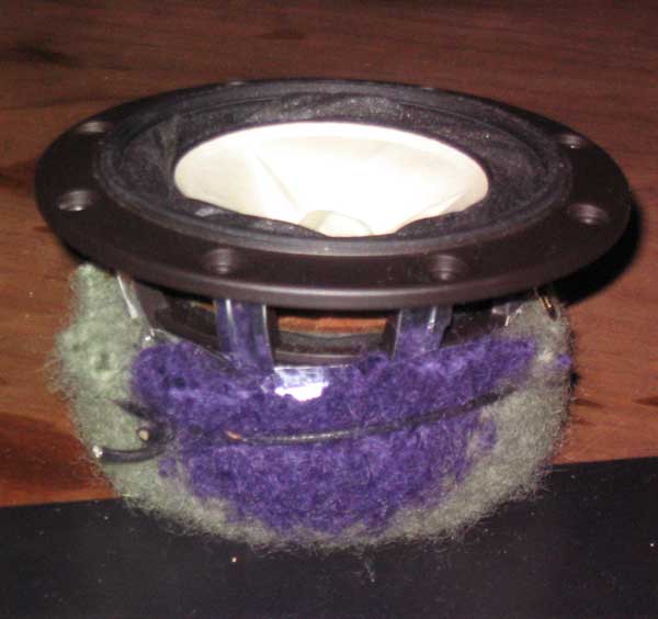

The felt for the magnet was contributed by Mrs. Annan. She was into "felting" for a while and I got a castaway for use on the 108EZ.
Anyway, I'll be tuning these today and hopefully sealing them up this afternoon. Let me know if you have any further advice on these. Again, thanks so much to everyone, particularly Dave and Ropie for working on this design and making it available to us all.

Can't speak for the 103s, but with the 108EZ, the Bushhorns win hands down. Its no contest. Most likely, this is because the compression chamber for the Swan was way too small for the 108EZ causing rump-shakin' bass when playing choir music. Of course, this worked great for the Our Lady of the Shakin' Rump Boys Choir CD I have, but otherwise it was an unwelcome accompaniment.
I never 'styrened the 206s, but given the success I had with felting the 108EZs, I think I'll try to felt the 206Es first. Then 'styrene, should it be required.

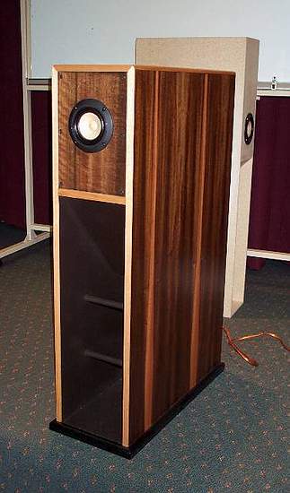

Don't kill the music
g'day, ooty boy
I may not be Oz, nor an expert like Ed Shilling, but I have participated in the construction and tweaking of a full-range speaker or two, and I would suggest that you rethink treating the enclosure with any type of "deadening" material or construction techniques. If the material that you've already cut is MDF, the box'll be dead enough as is
The Buschorns that I built (MKII) has some sand filling added to the void compartment below the last flare the horn mouth (as much for ballast as anything) and the large internal triangular void. After switching from vintage Foster F103alnicos to FE108ESigmas, I also made the upper portion of the front baffle removable- both to aid in fine tuning treatment of compression chamber, as well as swapping different drivers.
As for stuffing the chamber and lining the horn, that's pretty much a system dependant issue. Since it's a bit tricky to get at all the internal folds to play with that once the box is fully glued up, you might want to try temporarily attaching one panel with short, thin gauge screws until you've tuned it to your system. And don't forget that although some users are reporting instant Karma with NIB Fostex FE126E in a certain model of Horn, most full range drivers are likely to require quite a bit of break-in to fully assess the final performance. Don't rush to judgement until after at least 200-300hours of real playing time.
chris
g'day, ooty boy
chris

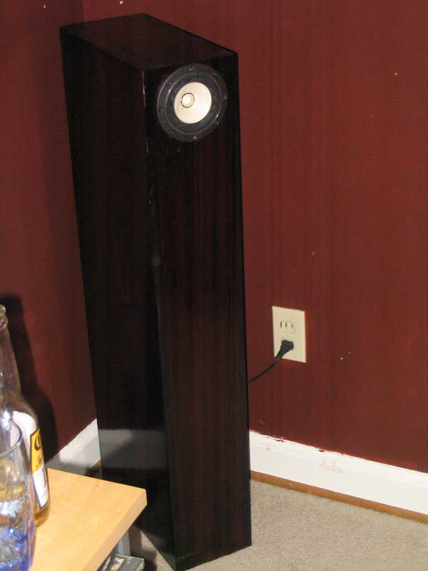

Kofi Annan said:Finish applied. Still got some room tuning to do as they sound a little boomy.
I'd expect them to be a bit boomy shoved that far into the corner... are they veneered or is the woodgrain a reflection of the wall off glossy black?
dave
I'll move them around a bit, but I think the bass seems more defined in the corner. It may be the scotch talkin' here.
Neither, daddy-o. I used a combo mahogany stain / poly and I think they look pretty good. The "grain" is really the brushstrokes and variations in color left by the stain.
Kofi
