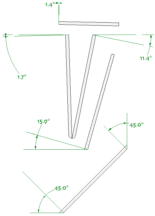

Kofi Annan said:How much should I increase the compression chamber to accommodate the 108EZ in the Buschhorn design? I was thinking that I would add an extended baffle on the driver to draw the basket out of the CC, thereby increasing the CC volume, but would this be enough?
Given that most are decreasing the compression chamber size for FE108eS, yes it will be bif enuff.

Should I be increasing or decreasing the size of the CC to accommodate the 108EZ in the Buschhorn design? I thought I had to increase it, but maybe not. Sorry for being so dense.
Kofi
In order to reach the same CC volume as the Fostex RecEnc you would have to shut the CC 6cm inwards; then you will have ˜1.55 litres, which is splendid for the little guy. Making it larger will make it sound "hollow" and give you phase problems. I have an even smaller CC, but it matches my room acoustics.

coredump said:In order to reach the same CC volume as the Fostex RecEnc you would have to shut the CC 6cm inwards; then you will have ˜1.55 litres, which is splendid for the little guy. Making it larger will make it sound "hollow" and give you phase problems. I have an even smaller CC, but it matches my room acoustics.
Be wary of making it too small. Chris & i tried the some found appropriate in earlier posts and found we prefered the original size... Bob scooped the B-Horns up before we had a chance to play with volumes in between. If you are going to muck with the CC, i'd be inclined more to change its ahape (more trianular) and easy access to be able to add "bricks" to play with its volume.

From the back of my head; did you take out the stuffing? AFAIK you tested a small CC with felt inside, etc. (that's what I gathered from Chris' posting then, I may be wrong though). I am advocating a (relatively) small CC with no stuffing at all, in order to give the driver an 'undistorted' impedance. My reasoning is: if the impedance is right for the driver, you don't need any stuffing. My Bicors have no stuffing in them, either, and (to my ears) they sound just dandy.
Of course I'm absolutely with you concerning CC shape, and I agree that a more modular approach would be better.
But I would strongly advise against trying to increase the CC (Kofi asked this), as one would have to re-design the horn somewhat. I'd rather create a wider baffle (following Ron's advice here), perhaps using disks to mount the drivers, as used by you-know-who with his Abbys.

OK-- got it. I'm too stupid to do the triangular CC, so I'm going to make it stat and add "bricks" as necessary.
Also, I wanted to make the angle cuts at the initial cut of the wood, so I started to use some trigonometry to divine the angles I'd need to cut. After remembering that I suck at triginometry, it dawned on me that someone would know the correct angles for the internal cuts. Anyone got these?
If not, should I just go the trial-and-error route and cut / file a little bit off at a time until the angle is right? Or should I go back to trig?

Your estimation "two sizes" suggests a better understanding of the triginomics associated with volumes than you're consciously aware of.
It was really more of a volume calculation... geometry.
Gotta love CAD....
Gotta love Dave! But not in a like-I-love-Mrs.-Annan way! You know what I mean! Thanks!
